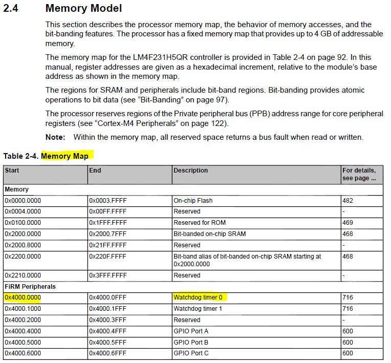

I am winding up in the FAULT_ISR with the NVIC_FAULT_ADDR pointing to 0x40040100 with a precise and valid address.  That address must be somewhere in ROM.  How do I find the ROM function that may be throwing this fault?
I will not be surprised if I am addressing a peripheral in a library of mine that has not been enabled.  I just need to find the peripheral to help find the location in code.  (In fact I found the root cause, but still want to know where to find the ROM functions.)

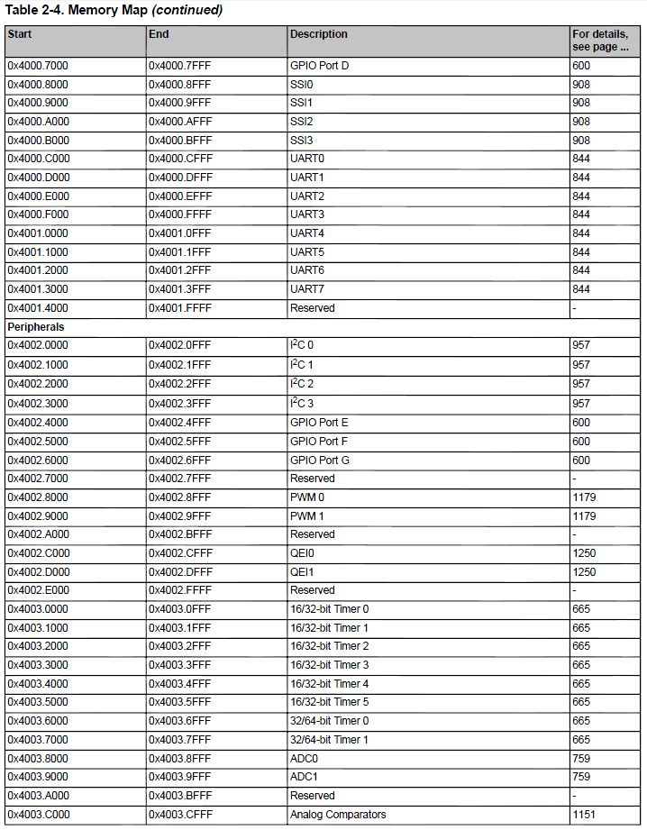

  • Suspect this comforts/illuminates:  (bit buried w/in MCU manual - pays to have been here awhile - "been there - done that."  This chart continues, multiple pages - but suspect this well answers your quest.  (and, has been awhile since green verify has landed - your brush-stroke - this reporter's effort...)   [something I've done/said?]
  • The address 0x40040100 is for CAN0 Instance. The usual suspects would be
    1. Peripheral Not Enabled or enabled and accessed without checking the Peripheral Ready Register Bit SYSCTL.PRCAN.CAN0

    By my read of your post - you seek to, "know where to find the ROM functions" - and only the first/answering post meets that specification.
    Later post identifies a particular peripheral - does a nice job w/"usual suspects" (wonder from where that sprang) - yet avoids any mention of, th"e memory model/memory map section - w/in MCU manual" - which precisely answered your request...
  • A pox apon me.  I had done a search on the very document for ROM, but found nothing.  I searched the ROM user's guide for the LM4F predecessor chip, but found nothing.  I guess I was not using the best search string to find the ROMed code.
    Thanks for placing my nose right where it needs to be.
