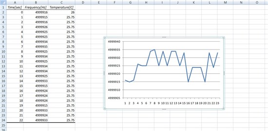

  • I modified the external timegate interrupt handler like this:
    void TimeGateIntHandler(void){
    	uint32_t status;
    	//ui32EventCount = TimerValueGet(CAPTURE_TIMER_BASE, TIMER_A);
    	ui32EventCount = WTIMER3_TAR_R;
    	//HWREG(CAPTURE_TIMER_BASE + TIMER_O_TAV) = 0;
    	WTIMER3_TAV_R = 0;
    	GPIOIntClear(TIMEGATE_PIN_BASE, TIMEGATE_PIN);
    	Task.Bits.FRQDRDY = 1;
    And my frequency readout has a random ~± 10Hz deviation (screenshot):
    Looks like a random interrupt latency?
    EDIT: Signal source had been changed to an internal, PWM generated 5 MHz signal.

  • I changed the time-gate source from external RTC to an internally generated 1 sec one and now the values are fine. It seems that the RTC chip's 1 Hz square wave output pin was causing the trouble, more investigation is needed. From this point  the issue is not TIVA related anymore so I'd close the topic.
