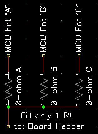

    At the risk of over-stepping (again) my outsider bounds - might the "selective fill" of 0-ohm jumpers - such that a "1 of n" connection routing becomes user enabled/selected - offer even more flexibility?  You can't fully predict all use-case implementations - but often you can provide for those, "most probable" - via this "1 of n" technique.  (we do this - several of our firm's boards - where "fine client/user/field tuning" is desired or necessary.)  There is a slight size penalty resulting from this 1 of n method - but our firm's experience is that "user flexibility" trumps slight size saving...
    Again thanks for the detail - rumor has it that some here suggest such... w/some frequency...
    For those interested - "1 of n" detail, (n=3, this instance).  Selective "fill" enhances user flexibility, no trace cutting required... Unselected MCU signals may be "escaped" to a header (on a different pin) or be captured via a jumper lead (inserted w/in thru-hole via) connected to & adjacent to each 0-ohm R. (and @ the MCU side)
