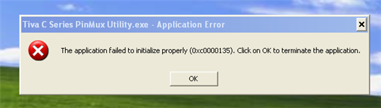

TIVAWARE don't run on my pc.
 Grace run fine everywhere but I am not able to have TIVA PINMUX utility run on any of my platform:
 XP 32 SP2 native on an AMD dual core (dell 1502 laptop)
Linux WINE (Ubuntu 12.x), (MINT 15) , XP SP2 run on virtualBox. on Dell AMD or Sony Intel I7 (vaio laptop)  same result.
 On wine I also set WIN7 but on all platform try run for a while then silently fail, where can i search for debugging or what can I do to try solve this issue?
  • This is a C# application and, as such, needs the Windows .NET framework installed. Looking around the web, the error you are seeing seems to be related to the necessary runtime being missing (see here, for example). I can imagine that this would be a problem for WINE but I expect you should be able to install the necessary code in a VM-hosted version of Windows.
     Thanks a lot Dave, this solved on windows VM hosted, on native XP is also solved installing framework 3.5.
     System requirement: Xp or newer, REQUIRE .NET framework!!!
     On wine I fear no solution can be applied, framework report cannot install on 64bit version, so reading some documentation I found it can work on mono, I installed debug, library for c# some other but no success for now.
     Try load then report an exception error I suppose can only solved by developer.
     I am just happy this level I can use utility to complex mapping of pin on TM4C129.
     Again THX!!
