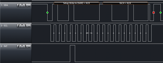

  • As first step, only for test that i can send touch events with software, i do this:
    i print on screen the values of g_sTouchX and g_sTouchY when i press some button and i get values arround 1300 for x and arround 1100 for y, so, y coded this into main loop:
    if (fl==200000) //fl is a counter (i use this to avoid delays).
    //intercept x value
    g_sTouchX=1300;
    //intercept y value
    g_sTouchY=1100;
    //call function that process x and y values
    TouchScreenDebouncer();
    //call function that process all framework
    WidgetMessageQueueProcess();
    ////Print values of x and y on the screen
    usprintf(buffer, "X:%4d, y:%4d", g_sTouchX, g_sTouchY);
    GrContextFontSet(&sContext, &g_sFontCmtt20); //g_sFontCmsc48 g_sFontCm48b g_sFontCmss48 g_sFontCmtt48 g_sFontFixed6x8
    GrContextForegroundSet(&sContext, ClrLime );
    GrStringDraw(&sContext, buffer, -1,5, 5, 5);
    fl=0;
    but this code not work at all.

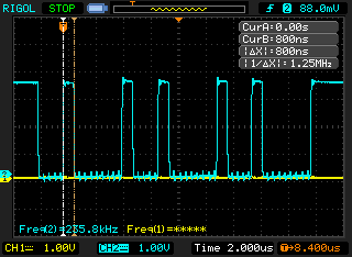

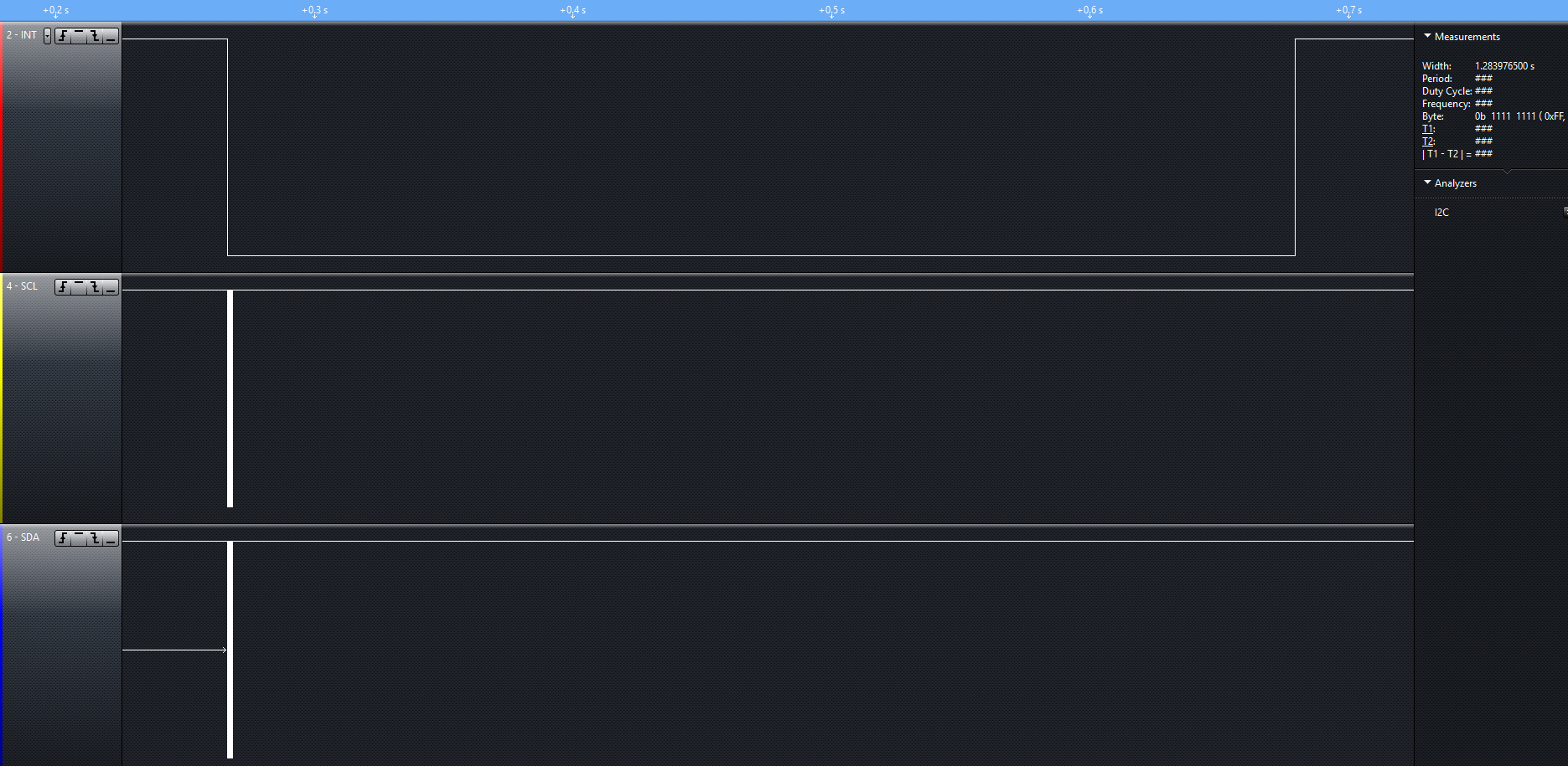

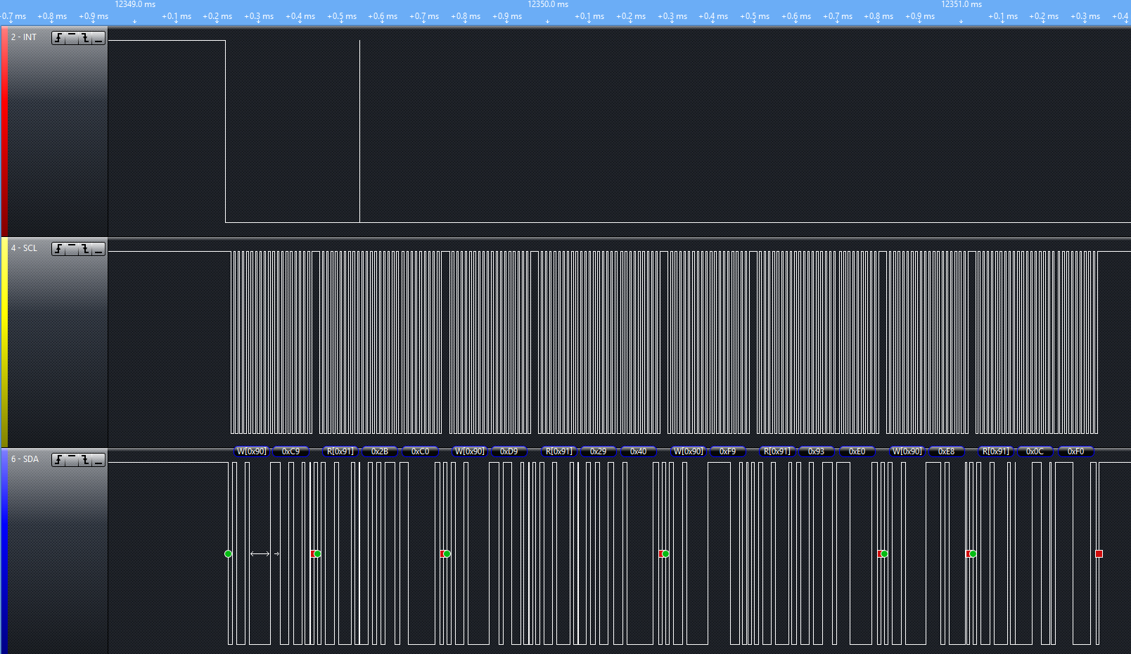

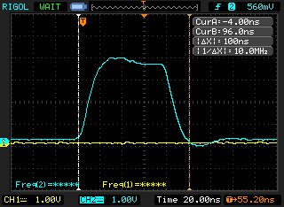

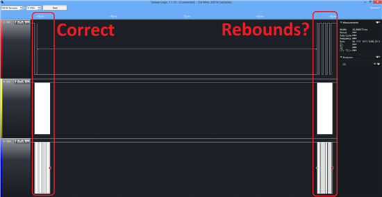

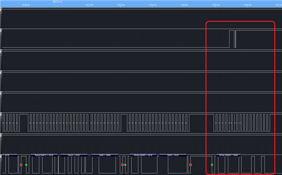

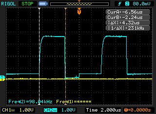

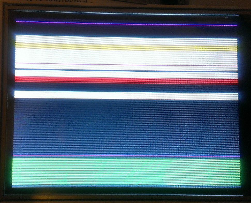

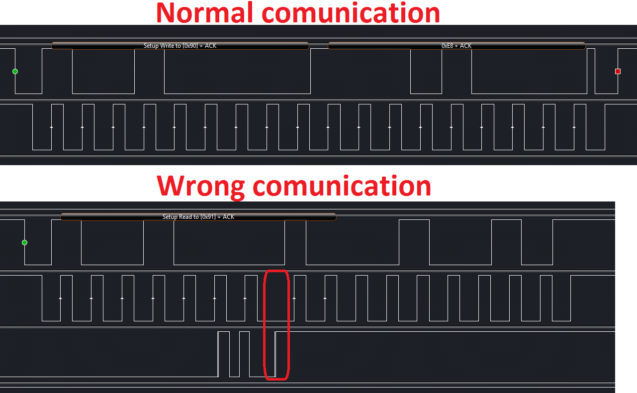

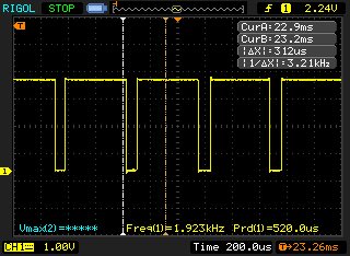

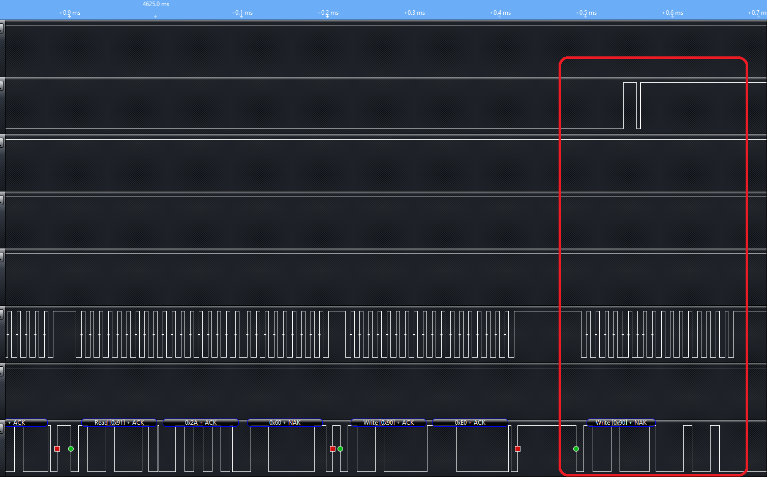

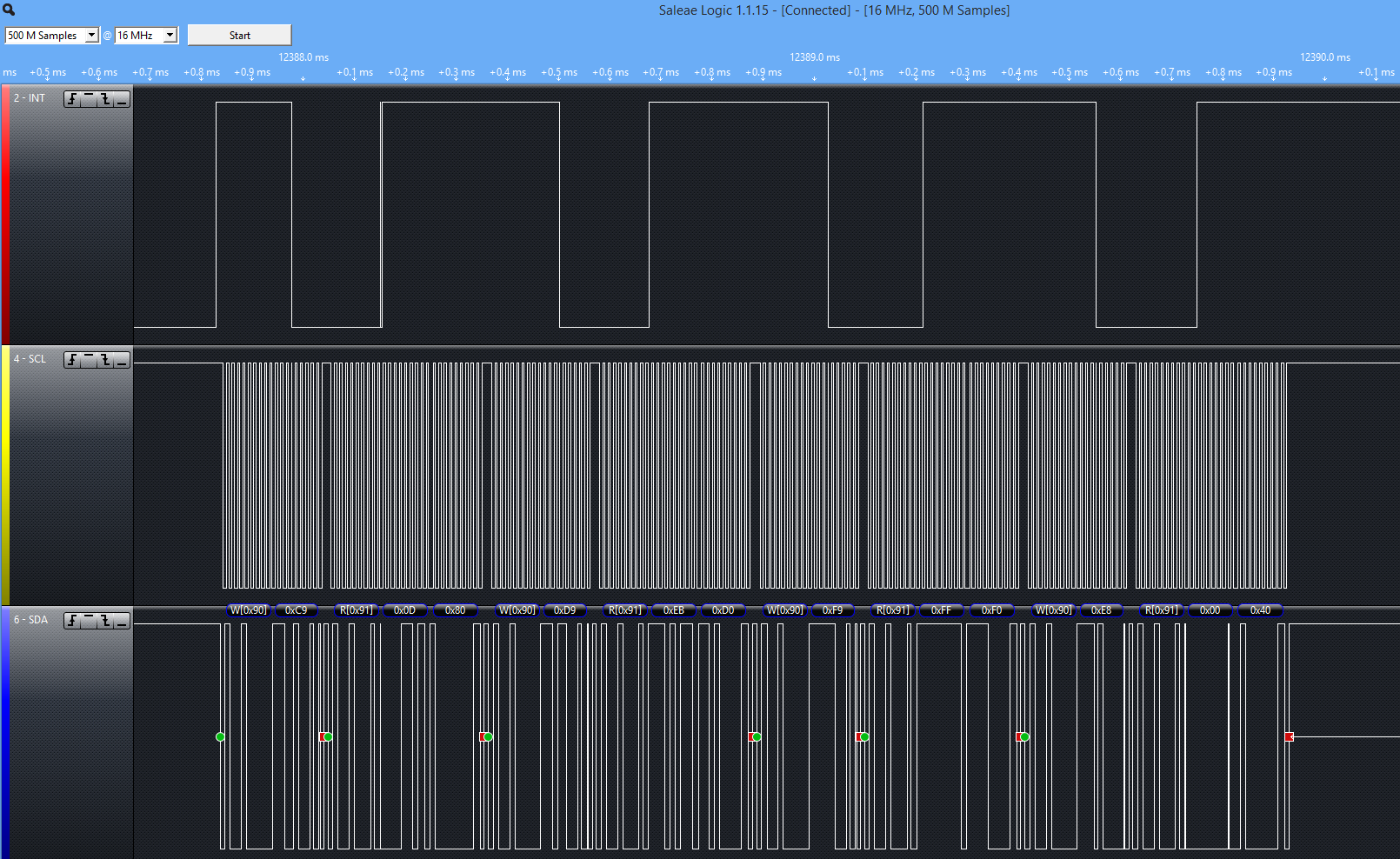

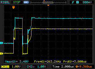

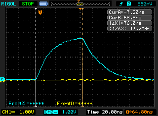

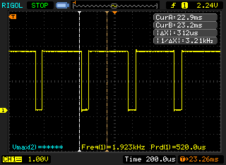

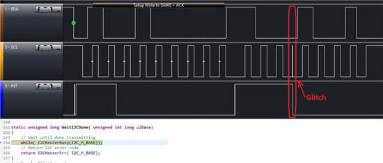

  • I am very close to get a driver, but now i have another problem... seems to be 4 pulses of 12khz on the INT pin. I disconnect it from stellaris and noise keeps. Also, i try with linear power supply instead of USB (to avoid supply noise) but nothing changes...

  • with the above code works but breaks when i sweep stylus on the screen so i do some testing:
    If I add this code,
    temp = GPIOPinIntStatus( GPIO_PORTE_BASE, true);
    GPIOPinIntClear(GPIO_PORTE_BASE, temp);
    MCU sends all time these I2C messages:
    cx2=ReceiveI2C_(0xC9);
    cx3=ReceiveI2C_(0xD9);
    cx4=ReceiveI2C_(0xF9);
    cx5=ReceiveI2C_(0xE8);
    I check with logic analyzer and MCU loops on: address, C9, receive some data, address, D9, receive some data, address, F9, receive some data, address, E8.
    If I put I2C requests inside following "If" clause, is the same outcome:

  • hm I note another thing:
    Interrupts on GPIOE are enabled with IntEnable(INT_GPIOE); and I2C pins are E4 and E5 (Interrupt pin is E0) so It is highly recommended to disable interrupts when IntHandler, but wont work...
  • i show one I2C transaction, i called each transaction "correct" and "rebound" (because have rebounds on interrupt pin):
    "Correct" zoom:
    "rebound" zoom:
    Both sequences are the same and send/receive correct data ( address, C9, receive some data, address, D9, receive some data, address, F9, receive some data, address, E8, receive some data) but "rebound" would not have to be. (also note that "rebound" interacts with interrupt in a peculiar way: after send write command occurs falling edge , and after read command occurs rising edge )
  • hello again,
    inside inthandler i have this if:
    if(GPIOPinIntStatus(GPIO_PORTE_BASE, false)&(GPIO_PIN_0))
    ...send/receive i2c code..
    and works like another image, with two sequences: "correct" and "rebound".
    if i put if(1), has no "correct", every time is "rebound", every time runs interruption, even when i have not touched the screen anytime.
    So, i think if(GPIOPinIntStatus(GPIO_PORTE_BASE, false)&(GPIO_PIN_0)) is neccessary, but the interruption would not have to run all the time like now. I force I2C interruptions to disable with IntDisable(INT_I2C2); but nothing changes...
    therefore, must be one of these things:
    - Stellaris launch interrupt because i dont know why.
    -TSC2007 causes interrupt because internal architecture.
    I try almost everything modes described on datasheet and nothing changes. (some modes disables interrupt pin, but all modes with interrupt active works launching falling edge each write sequence.
    As I can understand, TSC2007 modes allways launch interrupt (forced low INT pin) so maybe "correct" sequence has no interrupt edges because INT pin is attached to touch panel and forced low when pressed (int edges trying to appear but forced low).
    So: the main problem is why MCU not mask interrupts on interrupt function (MCU do interrupt function, but at finish do again the same interrupt function, maybe because he has kept the interrupt request caused during the function).

  • woh, how many work!
    I have new findings:
    Now, touch works almost perfect, except when I2C breaks (SDA comes low level and stay here... It ocurrs when quick speed interrupt (rebounds with stylus) i think). I attach one image:
    Interrupt ocurrs only when i press screen (both edges). Then, if E0 is LOW, MCU send 4x I2C messages:
    -Measure X  (1100)+Enable A/D & Disable INT(01)+12bit mode(0)+dont care(0) =C4
    -Measure Y  (1101)+Enable A/D & Disable INT(01)+12bit mode(0)+dont care(0) =D4
    -Measure Z1 (1110)+Enable A/D & Disable INT(01)+12bit mode(0)+dont care(0) =F4
    -Measure Z2 (1111)+LowPower & Enable INT(00)+12bit mode(0)+dont care(0) =E0
    And later send WidgetPointerMessage(WIDGET_MSG_PTR_DOWN, lx, ly);
    If E0 is HIGH send WidgetPointerMessage(WIDGET_MSG_PTR_UP , lx, ly); (with coordenates from latest measures, not new ones because measures when remove stylus are wrong).
    Now i clear interrupt: GPIOPinIntClear(GPIO_PORTE_BASE, GPIO_PIN_0);
    I have attended to what Dave said, but if i put GPIOPinIntClear before send I2C messages, write to touch driver causes to edge INT pin, so interrupt is set after cleared and later when i enable interrupts, interrupt is called again.

    Now, i have another problem (never ends...): Touch driver causes interrupt by direct LCD touch so waveform has rebounds, mainly at the end. MCU send I2C messages after edge but problems start when there is some rising edge rebound (rising and falling) that causes another I2C message and it dont finish before next rebound.
    I put GPIOPinIntDisable(GPIO_PORTE_BASE, GPIO_PIN_0); and GPIOPinIntEnable(GPIO_PORTE_BASE, GPIO_PIN_0); between interrupt code (also I2C send/receive code), but i think it dont work. i need to do any more to disable interrupts or there is some circumstance that overrides disable request? i include "driverlib/interrupt.h", "driverlib/gpio.h", "inc/hw_ints.h", "inc/hw_gpio.h" and some more.

    Check the image: I2C works, but at the end there is some rebound, so as in the begin of the interrupt, MCU writes to address 0x90. This byte is sucessfully send, but then is needed to send command byte and concur with rebound, so send incorrect data. Maybe i should put some capacitor to attempt to avoid rebounds, but first i like to know if there is some software way. For example, delay at the beginning of the interrupt forces to whait some time and later checks if pin stays low. If not, there is a rebound so I can obviate them.
  • If you want to be sure that you don't get interrupts from GPIO Port E, pin 0, GPIOPinIntDisable(GPIO_PORTE_BASE, GPIO_PIN_0) is the right thing to do. If other pin interrupts on Port E are still enabled, you'll still get calls to the Port E interrupt handler but GPIOPinIntStatus() will show you which pins interrupted and pin 0 won't be one of them.
    The problem here seems to me that you need to debounce the GPIO signal. There are various ways to do this but I would likely start by using a timer to reenable the GPIO interrupt after some period of time. When you get an interrupt, disable the pin interrupt and process it as normal. When you've finished, start the timer. When the timer interrupts, re-enable the GPIO interrupt again. The timer period will have to be determined by the maximum frequency you want to process touch messages (perhaps 100 a second or so?) and also the time period during which you are seeing bounces on the GPIO line (which you should be able to determine using your logic analyzer).
    There are other ways to debounce the signal involving reading it multiple times and only acting when you've read it in the same state a certain number of times. I think we even do something like this in the existing resistive touch panel drivers. They will all likely involve timers and interrupts, though, so I would start with the simple approach I outlined and see if that works. Perhaps other readers can offer better suggestions?

    I attach a image of one glitch:

  • About I2C glitch:
    Sometimes when coincides falling edge of interrupt and I2C comunication, SDA  makes a pulse. This corrupts the communication and MCU remains on "while( I2CMasterBusy(I2C_M_BASE));".
    I try to solve this with another timer more or something.
    You think this is hardware problem (because I use poor wiring with normal dupont cables with this alignment: INT, SCL, SDA, GND. Maybe It would be better if I transport INT into a separated cable twisted with GND) or could be any software problem?.
  • Hi Daniel,
    If the issue is really of a glitch on the I2C Line due INT rebounce, then you can the glitch filter on I2C to weed out smaller runt pulses.
    I am not sure which device you are using. TM4C123 or TM4C129, so would put the data for both
    1. TM4C123: I2CMCR2.GFPW register.bit-field for selecting the glitch pulse width to filter out and I2CMCR.GFE register.bit-field to enable the feature.
    2. TM4C129: I2CMTPR.PULSEL for selecting and enabling the glitch pulse width.
    The glitch filter is in terms of system clock. Hence if the system clock is say 40MHz (25ns), and the filter width is set to 1 clock then a glitch of up to 25ns will be filtered out. Do make sure that the Pulse Width setting is not so large that the SCL or SDA valid pulse is filtered.
    Secondly, if you are running free wiring, then cross talk can be a problem. Ground Shielding would be useful.
    Thirdly, looking at the waveform, the Setup Write has 9 SCL pulses, but the next I2C transaction has 8 (including the glitch) SCL pulses. This is strange as it is a Master Write, the I2C should have generated 9 SCL pulses (8 for data and 1 for ACK/NACK)

    The last problem you said, I am thinking is because INT pin. Would have to be a clock pulse when INT goes high (after 9 pulse), but there isn't, SCL remains low.
    I attach a picture to show this. In this picture there isn't any glitch, but lack a pulse after 7 SCLK pulse, when INT goes high.
    Im trying to do watchdog like for I2C with one timer to force retrasmission of the data if sda remains low (attempting to receive something)).
    MCU keeps working but without I2C. How i can restart I2C? I try with the same configure commands but seems to send nothing, I2C is break.

  • I changed I2C pull up resistors to 1K (3'3mA) and, at the moment, seems to work perfect without rebounds.
    What resistor values you recomend? maybe 3'3mA per wire is too high (6'6mA...), what you think?
    Check 7.1 point of I2C specification article: http://www.nxp.com/documents/user_manual/UM10204.pdf and recommends even lower vaules, but maybe dont consider "low power"/portable devices for this. Also, maybe newer chips and microcontrollers are capable to work with higher values than shown in the specification.
    I'm trying to find wrong I2C data but at the moment there isn't.
    This is one good I2C data transmission, when one INT pulse:
    I'm going to oscilloscope to check the aspect of the signals.

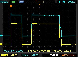

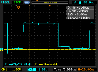

    I have some waveforms to show!
    This is SCL now, seems to be some little offset but works.
    This is SDA:
    This is CS from LCD bus:
    This is CLK from LCD bus:
    As you see, CLK is pretty bad. So I check code configuration and I change
    GPIOPadConfigSet(GPIO_PORTC_BASE,GPIO_PIN_4|GPIO_PIN_5|GPIO_PIN_6|GPIO_PIN_7, GPIO_STRENGTH_2MA,GPIO_PIN_TYPE_STD);
    for:
    GPIOPadConfigSet(GPIO_PORTC_BASE,GPIO_PIN_4|GPIO_PIN_5|GPIO_PIN_6|GPIO_PIN_7, GPIO_STRENGTH_8MA_SC,GPIO_PIN_TYPE_STD);
    and this is my new waveform:

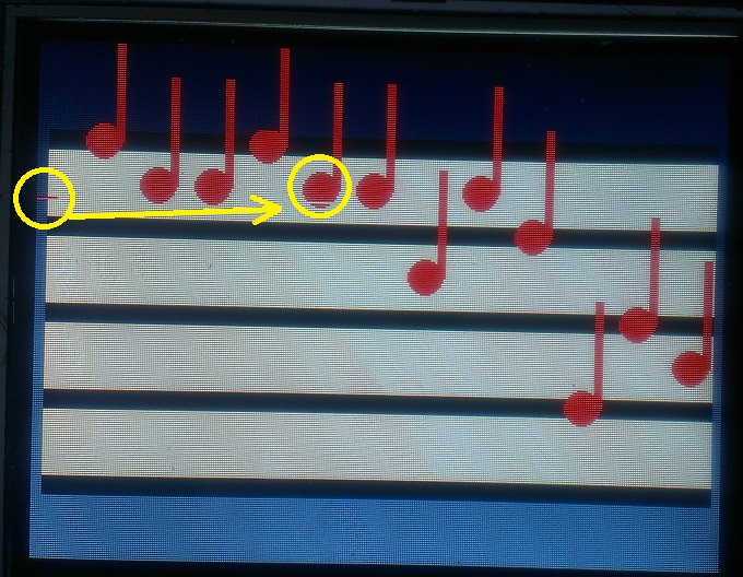

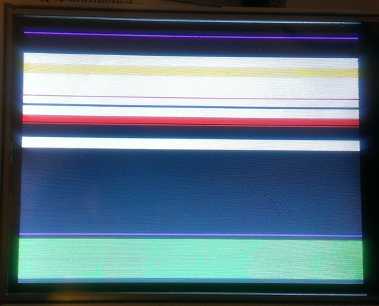

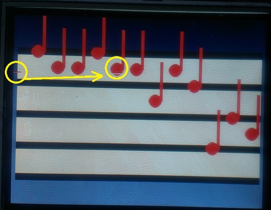

    Maybe this solves some problems but the LCD still receiving erroneous commands (rarely, but sometime).
    This is normal screen:
    and this is screen after bad commands (only happens (rarely) when I touch the screen (and draw). I'm not sure if it is after a time or is totally random):
  • Hi Daniel,
    SCL and SDA for higher Pull Up Resistor will always follow the "Shark-Fin" pattern. You can increase the Pull Up strength to the point the INT foes not cause clock to be missing or clipped.
    Good to hear that the I2C is now working. It could be possible that the TSC2007 may be causing the runt pulses to appear. It would be a good forum post for TSC2007 to answer that if you do want to know why this would be the case.
