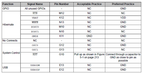

As I understand it, the XOSC0 and XOSC1 pins are only used for the Hibernation model. I am not using that so I am wondering what to do with the pins. I am guessing that I should ground XOSC0 and leave XOSC1 unconnected. Also, does the GNDX pin need to be connected?
The data sheet or the Design Guide does not cover this scenario.
