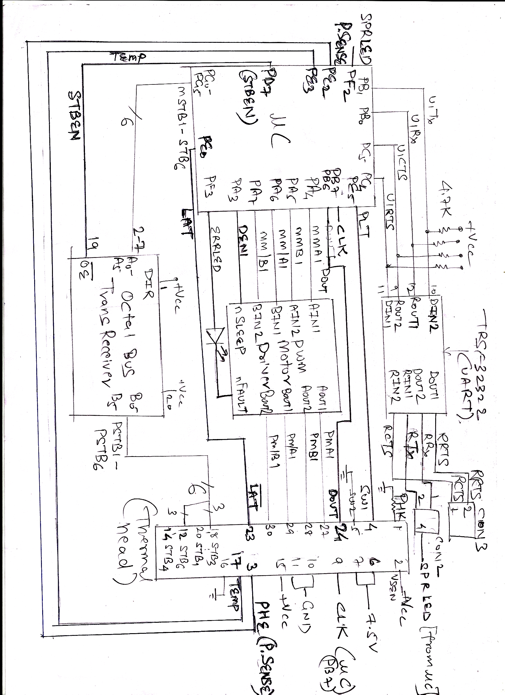

  • I am using Fujitsu FTP628MCL 101/103 Thermal printer (width 2") which is interfaced with TM4C123FH6PM .
    Pl refer my interfacing diagramPort pin connections from uC to motor driver & thermal head,etc
    where I have used PB6 of microcontroller to send data in serial form to printer head(pin no:24). I have  used 6 Strobe (STB0-STB5)signals for thermal head energizing control refer datasheet. 7178.PRINTER DRIVER.pdf. 4 pins for pwm motor control (DRV 8833)(PMA1,PMB1,PM/A1,PM/B1 of above diagram) Refer datasheet6215.drv8833.pdf page 9 of this DS, I have used in forward direction.
    Pl help how to develop thermal header file(.h) for above problem.
    At this stage, you changed the problem - if its was the same from the beginning, then was mis-stated - so you need to realize an interface board to only the print head? If yes, why, since there already is an interface board ready to be connected to the printer head:  http://www.manualsdir.com/manuals/105198/fujitsu-ftp-608-series.html?download
    Strongly suggest to use such ready board and concentrate only on the high level driver. If your job is to do such interface board, then the documentation available is not enough - six pages with connector description could not supply info about motor, software for that and for thermal head. Contact Fujitsu for such info. Timing diagrams and protocols are essential for such job.

    Could you please help me with motor configurations of IC drv8837(PWM driver motor IC) with microcontroller TM4C123FH6PM interfaced to PORT A4 to A7 i.e header file . Motor is to be running in forward direction with fast decay.
    I will be using dc motor of print head(fujitsu628MCL101 series) which is interfaced via IC drv8837 to microcontroller as above.
    For pwm: motor duration should be around 3-5sec.Initially i just want to see timing graph on oscilloscope from output of driver Ic drv8837 (datasheet of this is in previous post). But I cannot change the interface board now due to some constraints i.e. I have to use TM4C123 uC with fujitsu thermal head(FTP628MCL101). So please help me with these.
