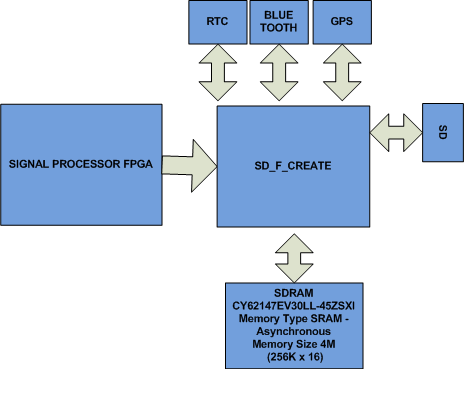

Hi, i'm with a problem in my project with RAM memory.
Then I will explain:
I'm finish a power quality device in my P.h.D, and this device work with 2 processors, one FOGA ( Signal Processing) and ARM (TIVA ) work with manager of system. In my case ARM run GPS/ BLUETOOTH/ RTC (TXCO) AND SDCARD. The communication between FPGA and ARM is executed by SPI bus.
In my prototipe I'm using Stellaris Launchpad, but my problem happen when I need open a new file on SD. During this time ( 2 seconds) I cant buffer(2Mbytes ) that arrive of FPGA. After search about dual port FIFO and other chip to solve this problem, I found TM4C129DNCPDT that can work with external SDRAM/SRAM memory. I would like to receive suggestion about what SDRAM chip that I can put in my board and I will open my files Gerber and software about work this .
Anyone can help me choise a good chip that can work in this situation.

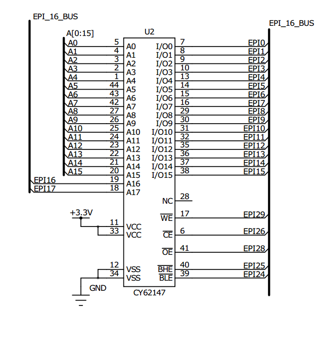

  • Hi, friends after search on internet details about SDRAM/SRAM on TIVA, a found some important details, I will post all my search in this forum, to provide suport to new designer .
    Then after verify a Big datasheet of TIVA ( link below ) I found  the follow informations
    Datasheet : http://www.ti.com/lit/ds/symlink/tm4c129dncpdt.pdf
    Verify page:837 in this page have schematic ( Diagram block ) of EPI Example Schematic for Muxed Host-Bus 16 Mode . Then I believe that this schematic can be used to build my application, but in my case I will use only SRAM. The SRAM of schematic is CY62147EV30LL-45ZSXI (http://www.digikey.com/product-detail/en/CY62147EV30LL-45ZSXI/428-2073-ND/1205253) and this memory is a low cost memory .
    I would like to receive suggestion and confirmation with this hardware is right in 3 days I will post complete schematic with final circuit.

  • @ Carlos,
    While you're making good progress - please do not let, "low cost" over-shadow other, important issues.
    Often memory devices which are, "low cost" suffer slow access times & are unlikely to be, "best-brightest."  It is your responsibility to comb thru data sheets (both your MCU in this external memory's "timing" regard) and multiple, candidate memory devices - to insure, "safety margins" exist over lot, temperature & operating voltage.  (memory vendors' sites likely further detail...)
    Perhaps better to initially, "over-specify" a device (to insure it will work) and then later see if the spec can be, "relaxed," via employ of a, "lower cost" device...
