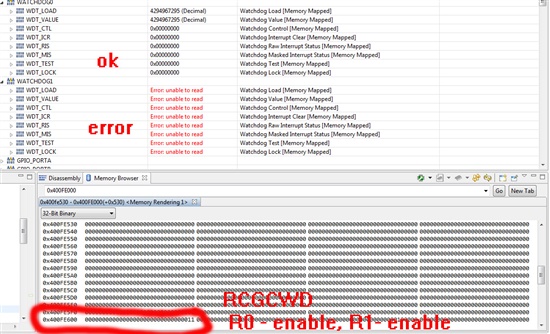

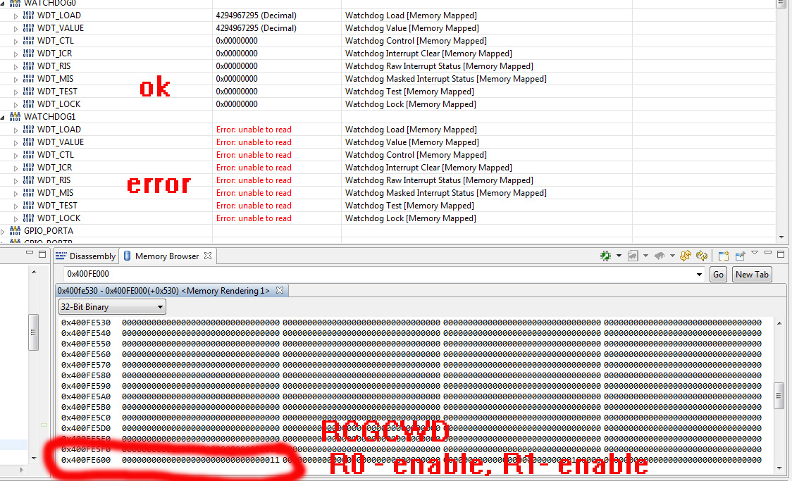

I learn the basic configuration of  TM4C123GH6PM and I have a problem with WDT1.
Configuration and start Watchdog0 working properly. When I tried to run Watchdog1 I got the error "Trouble Reading Memory Block at 0x40001000" and WDT1 is not running. Register RCGCWD is correctly, bit R1 = 1.

    For WDT1 memory map is not available (error), WDT1 does not start.
    I tried to insert loops and wait until the WRC bit = 0 in the registry WDTCTL - it did not help.

  • Hi Tomasz,
    There is an errata for the issue already on TM4C123
    I have been using WDT1 a lot and since I enable the COM Port on UART-0, it always works for me.
    In the code above, you need to add
    SysCtlPeripheralEnable(SYSCTL_PERIPH_UART0);
    before Enabling the clock for WDT1 and it will work
    Amit
