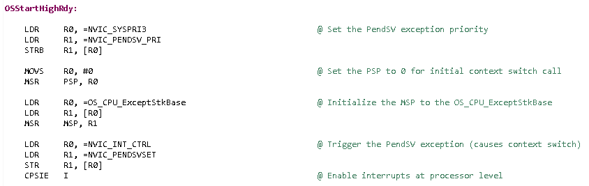

porting uCOSIII on Cortex M4 LM4F120XL
I want to port uCOSIII on an ARM Cortex M4 (LM4F120XL board)
I am using Eclipse with GCC compiler and OpenOCD to flash and debug the board.
I have build the project but when I flash and debug the SW I get stuck in the hard fault interrupt handler.
By debugging I found out that the problem may be the PendSV interrupt handler.
The interrupt handler is defined in assembler file as_cpu_a.asm like follows:
also the handler is defined as global in the assembler file:  .globl  OS_CPU_PendSVHandler
In the startup code the handler is declared as:
extern void OS_CPU_PendSVHandler(void);
and then added in the vector table defined like this:
The PendSV interrupt is set in the following assembler routine that is executed, but then the execution reaches the hard fault interrupt:
with the defines:

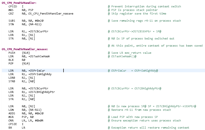

I tried several things:
1. I replaced the PendSV handler with a wrapper of the same OS_CPU_PendSVHandler, basically called the assembler function, and this works first => the interrupt is executed, but then the returning from the function reaches a special routine where the execution should not reach:
By doing some research,  I found that could be a stack problem, and I am not sure I am doing the right thing with my linker configuration file that looks like this:

    Now from what I saw by debugging until now, the problem is somehow related to PendSV interrupt, but I don't know where.

    Using the IAR setup, I got pass the PendSV interrupt issue, but still the software doesn't work.
    What hapens is that after like 6 context switches there is a brach to a invalid memory and the execution ends up in the hard fault handler.
    I saw that in the PendSV handler where the context switching happens the context is saved in the "process stack" by using the MRS instruction.
    On the ARM Information center site I found that note: "Your initialization or context switching code must initialize the process stack pointer."
    Where this initialization should be?
    Thanks!
    Petru Tabac

    So I managed to enter the PendSV interrupt using the Eclipse tool set, and I know the primary cause of that by I don't know why it is like this....let me describe...
    So after a lot of debugging, also read a lot about the fault handling, I didn't manage to understand what is the problem. Now I looked in the memory at address 0x00000000 where the vector table begins and I checked that the addresses of the handlers in the memory is ok. So what I observed is that in the vector table the addresses of the handlers are odd numbers and they are eqal to dissembly address + 1, but only the PendSV handler (that is defined in assembler) has a even address. Now just to test, I set the handler for PendSV in the vector table: OS_CPU_PendSVHandler +1 (because it is a pointer) and set a breakpoint in the PendSV interrupt handler and the execution reached the breakpoint.
    So I have several questions:
    1. Why the addresses of the vector table handlers are uneven?
    2. I all the other addresses of the other handlers are uneven, why the PendSV handler address is even?

    1. The addresses of interrupt vectors must be odd to signal the core the thumb mode for the interrupt. ARM rules.
    2. To make the PendSV odd, you need to make this declaration before the definition of the interrupt:
    void PendSV(void) __attribute__((__interrupt__));
    if you are in a C file but for your case try to use it in startup_gcc or whatever is the file with interrupt vectors. These are GCC rules, you must obey that.

  • Hi Petrei,
    I did read the application note, and took a look in this registers, but this didn't help because it was from the interrupt handler definition.
    Like you said the addresses of the interrupt vectors in thumb mode should be odd, and if the interrupt is defined in a C file you can use
    void __attribute__((__interrupt__))  PendSV(void);
    but it is not mandatory; you just can use -mthumb in the command line for the gcc compiler.
    Now the PendSV handler was defined in assembler, and even if I use the -mthumb in the assembler command line the handler still has even address in memory.
    So I found out that I need to specify .thumb_func before the interrupt handler in order "to allow the assembler and linker to generate correct code for interworking between Arm and Thumb instructions"
    This solved the problem.
    Thank you for your support and help to get to this point.
