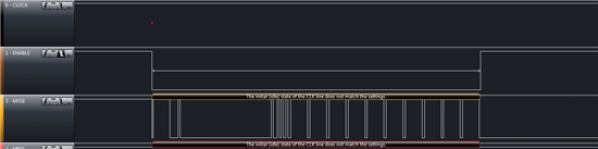

i am trying to communicate with a SD card using the SSI0 interface on the launchpad. When trying to write data over the bus im am not seeing the CLK line using a logic analyzer.

Below a screenshot of my analyzer software when writing a command to the sd card:
as you can see, the data is getting sent just fine, but there is no clock signal!
I have also tried using the SSI1 module with the same results...
What am i missing here?

    You need to call the GPIOPinConfigure function before calling the GPIOPinTypeSSI.
    Amit

    Thank you for your answer, but according to the datasheet on page 1325, PA[5:2] default to SSI state. Also, i have already tried doing that with no success:
    usign the following code gives me a hardfault on adress 0x4000652C (GPIOC????)
    GPIOPinConfigure(GPIO_PCTL_PA2_SSI0CLK);
    GPIOPinConfigure(GPIO_PCTL_PA4_SSI0RX);
    GPIOPinConfigure(GPIO_PCTL_PA5_SSI0TX);
    Fransisco

    Thanks for the reminder on the presence of the define. But in the examples this is not how it is called. For example in the SPI Master Code example, the parameter to the GPIOPinConfigure API is different from the manner in which the poster is using it.
    It should be
    GPIOPinConfigure(GPIO_PA2_SSI0CLK);
    GPIOPinConfigure(GPIO_PA3_SSI0FSS);
    GPIOPinConfigure(GPIO_PA4_SSI0RX);
    GPIOPinConfigure(GPIO_PA5_SSI0TX);
    instead of
    This could be the cause which it is getting a Fault.
    Also on which Pin on the TM4C123 or TM4C129 Launch Pad is the signal being probed?
    Amit
  • You cannot use the GPIO_PCTL_ defines with GPIOPinConfigure().  The GPIO_Pxx_xxxx defines from pin_map.h must be used instead.
    This is certainly the cause of the fault.
  • Yes! Thank you verry much i figured this out already thanks to the post from Amit.
    i was indeed  using the wrong defines. These defines are made in the "tm4c123gh6pm.h" file. Using the defines from pin_map.h gets rid of the hardfault and also enables the SSI clock line!
