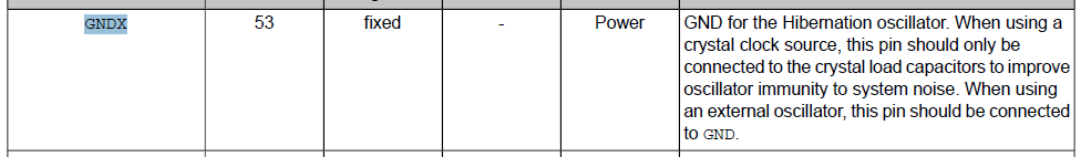

My customer has reported they found the GNDX pin description has changed in Nov. Y13 TM4C1231E6PZ datasheet(There is a statement for this on page 32 of Nov. Y13 datasheet as below). It is a big bother to them. They have built the standard M4 board based on Apr. Y13 datasheet which the PIN is NOT connected to GND. But now, the most updated datasheet shows it should be connected to GND. Several answers are needed by them:
1, Why this PIN description is changed.
2, Which is recommended to them for future design.
3, For its mature product whose GNDX pin is NOT connected to GND. Do they need to change them all.
Detail information as below:
April 09, 2013 datasheet
November 15, 2013 datasheet
Anybody give me feedback for it? Thanks.

  • Hi Xiaowei,
      If the customer has connected GNDX to the hibernate load capacitors only with no connection to digital ground as described in the April 9,2013 datasheet, they do not need to change their design.  It will function properly.  When wired like this, there is an opportunity for EMI noise to be coupled into the GNDX net if the system is operating in an environment with high EMI activity.
      The November 15th datasheet change to make the connection of GNDX to and the hibernate load capacitors to digital ground was made to prevent possible EMI noise from being complied into the GNDX net.
    Ken
