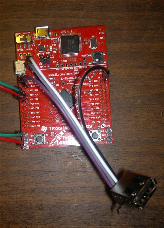

Here is my hardware setup:
Instead of putting in the 0 ohm resistors, like the documentation says to do for host operation, I routed the VBus through jumper wires. PB0 is connected to ground and PB1 is connected to VBus.
What am I over looking?

  • Hello, I'm trying to reproduce your success, but with little result by now.
    I also routed usb port with jumper wires, but my setup is slightly different
    better resulution of image here: http://postimg.org/image/m9nw8f0yn/
    Wires by colors:
    • red: PB1 <-> VBUS
    • green: PB0 <-> GND
    • purple: VBUS
    • black: GND
    • white: D+
    • green: D-
    Code copied from yours, exceptt startup.c. I use sourcery codebench lite on linux and so startup file is slightly different, but interrupt handler set as suggested in this conversation.
    Still my mouse driver callback function got no calls whlle debug ran.
    Also something strange happened when i pulled out my mouse from usb host port. Debugger suddenly started to alert me about losing control over MCU and curciut became quite hot. I disconnected power as soon as i felt chip temperature. I thought that chip was dead, but after disconnecting all wires it seems as it works fine (except usb part, which had problems from begining)
    Where can I be wrong? And what the point in connecting VBUS and GND to pins PB0 and PB1? GND signal on ID line helps MCU to understand that its working in host mode i think. Will connecting VBUS to one of MCU pins allow chip to control it? But how? If MCU tries to pull it to GND it will cause short circuit in chip and cause mentioned overheat, so its not possible.
    Thanks in advance
  • Vasilly Prokopiev said:
    red: PB1 <-> VBUS
     Hi remove this from supply rail, it is not protected. It is 5 volt tolerant to detect external bus power but your case never sense 5Volt rail, +VBUS is different from +VUSBBUS coming from user socket.
     On manual also recommend never move the slide of power selector Device-Debugger to avoid spikes and latchup.
  • Ty for answer. Could you be a little more particular? I thought that signal on pin VBUS on booster pack pins are the same as VBUS on supply rail pin. And which pin is 5V tolerant? PB1?
    I read the documents and there is said, that i can drop additional pins except D+ D- and gnd when i'm not using OTG mode, but when i removed theese wires - nothing happened

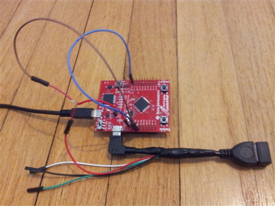

  • Thanks Stephen and stepman for the nice and useful example.  It is working for me too on KEIL.
    To have a "cleaner" solution I have used the following USB adapter: http://www.dx.com/p/micro-5pin-to-usb-female-otg-data-cable-black-129671#.U9Y3HKPmTcs
    and shorted the R25 and R29 pads on the board (0 ohm resistors). To power supply the device I have short-circuited the middle and outer contacts of the switch as described here: http://forum.stellarisiti.com/topic/1714-usb-power-for-host-operation/
    In this way, when the switch is on "DEBUG" position the USB device (a mouse in this case) is powered from the TIVA C board.
    when the switch is on "DEVICE" position the TIVA C board (and the mouse, of course) is off.
