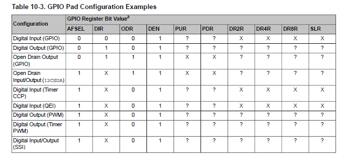

Yes i had a look at the document. It is not much relevant to what i am trying to do. Suppose for other registors like GPIOAMSEL how the different combination of bits trigger different output? How many comibinations are possible? How can i find the details about GPIOAMSEL,GPIOAFSEL

Hi Nabila,
In the datasheet section for GPIO, there is a table which explains the combination of the gpio registers and the effect of the register configuration on the output. For your reference see below;
If your question is how
GPIO_PORTF_DATA_R=0x04;
sets the Pin PF4 to 1, then you would need to look in the inc/tm4c*.h for the macro defitnition

Hi Nabila,
Refer, to your datasheet when trying to understand about registers. Do refresh your memory regarding hexadecimal and binary.
Nabila Naorin said:GPIO_PORTF_DEN_R = 0x14; // 7) enable digital I/O on PF4, pf2
This is correct. Refer to GPIODEN register.
Nabila Naorin said:GPIO_PORTF_DATA_R=0x04; // set pf4 to 1
This sets PF2 to 1, not PF4. Refer to GPIODATA register

Thank you Amit. One last thing, what about the AMSEL register? When do we need to set the bits of that register?
Nabila
Hi Nabila,
The AMSEL register is required to be set when a analog function like ADC, ACMP or USB pins have to be used.
Amit Ashara
