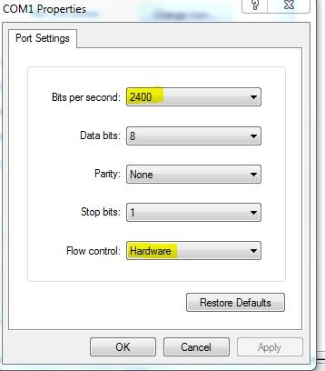

    I used hyperterm as stated in the workbook, and it came back with a 'can't connect' error message. putty seemed to work with xp, so I moved on, but I'm still interested in knowing how to use hyperterm. It usually opens on my machine wanting to set up a terminal session, but even when it defaults to running a serial comm session, it can't seem to connect.

    it (Hyper-terminal) can't seem to connect.
    Usually - this results due to "mismatch" between Hyper-terminal's "default" communication settings and those w/in your interconnected MCU.
    Upon opening Hyper-Term click: File > Properties > Connect to > Configure... following should reveal:
    Those 2 highlights are not, "normally/customarily" good matches for your MCU.  "Hardware Flow Control" is the most likely cause for your failure to connect.  Replacing that selection w/ "None" & aligning the other selects -usually gets you, "On the Air."
