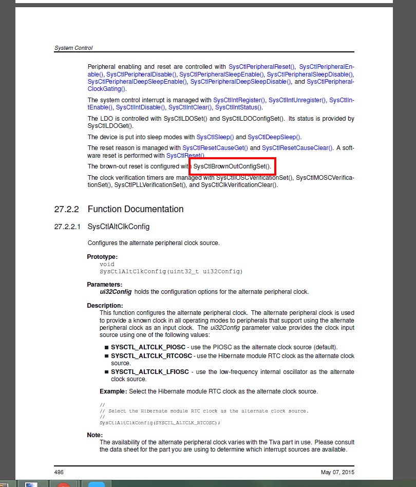

  • Hello Amit,
    I've been hunting for any resolution to this problem or example to setting BOR on TM4C1237E6PM.
    Please provide an example. What Aman has suggested as an example won't work on the TM4C1237E6PM because there is no 'delay' field in the PBORCTL register. Furthermore, there are two brown-out levels BOR0 and BOR1.
    Please reply. We have to use this capability if it is actually working and documented as working.
    Hint: There is no proper reference to the sysCtlBrownOutConfigSet() in the Peripheral User's Guide (see attached).
    Kevin
  • Hello Kevin,
    Thanks for pointing it out in the document. I will try to get it fixed for the next release.
    The setting of the register for BOR0=0 and BOR1=1 while valid may not work as the Reset trip point is close to VDD_POK falling edge.
    Amit

  • Amit,
    I'm not taking the time to find the other comments, but you can see that Robert replied below.
    The issue is this was a big time waster. There is no delay factor on this chip, but the driver is
    written so as to support it (which is an error). There is no errata to not use the higher BOR level
    although I can see that the default when setting BOR up is to use the lower level. If it's not working
    then it must be in the errata. So, please fix the drivers and fix the errata.
    Kind regards,
    Kevin
  • Hello Kevin,
    If the Upper threshold is set for reset and the lower threshold for interrupt, then as the voltage falls, the reset will occur earlier than the interrupt. I do not see why an errata is needed for the same.
    Amit
