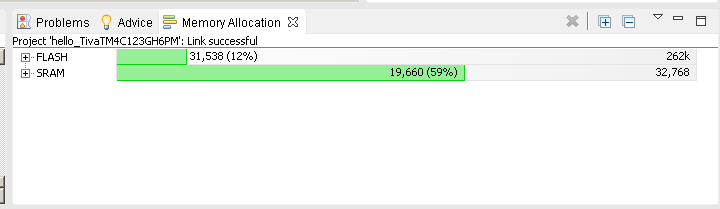

  • Rakesh Ranjan1 said:
    I notice that the size of the generated out file is 1.58Mb.
    The size of the .out file isn't representative of the amount of memory used by the program, since the .out file contains some data such as symbol addresses which doesn't get loaded to the target device. Whereas the CCS "Memory Allocation" views shows the actual memory usage on the target.
    e.g. I compiled a "hello" SYS/BIOS example for a TMC123GH6PM and the resulting .out file was 1,637,692 bytes. The CCS Memory Allocation shows that the memory usage on the target is 31,538 bytes of flash and 19,660 bytes of SRAM:
