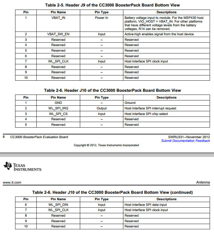

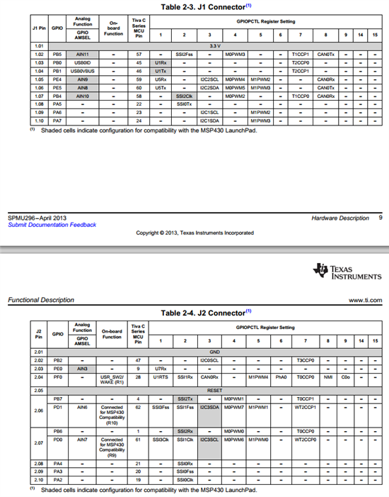

  • Thanks for the response.
    I corrected the Port F - Port D error. Still having problems.
    From the CC3000 SimpleLink Boost datasheet i have the following J9 and J10 pin setup:
    And from the TM4C123GH6PM manual corresponding pins on J1 and J2:
    What I read is that my setup has no conflicts. Do you guys see anything else?
    I'm guessing "reserved" pins = not tied up to anything = it can be used for other configurations?
  • The conflict is on TM4C123G LaunchPad pins 2.06 and 2.07.  Note that PD0 and PD1 are connected to this pins by R9 and R10.
    Remove R9 and R10 in order to use PD0 and PD1.
    R9 and R10 provide I2C to pins 2.06 and 2.07.  If I2C is not needed on those pins then R9 and R10 can be removed without consequence.  I2C was needed on those pins per the BoosterPack standard in place at time of the TM4C123G LaunchPad release.
    Dexter

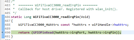

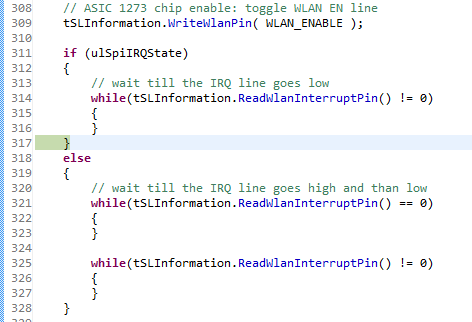

  • Okey, so now I have the CC3000 board manually wired. The only pins being used on the launchpad is J2: 2.1, 2.2 and 2.3, and J1: 1.1, 1.2 and 1.7.
    Just as a test, I did a new download of the RTOS tcpEchoCC3000 and run it without any changes. With and without the manually wiring between the boards, the code is getting stuck and not working as before.
    When pausing the debug I get the following loop:
    Any suggestions? I also tried running the CC3000 patcher which also came along the CC3000 SDK. Neither this would run properly.
    It seems to me that after running my customized code (the first post), everything seems to go wrong... :P
    The PWM output I tried to run out on PD0 and PD1 could not physically cause a defect on the CC3000?
  • It is not likely that the PWM on PD0 and PD1 damaged the CC3000 or the Tiva device.
    We (Tiva group) recently went through and revamped the CC3000 examples that you are using. Those examples originally came from the CC3000 team.
    The updated and known working examples are now posted in TivaWare 2.1.12573.  This was just released this week.  Try the examples in the new TivaWare release under C:\ti\TivaWare_C_Series-2.1.0.12573\examples\boards\ek-tm4c123gxl-boost-cc3000\ assuming you use the default install directories.
    Dexter
  • Previous post omitted URL of TivaWare 2.1 download page.
    Try these and let us know.  Be sure to follow the readme.txt instructions for setting things up as well.
    http://software-dl.ti.com/tiva-c/SW-TM4C/latest/index_FDS.html

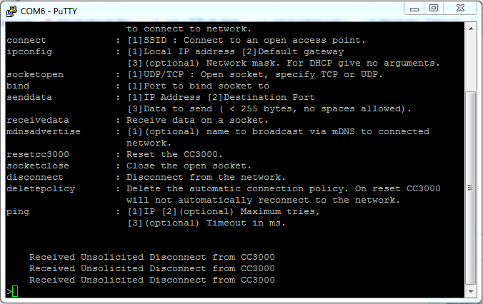

  • Hi again!
    So, what has been done since last post:
    - downloaded tivaware 2.1
    - ran the newest cc3000 pather
    - ran the basic wifi application
    - managed to run the smartconfig by activating the board through hyperterminal on my computer
    - smartconfig through my HTC android

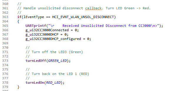

    Everything seems to be working except actually establishing a connection to my AP.
    The hyperterminal continues to send me the message: "Received unsolicited disconnect from CC3000".
    I tracked it down to the following line of code:
    I also tried running the earlier CC3000 sdk example tcpEcho without it working. Any suggestions?
  • Alexander,
    This is just a status message telling you that the CC3000 received a disconnect message. It is the same thing that will be triggered if you run the "disconnect" command. This seems to indicate that you are connecting, then disconnecting from the access point.
    This is not a bug in the code, though it may indicate trouble with keeping the connection between the access point and your cc3000.
    Just to make sure, you have run smart config on the board and smart phone and the light changed color on the board correct? Then you reset it and are seeing the disconnect messages, correct? If this is the case can you try running the ping command and see if you get anything?
    Oh, one more thing, is your wifi encrypted or unencrypted?
    -Austin
