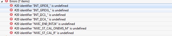

 I am getting these errors when I compile my code: ' #20 identifier "xxxxxxx" is undefined '
It is defined in hw_inits.h
What is causing this error ?

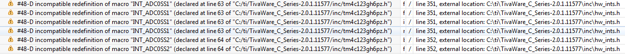

Also i am getting 400+ warnings that particular definition is redefined and does not match.
One definition is in the hw-inits.h and the other is in controller specific header file. i cannot remove either of them,
How can I resolve ?

    i commented out the following lines of code :
    //Disable PORTG Peripheral interrupt
    IntDisable(INT_GPIOG);
    IntDisable(INT_GPIOE);
    The above lines removed 2 errors (they were working just fine in Stellaris, i thought may be TIVA doesnt use this method to disable them)
    I am hoping this function does that : GPIOIntDisable();
    Only one error remains related to the following line:
    // clear any pending NVIC interrupts
    NVIC_UNPEND0_R = TIMER2_IRQ;
    This line was written to clear some NVIC interrupts( i am not very sure WHAT and WHY), is there some equivalent API for TIVA.

         I suspect, this error is caused by not properly setting Preprocessor Symbols. Here below is what I have from one of the example programs for Tiva Launchpad.
         PART_TM4C123GH6PM TARGET_IS_BLIZZARD_RB1
    -kel
  • Yes i have TIVA Development Board.
    My controller is TM4C123GH6PZ.
    I removed the hw_ints.h from my project, as the controller header seem to have all definitions, so all warnings are gone.
    Only issues are:
    1. can i remove this IntDisable(INT_GPIOE) (Stellaris Code), if i use this : GPIOIntDisable(PORT,PIN);
    2. How to resolve the error related to this:
    NVIC_UNPEND0_R = TIMER2_IRQ; // clear any pending NVIC interrupts (Stellaris Code)
     Error :  #20 identifier "NVIC_EN0_INT24" is undefined
    Obviously i didnt understand the code so i could solve it. I took over this project 2 days back and is filled with errors, so i wanted to get rid of the bugs and then understand the code.
    NVIC_EN0_INT24 is defined in the header file 'hw_nvic.h'

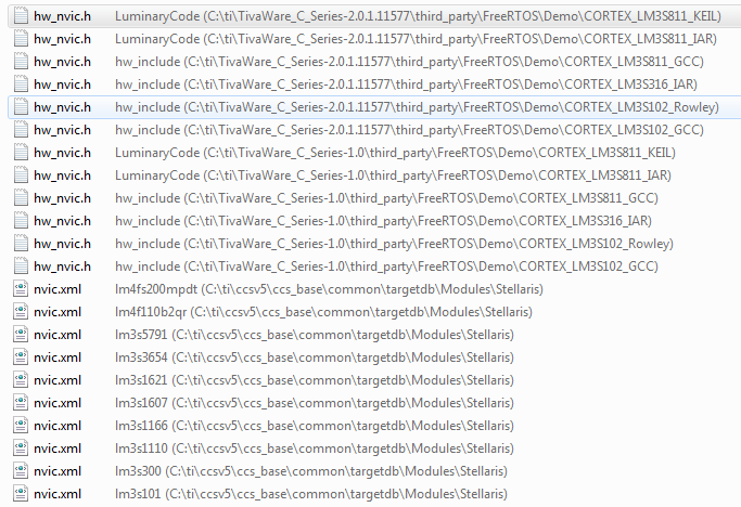

  • I have both TivaWare 1.0 and 2.0, I am currently using v2.0 for the project.
    Following is the search result of the file:

    But that path is board specific, and i am writing the code for project that does not use the Eval Board, so i need to have common header file.
  • Hi Feroze,
    From your search results, the files seems to be for LM3S - "Stellaris".
    BTW, I found this API at interrupt.c. See, if using that instead, helps. See, details at the Tivaware Peripheral Driver Library User's Guide
