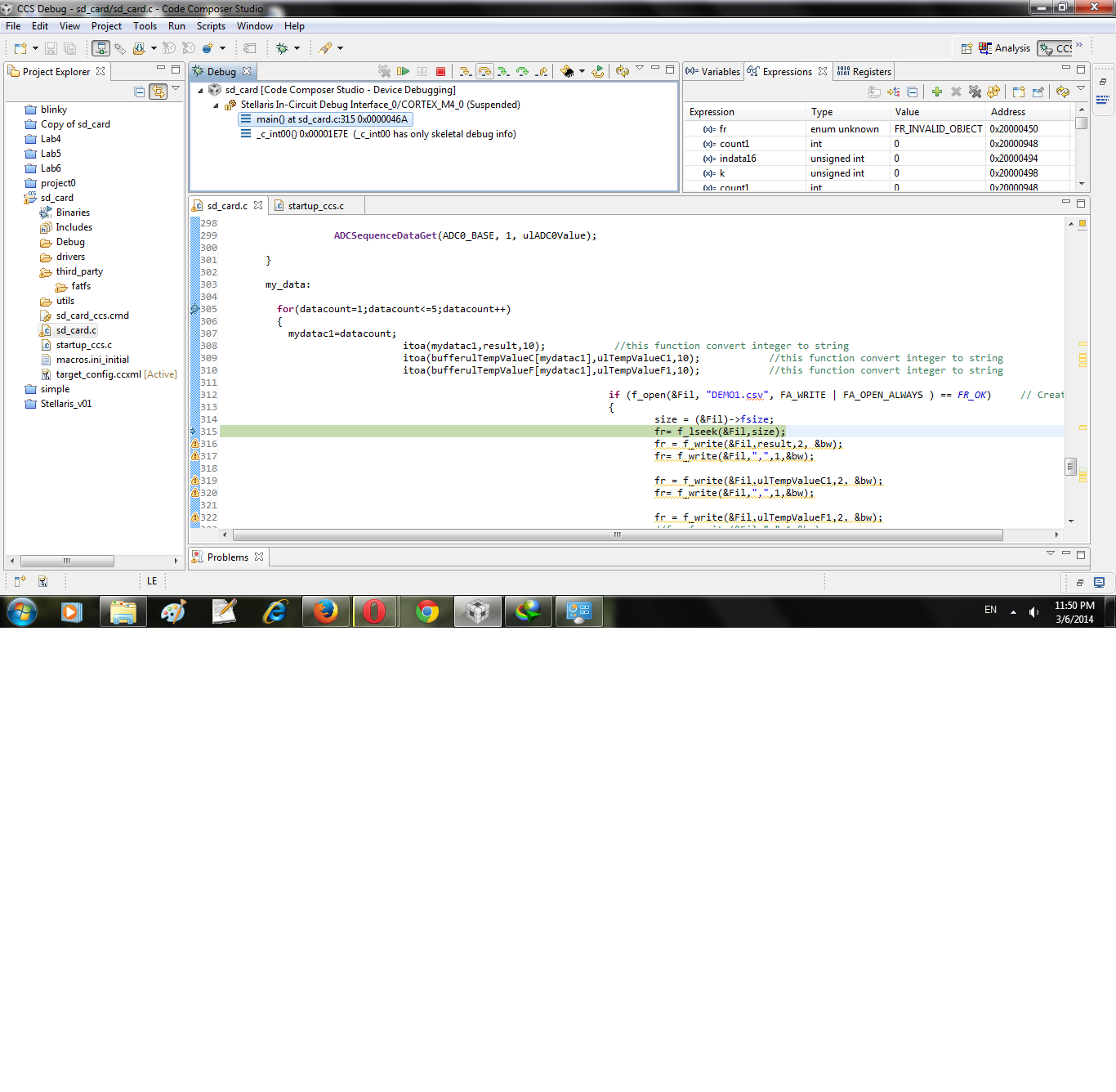

          I want to read the internal temperature of the stellaris and store the data into the sd card in a .csv format.
I am successfully create the file and also append the data. I am using chan-fat fs library.I getting the data from the internal sensor every second so that i had used timer for the timer interupt.but after the five second i had stop the timer but after the stopping the timer it was not appending the data of the sensor.i send you my code.i don't understand the this type of confusion.

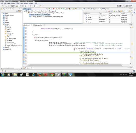

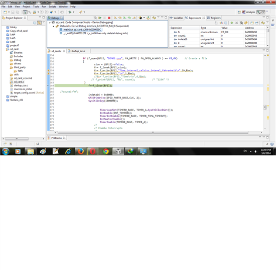

first image if before enable the time and i store  data successfull.second image show the same file could not open after disable the timer.
 and after
