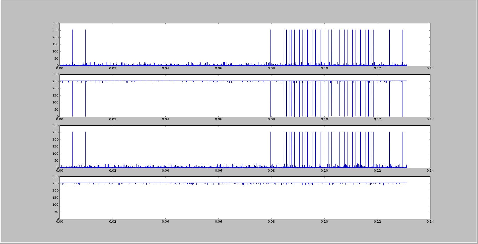

 I'm working with a Tiva TM4C123GE6 part and I'm using a single ADC ( adc0) in 1Msps mode.  I'm running across 8 channels and over sampling by 2.  So, 500k and the adc is triggered by a timer at 50k cycles.  This seems to work ok until I add signals onto more than 1 of the 8 channels and I get some very off the wall data points.  I have the 8 channels tied into a launch pad that oscillates two pins at different frequencies.  So, 4 channels goes to one launchpad pin and 4 channels goes to the other pin.  When I pull the data points down I've saved for each channel and plot it..it looks like some of the channels might be bleeding over.  The signals are rectangular waves and when it is supposed to be zero i'll get a random max value and when it is supposed to be high I'll get a random low value.  The only channel that works reliably for some reason is the very last one.  The launchpad isn't driving any loads or anything.  Is this situation an example of me running the adc too fast?  I wouldn't have thought this, but do I need to back the sample rate for the ADC down from 1Msps to 500ksps to solve this problem or is it more likely that something else is going on?
If i run this setup using a single channel configuration it works perfectly.

  • Im using 8 channels only....no ninth channel. A0 to a7. Ive configured the sequencer to end on channel 7. If you look at the picture of my data plots it shows a little more clearly whats going on. The first 8 are not ok. The only data that is correct is the 8th channel. Channels a0 to a6 all have errors. Channel a7 looks correct. Ill post up my configuration code when I get home. Im using adc0 only and using the 8 step sequencer. Im using sequencer ss0. Does it seem llike a setup like this should yield clean accurate data? Said differently, should the launchpad be able to drive the adc ok in this test setup? Could there be a problem switching through the channels at 1Msps because its too fast causing residual charge from one channel to be carried over to other channels? The problem doesnt seem to appear when a use one single channel but does appear when I sample more than 1 channel.

  • Hey sorry for not being more clear about my connections.  I just got home and drew up a sketch.  Attached is the pdf of my connections.  There are no circuits or IC's/parts in between the MSP430G2553 and the TM4C.  I just connected 1 pin on the 2553 to 4 channels on the TM4C and another pin on the 2553 to 4 channels of the TM4C.  I only cycle through 8 channels (A0-A7).

  • The initial phrase of "ADC channel bleeding" might come quite close to the point. Such effects are most often caused by inappropriate source impedance. The configured sample time and sample rate are probably not sufficient to fully charge/discharge the sampling cap to the value of the following channel, resulting in the observed "bleeding" effect. That would boil down to calculating a simple RC element, where C is fixed. As a solution, either reduce R (provide more current at the inputs, i.e. use  buffer amplifiers), or increase the sampling time (reducing sampling frequency).
    A simple test is to increase the sampling time by factor 2 or 4. If the bleeding effect is reduces or disappears, it's purely electrical.

    Another note is that the adc, when recording 8 channels, is triggered by a timer.  When the timer triggers the adc to sample at 10ksps all the data is fine.  When the timer triggers it to run at 50ksps it isn't.  If you look at the data it looks like the adc is saving data from one channel on another channel.  For example when channel 2 is low (0 volts) and channel 1 is high (3.3 volts) it puts a sample from channel 2 on channel one.  Basically what I'm saying is that it isn't creep or a little variation.  When channel one is in the middle of sampling the peak of the square wave there is a random 0V sample in the middle of say 500 3.3V samples.  Said differently, when channel one is supposed have 500 samples of ~255 it instead has 499 of 255 and 1 of 0.
    When I leave the adc configured to 1Msps and just slow down the timer that triggers the adc this problem goes away.  I still want to slow the ADC down to 500k as stated above, but this is just some more information.

  • Alright, so first I want to thank you guys for the help.  As usual, this is an outstanding resource.  I've finally figured out what was going on.
    I just briefly mentioned that I was using the USB stack and that it was running.  Turns out that it was servicing stuff (not educated enough yet to explain exactly what it was doing), but it would interrupt and every so often the Tiva part wouldn't come out of the USB interrupt fast enough to make it through the ISR for the adc.  I changed to priority of the USB stack after enumeration down a level and now the ADC and ONLY the ADC has the highest interrupt priority.  This fixed my problem.  All my channels 1,2,4,8 are working ok now at all speeds.
    I just used the
    IntPrioritySet(60, 0x20);
    instruction to change the interrupt.  The 60 is the INT_USB0, but instead of including the .h file for the particular tiva part i'm using in my USB stack I just found the definition and plugged the number in.  This information is in the part number.h file if anyone is interested.  Long story short, put some thought into interrupt priorities because when your timing is super tight like this they apparently matter ;)
    Thanks again for all the help guys!
