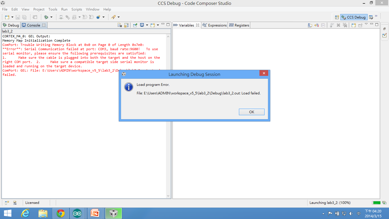

I failed to use the debugger
and the console tag says:
Hello Chinpo
The message seems to be explanatoy
•ComPort: Trouble Writing Memory Block at 0x0 on Page 0 of Length 0x7e0: **Error**: Serial Communication failed at port: COM3, baud rate:9600! To use serial monitor, please ensure the following prerequisites are satisfied: 1.Make sure the cable is plugged into both the target and the host on the right COM port. 2.Make sure a compatible target side serial monitor is loaded and running on the target device.
Are you COM Port for debug or JTAG debug? LM Flash Programmer will not allow for debug but for programming a bin file, unlocking device, etc.
Amit
Hi Amit:
I want to ComPort for JTAG debug, I thought the Tiva™ C Series have built in JTAG debug circuit, I am sure that the "stellaris virtual serial port" is at port: COM3 and I set it in the target configuration but i still receive the failure when loading
File: E:\Users\ADMIN\workspace_v5_5\lab3_2\Debug\lab3_2.out: Load failed.

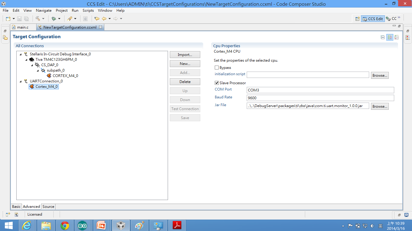

Hello Chinpo,
Can you send a snapshot of the Target Configuration ccxml file
CCS does not use COM Port but JTAG for debug which is what TIVA-C series does have.
Amit

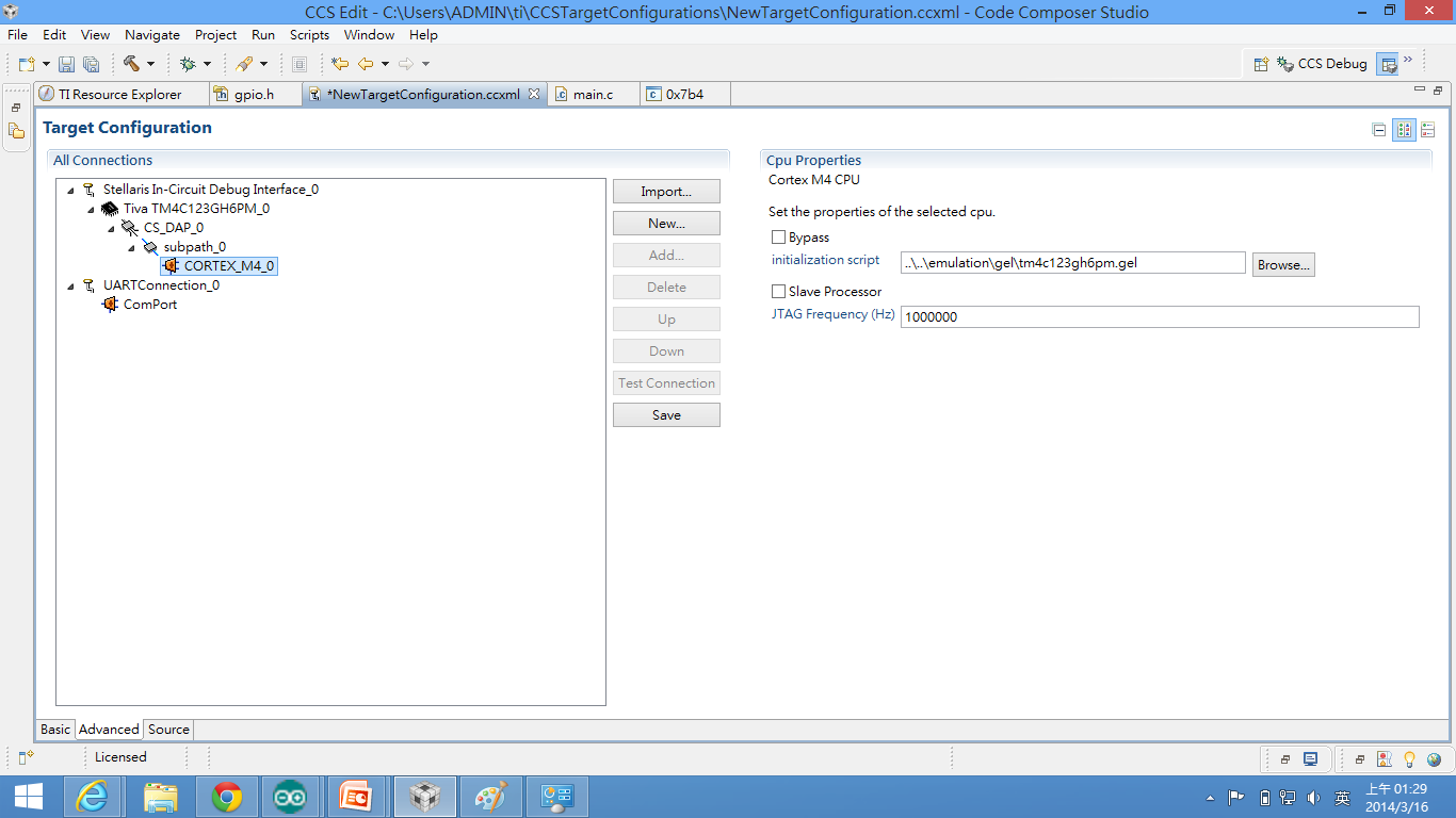

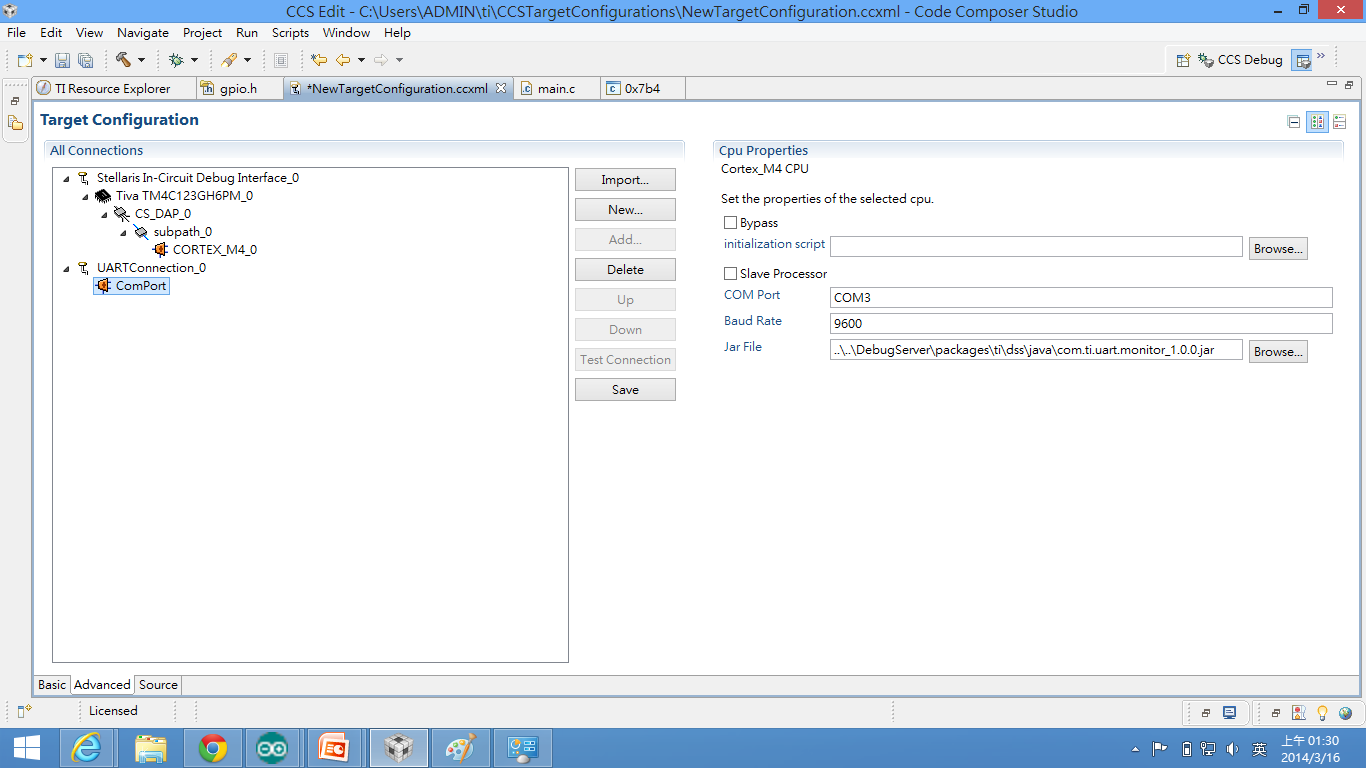

Hello Chinpo
Can you remove the UARTConnection_0 from the ccxml and then try again? The COM Port can be launched using another application like TeraTerm or Hyperterminal
