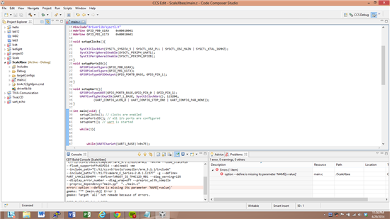

  • Im trying to read the values from an Xbee but i get the same error --define is missing its parameter'NAME[=value]'
    can you tell me how did you resolve your problem?

  • Hello Enrique,
    In your CCS Project right click the project then
    "Show Build Settings" -> Build -> ARM Compiler -> Advanced Options -> Predefined Symbols
    There you can add under "Pre-define NAME" the following two defines
    PART_TM4C123GH6PM
    TARGET_IS_TM4C123_RB1
    Amit

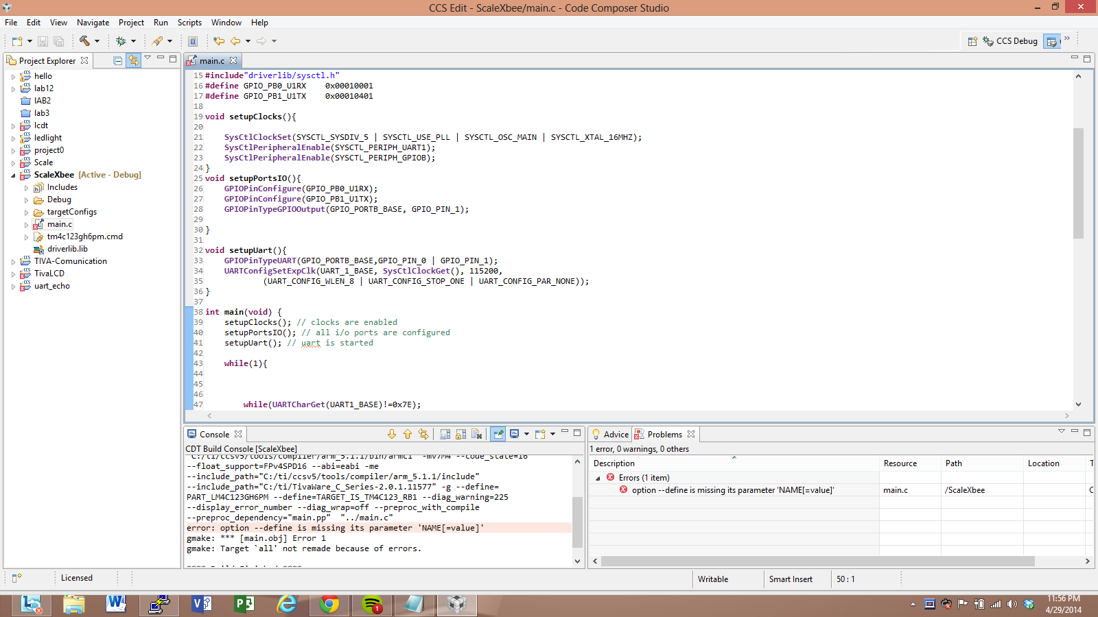

  • Amit:
    this is my code after a few adjustments and i still after i added "defines" i still get the error
    the weird thing is that it does not mark an erro on the code!!!!

    This is my code and i have errors can you send me your code to check mine or can you tell me how did you resolve your issue
    #include <stdint.h>
    #include <stdbool.h>
    #include "inc/hw_ints.h"
    #include "inc/hw_memmap.h"
    #include "inc/hw_types.h"
    #include "driverlib/gpio.h"
    #include "driverlib/interrupt.h"
    #include "driverlib/pin_map.h"
    #include "driverlib/sysctl.h"
    #include "driverlib/uart.h"
    #include "driverlib/uart.c"
    #include "driverlib/adc.h"
    #include"inc/hw_types.h"
    #include"driverlib/pin_map.h"
    #include"driverlib/sysctl.h"
    #define GPIO_PB0_U1RX 0x00010001
    #define GPIO_PB1_U1TX 0x00010401
    void setupClocks(){
    SysCtlClockSet(SYSCTL_SYSDIV_5 | SYSCTL_USE_PLL | SYSCTL_OSC_MAIN | SYSCTL_XTAL_16MHZ);
    SysCtlPeripheralEnable(SYSCTL_PERIPH_UART1);
    SysCtlPeripheralEnable(SYSCTL_PERIPH_GPIOB);
    void setupPortsIO(){
    GPIOPinConfigure(GPIO_PB0_U1RX);
    GPIOPinConfigure(GPIO_PB1_U1TX);
    GPIOPinTypeGPIOOutput(GPIO_PORTB_BASE, GPIO_PIN_1);
    void setupUart(){
    GPIOPinTypeUART(GPIO_PORTB_BASE,GPIO_PIN_0 | GPIO_PIN_1);
    UARTConfigSetExpClk(UART_1_BASE, SysCtlClockGet(), 115200,
    (UART_CONFIG_WLEN_8 | UART_CONFIG_STOP_ONE | UART_CONFIG_PAR_NONE));
    int main(void) {
    setupClocks(); // clocks are enabled
    setupPortsIO(); // all i/o ports are configured
    setupUart(); // uart is started
    while(1){
    while(UARTCharGet(UART1_BASE)!=0x7E);
    for(i=0;i<19;i++){
    bytediscard=UARTCharGet(UART1_BASE);
    readvalue = UARTCharGet(UART1_BASE);
    if(readvalue==0)
    GPIOPinWrite(GPIO_PORTF_BASE, GPIO_PIN_0 , 0x00);
    SysCtlDelay(5000000);
    else
    GPIOPinWrite(GPIO_PORTF_BASE,GPIO_PIN_0 , 0x02);
  • Hello Enrique,
    There would be a space at the start of one of the defines. Please go back to the build setting path and check if there is a space on "PART_" define
    Amit
  • Yes their a space on  "PART_" without it gives more errors but the error persists
    any more suggestions?
  • Hello Enrique
    Can you zip your project and send it across?
    Amit
  • Hello Enrique
    Cleaned and attached
    Amit
