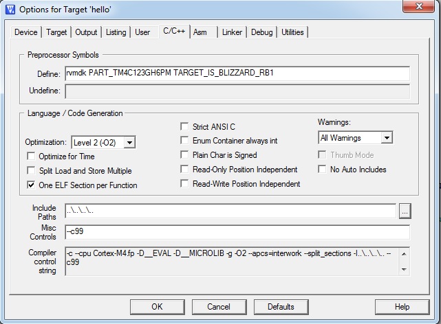

Hi, I am doing programming on the tivac launchpad using the ccs 5.5 and I am getting errors saying that GPIO not
defined, even after I linked the GPIO driver lib file, its not going away, please advice

    and this is the error I'm getting
    Description
    #20 identifier "GPIO_PA0_U0RX" is undefined
    Description
    #20 identifier "GPIO_PA1_U0TX" is undefined
    the error is still there even after I link the GPIO dirlib from the driverlib
    please advice

    Both defines reside w/in pin_map.h - which does not reveal w/in your listing.   Special methods are required to "tell" your IDE the identity of your MCU - so that pin_map.h finds your MCU and those definitions.
    Description
    Description
    These defines above are dependent on a preprocessor symbol define "PART_TM4C123GH6PM". I guess you made a new project. You, can verify these preprocessor symbol define at one of the example programs project options->C/C++ for Tiva Launchpad. Here is mine below from the Hello example program.
