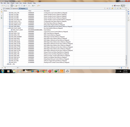

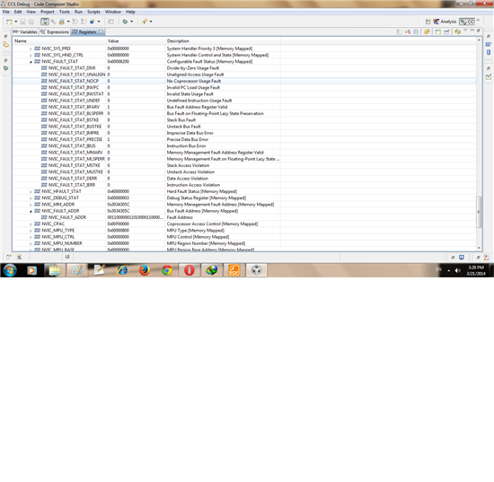

  • According to my debugger i found that value of
    NVIC_FAULT_STAT is 0x00008200 ,but the value of
    NVIC_FAULT_ADDR is 0x3034305C .which try to find in the memory map table but it is not in the any range of the memory table,which i see in the datasheet.
    Now which type of fault is generated ?
    -Darshan
  • Hello Darshan
    This is a Data Fault which is because of an access from D-Bus of the Cortex M4 to an unknown address. This would generally arise if for a function you are using an un-initialized variable
    Amit

  • Yes,Fil is a global variable and size of bufferulTempValueC and bufferulTempValueF is 5 also because i store data into them for 5 second and it show me also five value.
    But here problem is  not related to bufferulTempValueC and bufferulTempValueF. because whenever i going to open the demo1.csv file. It will create a fault for the 3rd time call only.
    Darshan
  • Hello Drashan,
    Firstly I do not have the setup that you may be having so reproducing the issue would not be possible. My suggestion would be to step debug the code when you run the file open (where you believe the 3rd time round it goes into fault) and see where exactly is the CPU execution going to cause a Hard Fault.
    Amit
