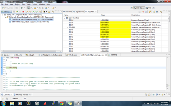

    The values of the registers using the debugger are as follows:
    NVIC_HFAULT_STAT: 0x40000000
    NVIC_FAULT_STAT: 0X00009200
    this means that the set bits are BFARV, BSTKE, and PRECISE
    NVIC_FAULT_ADDR: 0X1FFFFFF8
    and when i searched this address in the datasheet it corresponds to a location in the block reserved for ROM.
    Also MSP : 0X1FFFFFF8
    Please give me some insights about what the problem could be. if the interrupt ISRs needs to be provided i will do so.

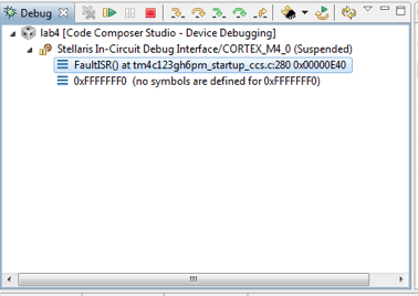

    I know it is difficult to track down the cause - you must continue - do the following: in the "debug" window, upper left one, you have all stack frames used, up to the fault handler. Look and see which is the previous one - to determine the function and the location which caused the interrupt - click on that to get the info - eventually post a picture.

    This is the "debug" window (or pane):
    As you can see, there are two rows: FaultISR() and 0xFFFFFF0 - each row correspond to a stack frame - usually selecting (click on) one row moves you to that stack frame.
    But in this case, seems you did not even reached the "main" function - please check your project again, something unusual brings you there - did you configured the stack?

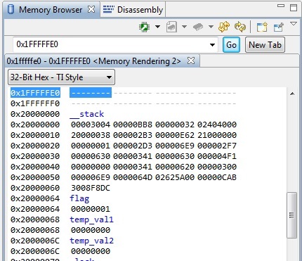

  • I read the value of the stack pointer(sp),i.e 0x1FFFFFE0 and used that in the memory browser and got the following:
    And as mentioned in the application note
    In the screen capture above, the first two rows show the exception stack frame. The first row shows the saved
    values of registers R0-R3. The second row begins with the saved value of R12, followed by LR, PC, and then
    xPSR register. To start with, the most interesting value is the PC, which is 0x0000.0CBC. There is a high
    probability that this points either directly at, or near the instruction that caused the fault.

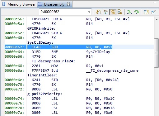

    Here my PC value should be 0x00000E62, I used it in the diassembly window to get the following:
    So is the problem arising due to the API SysCtlDelay()  ??
    No, the stack pointer shoud not be neiter at 0x20000000, nor below that address. At 0x20000000 should be a reserved space for interrupt vectors in the case you move them to SRAM. SP should be in SRAM.
    If you are sure you enter main, then start by stepping over each function until you find out which one is the cause of hard fault. For your special initialization functions, step in first when you got to that function and then step over each inside expression/function.
    But check again the stack , the linker file and the map file.
    Petrei
