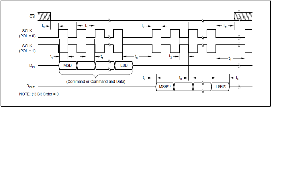

  • HI Amit
    Thanks for the reply i am using ADS 1218 ADC chip . here are the timing specification
    My pol pin is always high . So looking at the timing specification should i use SSI_FRF_MOTO_MODE_3 ?
    if yes is the ans then should i follow this procedure :
    Since i am using TM4c123GH6PGE
    1)set the FRF bit of SSICR0 to 0x0 (freescale)
    2)Set the SPO and SPH bit to 1 .
    is this the correct solution ?
  • Hello Shubham,
    That is correct. You can use both clock polarities.
    Please do make sure that the SCLK frequency is as per the ADS1218 requirement
    Amit
