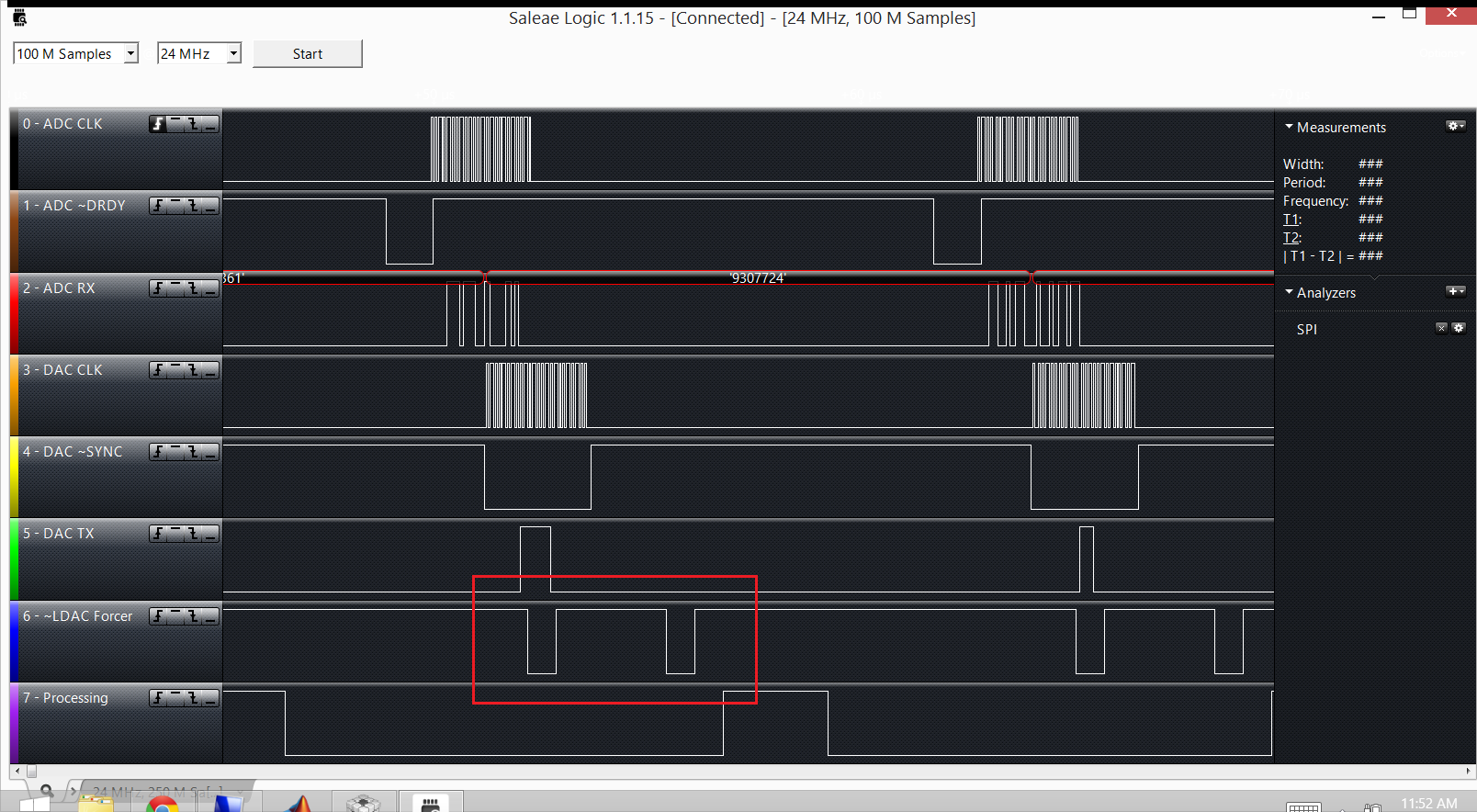

I have the uDMA setup to make a transfer to the SSI0 TX.  I also have the SSI0 end of transmission (EOT) interrupt setup to trigger a gpio pulse low.  However when I monitor the SSI0 output and the gpio using a logic analyzer I notice that it takes 2 us (CLK =80MHz) from the end of the SSI0 transmission to the start of the pulse that is triggered by the SSI0 EOT interrupt.  The Logic analyzer screenshot below shows the problem.  (also available in the attached folder) The signals in the screenshot are:
DAC CLK -> SSI 0 CLK
DAC ~SYNC -> SSI0 CS
~LDAC FORCER -> GPIO pulse supposedly generated by SSI0 EOT interrupt
I was really expecting ~LDAC_FORCER to go low immediately following the end of the SSI0 transmission.

    I have changed my code to enable the uDMA interrupt that for triggers at the end of software uDMA transfers during my initialization of the SSI0 uDMA.
    uDMAChannelAttributeEnable(UDMA_CHANNEL_SSI0TX, UDMA_ATTR_REQMASK);
    	// Now the software channel is primed to start a transfer.  The channel
    	// must be enabled.  For software based transfers, a request must be
    	// issued.  After this, the uDMA memory transfer begins.
    	uDMAChannelEnable(UDMA_CHANNEL_SSI0TX);
    	IntEnable(INT_UDMA); // Enables the Software channel interrupt that triggers
    						   // upon completion of a software transfer.
    The ISR for this interrupt just pulses ~LDAC_FORCER low.  As seen in the the logic analyzer plot below, the uDMA ISR triggers once at the end of the uDMA transfer and then the SSI0 ISR triggers much later.  The part of the plot highlighted below shows that both IDRs are triggered at different times.  I confirmed using the debugger that the first one is the uDMA ISR and the second one is the SSI0 interrupt.
    Here is the code that generated the above result: 2541.SSI0 - EOT Interrupt Issue - code 2.zip
    Should both of those interrupts trigger due to the uDMA transfer completion?  Do you still think the SSI0 ISR is triggered by the uDMA transfer completion?

  • Hello Curtis,
    Now that requires investigation. I will need to run a code on my side to be able to duplicate what you are seeing.
    When the second ISR fires, can you please take a register dump of SSI peripheral.
    Amit

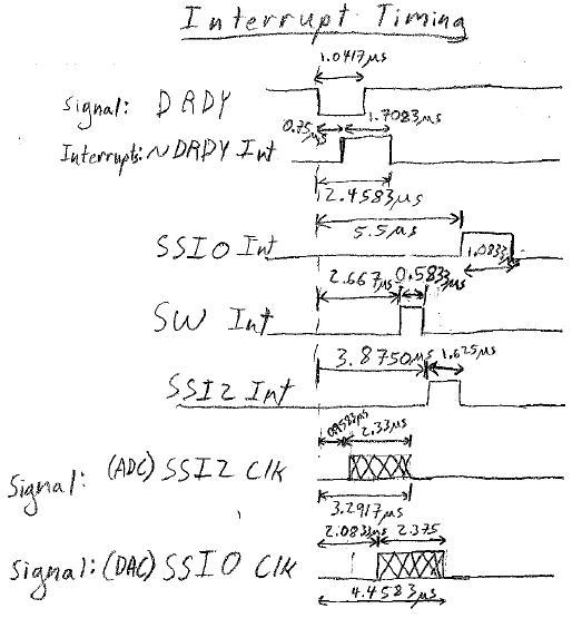

    I wanted to get an idea of the timing of each of my interrupts so I went through each interrupt and programmed it to set the processing signal (seen in the screenshot of the original post) high at the start of the interrupt and then low again at the end of the interrupt.
    I was able to generate the following interrupt timing diagram: (also attached: 6232.Interrupt TIming.pdf )
    Since my interrupts were taking much longer than I initially anticipated I decide to directly set the registers that were previously being set using function calls from the driver library.
