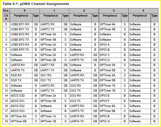

    Now this from my (RIP LX4F manual - re DMA): "Each peripheral function that is supported has a dedicated channel on the μDMA controller that can be configured independently."  I improperly used DMA when I meant "DMA Channel."  Now if it is possible to employ multiple such DMA Channels (admittedly not at the same time) then my point (inability to bind triggers to different DMA Channels) may remain valid.
    Here's the channel map for our LX4F MCU:
    Now if I read (and understand) the uDMA operation - channel numbers 6 & 7 enable an 8 bit port output via gpios C & D.  And - by alternate use (perhaps even ping-pong) the limitation of an 8 bit (only) port  transfer is mitigated.  (note that other ARM MCUs enable 16 bit, some even wider, data transfers)
    To further clarify - can beyond a single uDMA channel be transferred - without constant set-up/config of the uDMA structure?  If this is so then - are we not "impaled by the dilemma" Ayemk has identified and I have attempted to further detail?  (i.e. there appears no way to bind/link the uDMA trigger to beyond one uDMA channel!)
    The uDMA feature is enhanced if beyond a single, 8 bit port transfer can be accommodated.  This is - if my "read of Ayemk proves correct" - what is of most value to both he & my small group.  (and likely multiple others...)
    As always - thanks for your keenness & assistance to so many (especially moi) here.  (with certain departures - you are a significant addition to this "top cabin" ARM forum...)
  • Hello cb1_mobile.
    Channel 6 and 7 enable the trigger to be accepted from GPIO C and D. Based on the trigger the uDMA can do any of the mentioned transfer type like basic, ping-pong or peripheral scatter gather, The uDMA has a single active thread and at any given time only one trigger can own the thread.
    If there are multiple triggers then they get prioritized to this single thread.

  • Hello cb1_mobile,
    Sometimes familiarity with the MCU makes me presume. I hope I am able to convey the information better with every post :-)
    There are 32-channels of the uDMA which can be used to generate 32 triggers (some GPIO, sone mon-GPIO). Each trigger is just like an interrupt (if I may take as an example) requesting the uDMA to perform certain task as per the programmed control structure. The control structure can be written to do a data transfer from one address to another. So you are right in saying that different trigger can call the uDMA to target a different GPIO Port.
    As for the 2nd post, the trigger is the uDMA request coming from the respective peripheral as per the uDMA channel assignment table. So once the channel mux is set then the uDMA trigger/request allows the correct control structure to be used to perform the transfer.
    The 8-bit is w.r.t the GPIO. The uDMA can do 16-bit or 32-bit transfers as well. E.g. in TM4C129 the EPI has a 32-bit data write capability, while on TM4C123 and TM4C129 the SSI can be have 16-bit transfer capability. In the specific case of the GPIO, when doing a 16-bit or a 32-bit the only side-effect that will be seen is that the upper 8-bit or 24-bit will never be refected on the GPIO as the data width (DATA register of GPIO) allows 8-bits to 8-pins.
    Also channels can be enabled concurrently. Only when the uDMA trigger/request is generated does the channel operate. Even if simultaneously all the enabled channel generate a trigger, then uDMA goes in the order of channel number to service each of the request.

  • Hello Ayemk,
    1. Port E will initiate the DMA Channel for Port E and Port C will do likewise
    2. On the DMA trigger from Port E the DMA control structure has to be written such that Source Address of the Control Structure is the location from where you have to copy data (could be SRAM, etc), Destination Address has to be Port D Data Register at offset 0x3FC of the Port D base address. Similarly for the Port C.
    3. Yes, when the DMA is enabled, the interrupt generation capability of the Source of the DMA is suppressed till the DMA transfer is not completed. However when the DMA Channel completes, the Interrupt for DMA channel will come on the Interrupt Vector for the corresponding DMA source, in this case either Port E or Port C ISR will be remapped for DMA completion. So indirectly you would know which end port was serviced.
    4. Will add this as an app note.
    Amit

  • Hello Ayemk,
    Yes that is a Typo. Also regarding the #1 and #2 you are correct. However the interpretation is not correct
    1. The channels are independently configured. There exists a unique entry for the UDMA Channel. They work independent of each other. Again I will refer to the ISR example, The design can have ISR from multiple peripherals and each ISR can go and modify the same SRAM location for example or same GPIO Pin can be toggled.
    2. The bidirectional is for Data Transfer Peripherals like UART, SSI, I2C and not for GPIO.
    3. No, the DMA DONE interrupt will come from the Peripheral Interrupt on which the DMA channel is mapped.
    As an example, following is a code. You may have to work the compilation details.

                                        UDMA_ATTR_USEBURST | UDMA_ATTR_ALTSELECT |
                                        (UDMA_ATTR_HIGH_PRIORITY |
                                        UDMA_ATTR_REQMASK));
    uDMAChannelControlSet(UDMA_CH14_GPIOE | UDMA_PRI_SELECT,
                                  UDMA_SIZE_32 | UDMA_SRC_INC_32 | UDMA_DST_INC_32 |
                                  UDMA_ARB_8);
    uDMAChannelTransferSet(UDMA_CH14_GPIOE | UDMA_PRI_SELECT,
                                   UDMA_MODE_BASIC, g_ui32SrcBuf, 0x40004400,
                                   MEM_BUFFER_SIZE);
    uDMAChannelEnable(UDMA_CH14_GPIOE);

    For completion, I  am trying to reconcile 2 of the (many) statements you have made:
     "the Interrupt for DMA channel will come on the Interrupt Vector for the corresponding DMA source, in this case either Port E or Port C ISR will be remapped for DMA completion. So indirectly you would know which end port was serviced"
    In this example, Ports E and C were the trigger ports; Ports A and D were the byte-wide data transfer ports
    And from your quick response directly above
    "3. No, the DMA DONE interrupt will come from the Peripheral Interrupt on which the DMA channel is mapped."
    So a simple, I hope final, question: if a Port E trigger initiates a Port D DMA transfer will the DMA completion interrupt come on the Port D or Port E interrupt ISRs ??
    Ayemk
  • Hello Ayemk,
    Port E trigger which initiates a Port D DMA Transfer will have DMA completion on the interrupt Line for Port E.
    Amit
  • Amit
    Following up on your example that I requested a few weeks back, for the sake of correctness, I believe that there may be some errors in the configuration.
    The "fine print" in the uDMA section of the TivaWare™ Peripheral Driver Library indicates that, for the uDMAChannelAssign function, the parameter should be the ui32mapping value -which, in your example, is the "UDMA_CH14_GPIOE" #define, whilst all other functions (uDMAChannelControlSet,  uDMAChannelAttributeDisable,  uDMAChannelEnable,  etc) require the "ui32ChannelNum" value -which would be , in case, UDMA_CHANNEL_ADC0 or UDMA_CH14_ADC0_0 #defines, or the  channel "14" number.
    This conclusion is supported by looking at, for example, the uDMAChannelTransferSet function: (udma.c)
    "uDMAChannelTransferSet(uint32_t ui32ChannelStructIndex, uint32_t ui32Mode,void *pvSrcAddr, void *pvDstAddr, uint32_t ui32TransferSize)"
    where the function has an  "ASSERT((ui32ChannelStructIndex & 0xffff) < 64)"; however the value for UDMA_CH14_GPIOE is as follows:
     "#define UDMA_CH14_GPIOE             0x0003000E"
    The confusion is further exacerbated by the choice of channel / peripherals in the Launchpad Workshop PingPong example ( chapter 13) as the channels specified UDMA_CHANNEL_UART1RX and UDMA_CHANNEL_UART1TX are, correctly, channel numbers but it doesn't seem that  uDMAChannelAssign function is used -i.e. uDMAChannelAssign(UDMA_CH8_UART1RX) and uDMAChannelAssign(UDMA_CH9_UART1TX) (?)
    If these observations are incorrect please help to remove some of the confusion.
    BTW is there any news on the availability of a comprehensive, eagerly awaited, TM4C uDMA support document?
    Ayemk
  • Hello Ayemk,
    Gladly, would like to help clear the confusion.
    The define UDMA_CHANNEL_ADC0 is the legacy format when there were two channels. The new define UDMA_CH14_GPIOE is for multiple DMA maps per channel, where the lower half word is for the channel number and upper half word is the control to the multiplexer-demultiplexer which will select GPIOE to be the DMA source.
    As for the function which has a ASSERT, please note it checks the lower half word only to be less than 64. by first AND it with 0xFFFF.
    For the Workshop the UART1RX and UART1TX have the define which will match the new define format as well. Since it comes from an older code base, it would continue to use the same notification. I do agree that it should be updated to match the new format. That is where the application note or a better description of the uDMA be covered,
    It is not an easy task to get the application note in place and takes about couple of months of effort to make sure we test the attached examples and documentation with "beta" testing internally. Also with the number of application notes in the queue, it would take time (hopefully close by 2Q as promised)
    Amit
  • Amit
    Thank you for the rapid response that unclouds(!) some of the confusion. Not having any experience with the "legacy" structures and formatting does complicate understanding.
    I am left with 3 queries with regards to the current APIs and documentation
    1. In the uDMA APIs, is there complete equivalence between ui32Mapping  (uDMAChannelAssign) and ui32ChannelNum (uDMAAttributeEnable /Disable, etc)?
    2. In what functions is it necessary to use the "new" defines that contain the additional channel mapping -i.e the multiplexer-demultiplexer component?
    3. Under what circumstances is the uDMAChannelAssign not required (as seems the case in the PingPong Workshop example)? Is there a concept of default / legacy  multiplexer configuration?
    Ayemk
  • Hello Ayemk,
    1. Yes, it is. Please see that in the API's the mask is applied to the Channel Number before using it for any register or control table selection
    2. For devices in TM4C123 and TM4C129, it is strongly advised to use the new channel mapping.
    3. The default mapping is as per the Mux setting 0 in the channel map table in datasheet
    Amit
