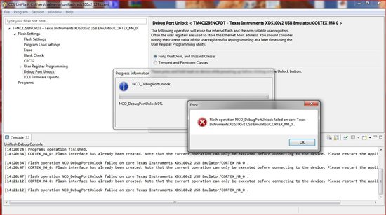

Hello all.
We have one doubt regarding this feature on the latest Uniflash release.
Is it possible to Unlock a 129X Tiva device with a XDS100 v2? We can erase the flash with this JTAG device, program the chip and read and write the registers (so the connections are OK), but after a Debug Unlock port, the chip stays the same.
We have tried connecting the TRST port of the JTAG to  the RST pint of the 129 microcontroller as well with the same results.
We can unlock it in uniflash with a ICDI stellaris board.
On the other hand, I also receive this message many times:
Everytime I get the message, we need to exit Uniflash and reset the JTAG board to get it working again.
Why is that? Is it a know bug?

  • Amit Ashara said:
    So a basic JTAG connection to the custom board is not happening, is that correct?
    I am afraid you are wrong. Please read again the first post of this thread, where I say:
    Basically, this is what I can do with both our programmers:
    Stellaris ICDI XDS100v2
    Program YES YES
    Read Registers YES YES
    Erase Flash YES YES
    Debug Unlock Port YES NO
    So, the question is why we cannot Unlock the chip with XDS100.
    Of course we have the TDIS pin (4) to ground.
    We have tried, as well, to connect the RST pin of the JTAG to the reset pin of the chip with no luck.
    Thank you

  • Hello PAk,
    I checked with UNIFLASH Team and XDS100V2 is not supported for Debug Unlock Feature.
    Amit

  • Amit Ashara said:
    Hello PAk
    Attached is the code sequence that I run on a TM4C129X with System Clock of 16MHz. This sequence is extracted from my main program, but I have tried to encapsulate the functions
    Amit

  • Hello Amit,
    is there any news about unlocking TivaC devices?
    I unintentionally lock it, I have tried at first LM Flash Programmer as it is recommended in mcu datasheet, but there is not XDS100v2 interface :-( then I tried UniFlash (3.1.0.00026), but without success. Interesting is, that UniFlash sends only positive messages:
    [21:11:58] CORTEX_M4_0: Starting Debug Port Unlock operation...
    [21:11:58] CORTEX_M4_0: Initial Unlock completed, please release reset button and press the "Finish Unlock" button in the Flash options to complete the operation...
    [21:12:02] CORTEX_M4_0: Power cycle the board to complete the unlock procedure.
    I have this problem on one prototype, but I would not throw it away.
    Thanks.
    Jan
  • Hello Jan,
    There has been no update to UNIFLASH v3.2 for using XDS100v2 for Unlock. You may need to (if you have a Launchpad for TM4C123 or TM4C129) re-wire a Launchpad to unlock it using LMFlashProgrammer
    Amit

  • Hello Jan,
    My suspicion is the PCTL that has got changed to 0x0 is causing the JTAG Lockout.
    Amit

  • And which is the configuration for LMFlashProgrammer? ICDI?
    On the other hand, xds100v2 has a FTDI2232 device, hence why the unlocking sequence cannot be achieved with it?
  • Hello PAk,
    Yes, it would be ICDI. XDS100v2 does not expose the SWD mode of operation in the API.
    Amit
