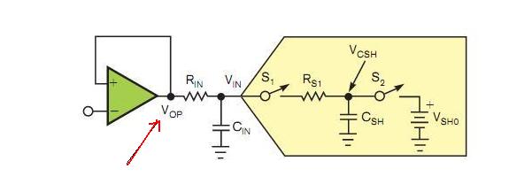

I want to set a longer sampling time so that CIN capacitor can have enough time to be stable after the sampling process of ADC of TM4C123GH6PGET. But I dont know how to set this in datasheet. I see in datasheet that ADC sample time is 250ns, so we can change this time. Anybody can help me. Thanks.

  • I want to measure voltage(Vop) precisely less than 3mV. So if Rin=1k OHM, Cin=1nF, Vop=3V. Affter sampling time(250ns), Cin voltage is 2.98V (deltaVop=20mV>2mV),because Cin charge to CADC. Do you know hơ to fix it?

    The first issue is that CSH must have a voltage that matches CIN after the sample period.  You can neglect RS1 as long as the manufacturer has set the sample period correctly and the series resistance on CIN is small compared to RS1.  If the manufacturer has not set the sample period correctly there's not much you can do.  As long as the sample period is short RIN effectively isolates the external signal from the signal so you can neglect any current in RIN.  In order for your sample voltage on CSH to match the initial voltage on CIN to within xV you must be able to completely charge or discharge CSH without changing the combined voltage by more than xV.  The worst case for this is when the two capacitors are at opposite extremes of voltage (which can easily happen if two neighbouring channels are at opposite extremes of voltage)  so you want CIN > VMAX*CSH/xV.  This is normally easy to do.
    The second element to consider is your reference.  It must be accurate and stable enough to support this.   3mV/3.3V  --> a better than .09% reference.
    The third element that must be satisfied is the accuracy of the A/D converter itself.  Check the data sheet.
    The fourth element is the gain and offset errors on your sensor input must be accurate enough and the impedance low enough that you can keep CIN accuractly charged over the frequency range of interest.
    Finally note that it is the sum of these errors that provides your final accuracy so if any one of them just meets your accuracy result than any error in any of the others will mean your final accuracy does not meet your needs.

    The first issue, you said that CIN > VMAX*CSH/xV. But I need a time about t=9*CIN*RIN(ADC 12bit) to charge fully CIN before sampling process. That is too long.
    Amit noted that the resistance was larger as well.  Do you have a reference for how much?  Certainly the data sheet values suggest a short enough time constant.  If this is true than you are out of luck.  As I noted, if the manufacturer doesn't provide a long enough sample time you really don't have any options. Your only way of approaching your requirements is to give up the multi-channel nature of the input.  Depending on the internals even that might be iffy.
