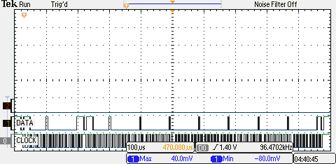

    i got problem with my code during testing. I made few functions for sigle and multiple read. I tested it and it was working fine. Then i move forward and add timer. Timer was also tested if it works ok by turning on diode in interupt routine and turning it off  in main loop. Then I add  single read to timer(works) and then multiread and it's not working - with this combination ( multiread in timer routine) single read is not working in main loop. So i remove i2c read function form timer and try to read i2c line in main loop without possitive result. During debugging first time i got error 0x10 I2C_MASTER_ERR_ARB_LOST 0x00000010, so i reset program and started debugging again, and there was no error (strange) and i cant read data form sensor again. Please look at the function below, maybe you will find that thing that i can;t see for now. For me it's very strange situtation because previously this function was working fine, but after i put it to timer service routine it stoped working and all program is not working. Also i attached all my project form workspace. Thank you for you help
    extern void i2c_multi_read(char address, unsigned data, unsigned repeat, volatile short tab[] ){
    unsigned long k=0,err=0,i=0;
    I2CMasterSlaveAddrSet(I2C1_BASE,address,true); //false
    I2CMasterDataPut(I2C1_BASE,data);
    I2CMasterControl(I2C1_BASE,I2C_MASTER_CMD_BURST_SEND_START);
    while(!I2CMasterBusy(I2C1_BASE));
    while(I2CMasterBusy(I2C1_BASE));
    I2CMasterControl(I2C1_BASE,I2C_MASTER_CMD_BURST_RECEIVE_START );
    tab[0]=I2CMasterDataGet(I2C1_BASE);//no dummy read - 1st read
    tab[5]=I2CMasterErr(I2C1_BASE);
    for(i=0;i<repeat;i++){
    I2CMasterControl(I2C1_BASE,I2C_MASTER_CMD_BURST_RECEIVE_CONT);
    //err=I2CMasterErr(I2C1_BASE);
    tab[i+1]=I2CMasterDataGet(I2C1_BASE);
    if (I2CMasterErr(I2C1_BASE)!=0){tab[5]=I2CMasterErr(I2C1_BASE);}
    I2CMasterControl(I2C1_BASE,I2C_MASTER_CMD_BURST_RECEIVE_FINISH);

  • Hello Matthew,
    If you are doing I2C reads in the Timer ISR and in the Main loop, then I would suggest to remove the Main Loop reads. It may be causing contention from I2C programming.
    I do not have the sensor as you mentioned so it would not be possible for me to debug the code.
    Amit

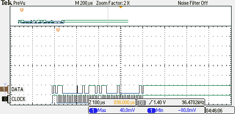

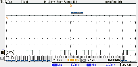

    i did it, still nothing. Now i got empty timer isr (only with diode) and function with single read in main loop. I'm trying to read all registers separetly. during every read i receive error - arb_lost. Could you check for me if my project is well setup ?
    Finaly i found that while(!I2CMasterBusy(I2C1_BASE)); may cause the problem. Still i got problem with signle read and multread outside main loop, and i have no idea what is going on. when i move out my function to Timer ISR or GPIO ISR i got error 0x10 which means arbitration lost. I took code form my function and put it inside GPIO ISR routine and in the main loop: i am able to read data when i'm in main loop, reading data from GPIO ISR (timer too) is imposible i got only error 0x10. Can you give me any suggestions?
    Same situation is with code posted by Ashira, i'm able to read data from sensor in main loop only.

  • Hello Matthew,
    I see there are two functions: i2c_read and i2c_multi_read. I would want to clarify the following from you
    1. Do both function cause an issue or only one of them cause an issue?

  • Hello Amit,
    i'm sending scope screen if you will need i can send you csv files also.
    I moved back to TIMER ISR and multiread. i can't read (multiread) anything from sensor when i trun launchpad on. Screen below is presenting what's happening on bus during read in timer isr
    So then i run CCs studio in debug mode and debug code - here single read to check if read value is right
    Next i let program to run in debug mode, stop for i while and i can see that sensor is being read (rigth values in registers). Next i exit debug mode and check if the sensor works- everytihng is fine, i can see on scope that its working and also i receive right values in uart. Below is some part of transmission
    Then i reset uC and it stops working - values i recived in uart are 0's, and on scope i can see this (1st posted  image)
  • Hello Matthew,
    I would suggest putting a GPIO to toggle high in the Timer ISR so that you can use it to capture the first set of I2C transactions. Looking at the scope capture it seems that there is something very early on that causes  Address to be NACK-ed by the slave.
    Amit
  • Hello Matthew,
    We would need a zoomed in scope plot of the I2C Address Phase when being run in Timer ISR.
    Amit
