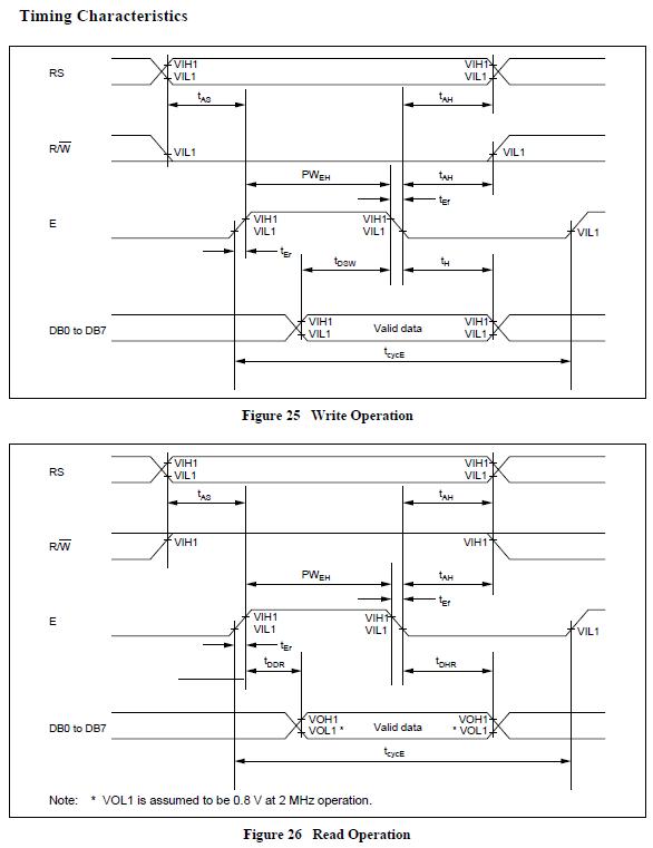

  • Note that as a long time purveyor of such character LCDs - these are most always 6800 MCU based.  Thus a R/W and E requirement - rather than I80's: /RD and /WR.  Months past - this very forum - I posted the timing abstract from Hitachi's original (HD44780 - lcd char cntlr) data manual.
    You thus require 3 control signals (2 if you never "read" the Lcd) and either 4 or 8 bits of data.  Application software floods the net...

  • To achieve a successful interface both the signal source and its target must be well known/described.  To that end - here is the spec for the "father" of most all LCD Character Displays.  (HD44780 begat many clones - and certain of these clones are more accepting of narrower strobes & set-up/hold timings...)  User must determine the fitness - however the signal shape & order is well reflected below...
    Note that the Character Lcd's "E" signal requirement must follow the RS signal and that data must remain stable both prior to and post the negative toggle of "E."
    In addition to this signal management - the Lcd Controller must be properly initialized - the 4 bit initialization is especially demanding - my suggestion is to avoid 4 bit until 8 bit has been well mastered...
    Armed with this signal requirement of your "target" - you can better search the signal delivery capability of your MCU - and devise the best/closest match...
