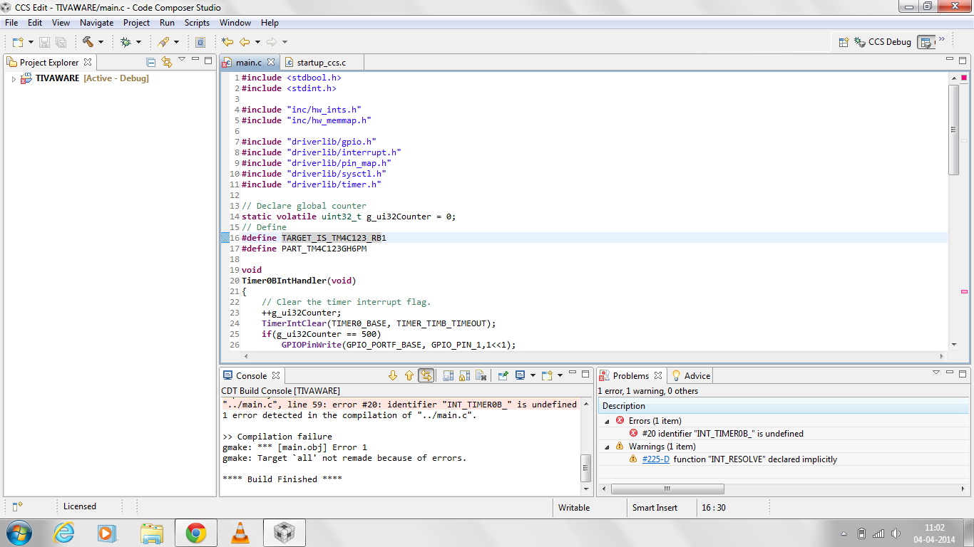

I am working with TM4C123GXL-Launchpad. While trying to run a interrupt code it is throwing up error
"INT_TIMER0B_" is undefined. Can anyone help me in which header file it s defined???

You have to use the define TARGET_IS_TM4C123_RB1 and PART_TM4C123GH6PM during compilation
Amit
Those defines should be set at your CCS Project Options -> Preprocessor Symbols.
-kel
You, should see the same Preprocessor Symbols settings at the other example programs.
