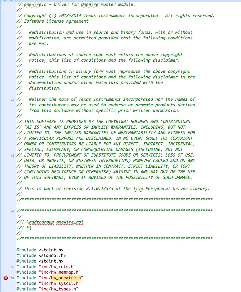

just playing around with the latest TivaWare on CrossStudio for ARM V3.0.
I wanted to compile a simple test application and hit an error poiningt out that 'hw_onewire.h' is not found in the inc folder.
It is included in onewire.c.
Were to find this file?
aBUGSworstnightmare
The onewire header and driverlib is scheduled for the next release of TIVAWare.
