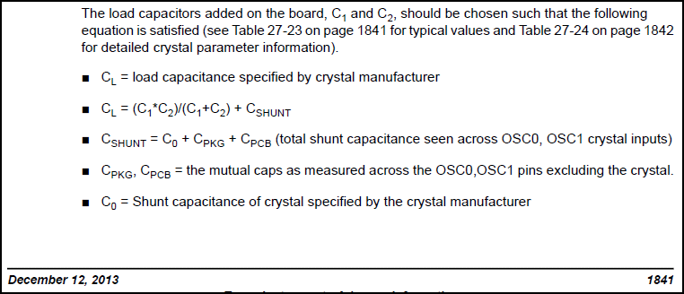

I think TI's Crystal cap. calcs for the TM4C129X are in error
This discussion has part academic value and part practical value.   I believe TI have made an error in their formula for CL, the load capacitance specified by the crystal manufacturer.   TI went to great lengths to list specific crystals from a variety of manufacturers for which TI provide calculated values of C(=C2 ).
To summarize, I have found NO Crystal manufacturer which requires you to use C0 (the crystal's shunt capacitance) when calculating C1,C2 from CL or visa versa.    You can search for yourself  for formulas online, and I am happy to copy excerpts from Statek and Abracon in emails they sent me stating this fact.    However see below for the formula given by TI as cut from p. 1841 of their datasheet which includes C0.
As long as your chosen crystal's Cis low enough (e.g. 1-2pF) then in practice the values calculated for C1=C2  are sufficiently similar to those obtained when excluding Cfrom the formula.  If Cis higher (e.g. I am using a crystal with C0=7pF) then the values calculated for C1=C2 are nearly half  (18pF c.f. 32pF for a given CL of 18pF) !   For some entries in table 27-24,  C0=3pF and the resultant values for C1=C2 are too low by about 6pf (i.e. 18pF c.f. 12pF).   This could be significant.
Because I want my oscillator to start up first time for the life of my product under all temperature and component tolerances, I wanted to ensure I had a good handle on this aspect of the design so this mistake in TI's formula has lead me to spend a LOT of time trying to make sense of it because I had put implicit trust in TI and initially didn't assume they were wrong.  One product recently in development in my company failed to reliably start oscillating and  either due to lack of knowledge or misinformation the electrical engineers gave up and opted to drive the OSC pins with an oscillator module instead !  That shows how important it is to ensure the formulas are correct.
Unless your crystal's C0 is >2pF then, you will probably never notice this error nor care about this discussion !

    Hi Roberto, thanks for your reply.  If you believe the formulae are correct, are you able to prove this by showing me at least ONE crystal manufacturer that publishes a formula which includes C?  On the contrary, each manufacturer I have looked up (at least 5-6 ) DO NOT include C0   in the formula they give you which means they take it into account themselves when you tell them what CL you need.    In fact Statek and Abracon replied to me and explicitly said Cis NOT in the formula they give us.

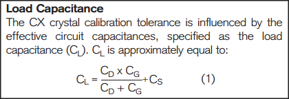

    Here is the formula from Statek http://www.statek.com/products/pdf/CX2SM_10135_RevC.pdf

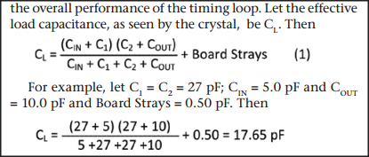

    Here is the formula from Abracon  http://www.abracon.com/Support/facn_abracon_jul2011.pdf
    Abracon's analysis concurs with Statek's excellent technical note, they write (on p. 3).
    There are at least three stray capacitances that must be considered in trying to calculate the load capacitance of the Pierce oscillator circuit
    1. An added capacitance from the input of the amplifier to ground.
    2. An added capacitance from the output of the amplifier to ground.
    3. A stray capacitance Cs shunting the crystal as shown in Figure 2
    Once again note how C0 is not included at all.  Cs nominated by Statek is the same as Abracon's "board strays".
    As I mentioned above if you can find even ONE manufacturer who includes C0 in their formula then I will be very impressed, but the following Google search has at least the first few hits not mentioning C0 at all !

    If TIs definitions and formula are correct why does it give us a totally  different result for CL, (the load capacitance specified by the crystal manufacturer) when compared to EVERY other formula for Cwe can find so far ?!

    The whole motivation for my post was to highlight a discrepancy between TIs value for Cand the values calculated by many other formulas from reputable crystal manufacturers .  By ignoring this error you are claiming for example that 18pF=32pF  !
  •  Peter, from data sheet:
    Parameter    Parameter Name                                             Min nominal max
    C1, C2      External load capacitance on XOSC0, XOSC1 pins  12pF           24pF
    CSHUNT  Total shunt capacitance                                                                 4pF
    CPKG Device package stray shunt capacitance
    CPCB  PCB stray shunt capacitance
    CSHUNT = CPKG + CPCB + C0 (total shunt capacitance seen across XOSC0, XOSC1)
    C1 and C2 are the values in pico Farads of the load capacitors that should be put on each leg of the crystal pins to ensure oscillation at the correct frequency. Rs is the value in kΩ of a resistor that is placed in series with the crystal between the OSC1 pin and the crystal pin. Rs dissipates some of the power so the Max Dl crystal parameter is not exceeded. Only use the recommended C1, C2, and Rs values with the associated crystal part.
     Your crystal require a 7pF load capacitor, has a parallel typical of 1pF and stray capacitances add about another pF in parallel, oscillator output is less than max so RA = 0
     Cshunt OSCILLATOR is near 2 pF from stray and crystal so it is OK with oscillator max Shunt
     Load caps need to be in the range of C1 C2, your crystal need 7 pF parallel resonance, subtract 1pF from stray and use C1= C2 series of two 12pF obtaining the correct load of 7pF.
     Resonator see a parallel Load capacintance of
    CL=(Cd*Cg/(Cd+Cg))+Cs => (12/2)+1 = 7pF as specified on data sheet.
      From where you can see 18=32???
     Again this value is low range so it can be better to select a crystal with load capacitance in the range 7.5-11.5pF...
     From this FORMULAE ARE CORRECT!!!!!
     I cannot figure where you got 32pF, value greater than 24pF or less than 12pF stop oscillation, wrong layout with greater than 4pF stop oscillator too.
     Exceeding max value at OSC pins stop oscillation, Pierce is not series resonant so wrong shunt capacitance on parallel resonant shift frequency!!!

    Not correct.   7pF is my crystal's SHUNT capacitance as per my original post.   Thus your calculations that followed were in error.
    Using TI's incorrect formula I calculate C1=C2=18pF as follows:
    CSHUNT = C0 + CPKG + CPCB  = (7 + 1.0 +1.0)pF = 9.0pF  (in my calcs I used slightly higher and more realistic values for CPKG , CPCB of 1.0pf rather than 0.5pF)
    furthermore
    CL = load capacitance specified by crystal manufacturer = 18pF for my crystal
    Another formula from TI datasheet:
    CL=C1*C2/(C1+C2)+CSHUNT
    (18-9)pF = C1*C2/(C1+C2) = 9pF
    as C1=C2 , then C1=C2= 18pF
    Now compare this to every other manufacturer's formula which EXCLUDES C0
    Specifically using Statek's formula
    CL=CD*CG/(CD+CG)+CS
    where (according to Statek) "CS is the stray shunt capacitance between the crystal terminal. CS should be minimized."  (If CS is supposed to also include the crystal's shunt capacitance (C0) as you and TI are claiming then how is the end user supposed to minimise that if they have no control over C?!?!
    CS =1.0pF +1.0pF = 2.0pF
    therefore
    18pF=CD*CG/(CD+CG) + 2.0pF , hence 16pF=CD*CG/(CD+CG)
    now as C= CG, C= CG=32.0pF
    Reprinting and highlighting the text from TI's datasheet doesn't suddenly mean it is correct information.  My claim is that the datasheet states incorrect information, namely that C0 (the crystal's shunt capacitance) should NOT be present in the formula for CL the load capacitance.
    Perhaps somebody from TI needs to step in and arbitrate or even defend their position (if possible).
