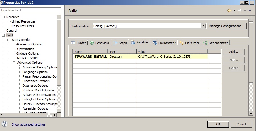

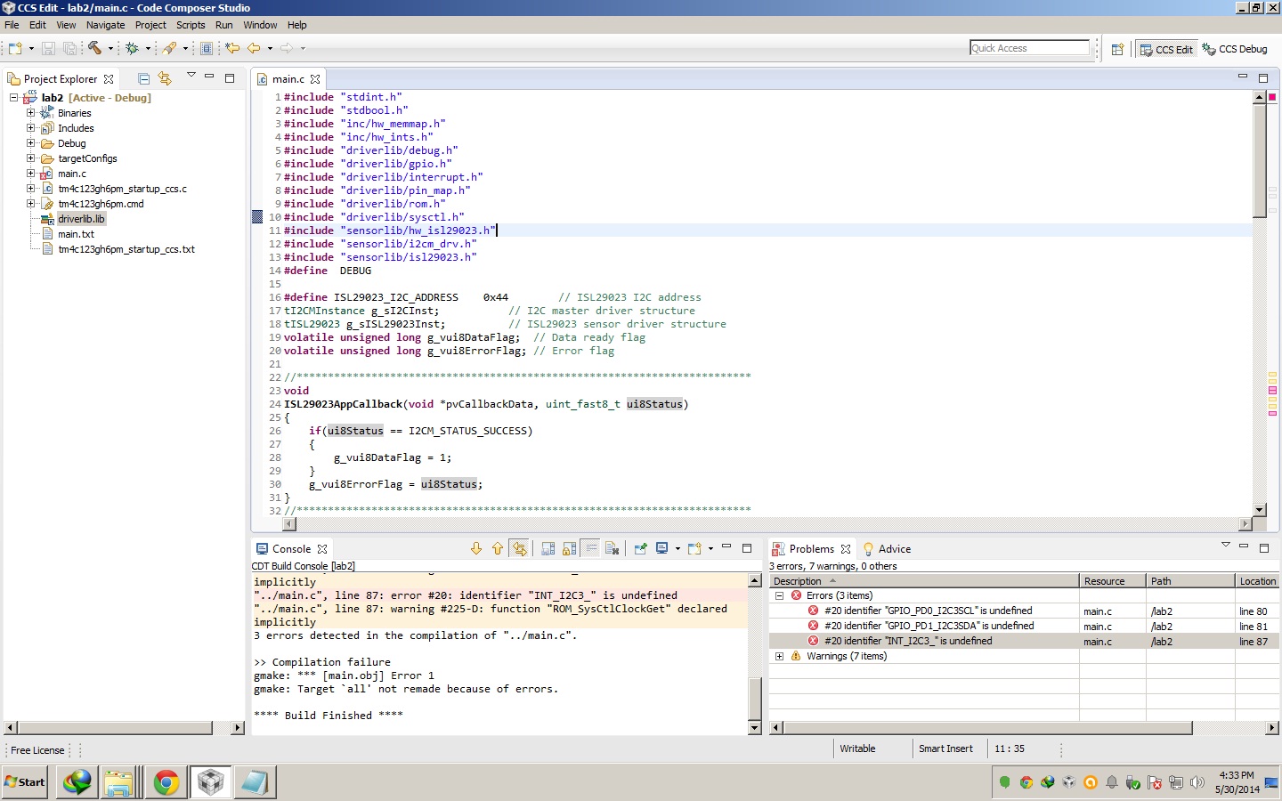

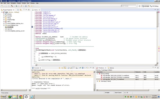

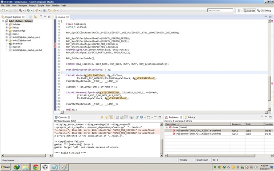

  • Thank you so much Amith. I was able to reduce one error but there still remains one more error.
    it says in the error box,
    #20 identifier "GPIO_PD0_I2C3SCL" is undefined
    I've attachd an image below. is there anything else taht i have not added or linked? I did everything as requested by the lab 2 of the worksheet to add the driver lib and other includes.
  • Hello Amalinda,
    My mistake. The define is PART_TM4C123GH6PM instead of PART_TM4C123GH6PMI
    Amit

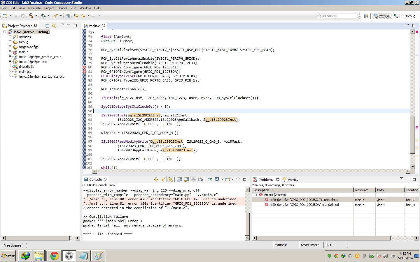

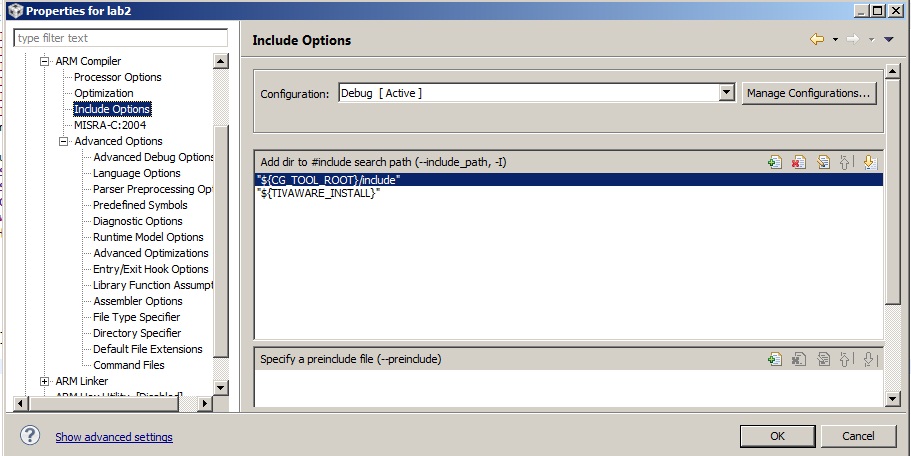

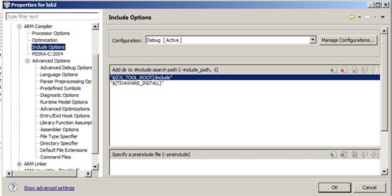

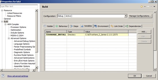

  • here are more details on the configurations
    PD0 alternates as I2C7SCL and PD1 alternates at I2C7SDA. Verify this at your device datasheet.
    -kel
  • Hello Kel,
    On TM4C123GH6PM the I2C3 are on PD pins.
    Amit
    He is using Tiva Connected Launchpad. See, the title of this post.
    -kel
  • Hello Kel
    OK.
    Hello Amalinda,
    Since you mentioned the TM4C123 example on a connected launchpad (which is TM4C129), can you confirm the device. Is it TM4C129 you are using and porting the TM4C123 example to it? If yes, then there quite a few changes required to the code!!! Along with the defines I have already mentioned
    If not then my response stands.
    Amit
