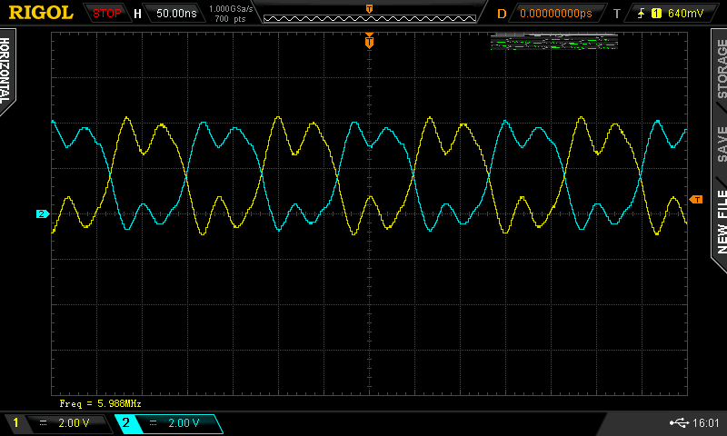

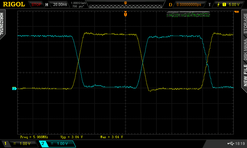

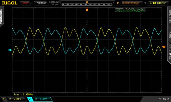

I have a problem with the TM4C1233H6PM and the USB communication on my custom board. I developed the USB software on the Stellaris/Tiva C launchpad where the software works fine. The custom board runs the same software with the same default settings for the USB timing parameters. I already checked the clock which is spot on to 16MHz  an the supply voltage which is also okay. I also couldn´t find any ripple or high frequency noise with the oscilloscope on the supplyrail.
The only difference I found were the  eyediagrams of the USb datalines. I atached two screenshots of the oscillopscope whrere I tried to investigate.
--> custom board
--> Stellaris Launchpad
I took both measuremnts direclty at the USB connectors of the boards. The traces on the Lauchpad and on my custom board have nearly the same lenght.
Maybe the amplitude of the signals on my custom board are to low to allow a stable communication. I hooked up debugger again and discoverd that the processor correctly received the datepackages. It seems to be that the USB core and the attached PHY is not able to transmit upstream packgages correctly.
How can I track down the issue or is there already a solution? The same problem occures when I connect my Launchpad to an USB hub.

  • Jannis,
    Is your hub powered? Would you please try launchpad with a powered hub? From the waveform, I assume that you are doing USB 1.0 full speed (12 MHz) device mode. Would you please measure the voltage on D+ and D- before they are connected to the host?

    the hub wasn`t powerd but I tried again with a powerd one. Now the Launchpad works fine with the powerd hub but my board didn´t. Somehow I missed to mention that the custom board is self and not bus powerd. The supply voltage on the VBus can not have any effects to the signal levels. Wherefore I measured the supply voltage directly at the pins of the TM4C. There is no issue with the supply voltage, I measured 3.28V. I also measured D+ and D-.
    D+ has 3.22V and D- 0.137V.
    Jannis
  • Jannis,
    It seems that the strength of USB signals becomes marginal when there is large capacitance loading. In your test code, can you use following API to read back the output buffer type of the D+ and D- pins and set them to 8mA output?
    GPIOPadConfigGet () to read the type of "strength" and GPIOPadConfigSet () to set the "strength". It should be done after configuring the pins to USB function.
    Thanks and regards,
    Zhaohong

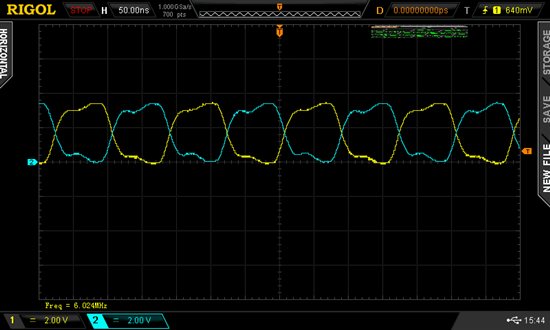

    today I followed your advice concerning the USB software and made another attempt to get the connection working. I also measured the USB data lines again. The quality of the signals was improved by changing the driver strength.
    Unfortunately the host controller stil fails to enumerate the device. Tomorow I'm going to test the board with another PC, maybe my PC is the problem. Beside of that I have no idea what might be the issue because signals' parameters appear to be fine, now.
    Jannis
