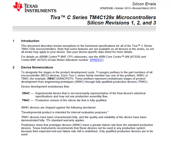

    BTW: Has TI shipped any higher silicon above Rev1 to anyone? Asking because the errata found in revision 1 silicon  PWM can not trigger ADC (SSS) start sample sequence and wouldn't you know it that effects motor control. The one Mouser shipped me is Rev1 silicon and can not be used to migrate M3 to TM4C. :(
  • Hello Brett,
    I checked and re-checked the TIVAWare installation and the path mentioned has only bl_config.h.tmpl which is the template file. Cortex-M4 is a 32 bit processor so bit's really do not make sense for Flash Erase. It complicates the device more than expected.
    Not yet. The release of the Production Version with this issue amongst some other will happen towards end of 2Q'14
    Amit
  • That was my bad, renamed (*.tmpl) figured was named (temp) by mistake, might explain why CCS5 suggests symbols not found during linking.  Attempting to migrate Boot_Eth project which links all BL c files from RDK v10636 where it had Ethernet transport assigned in bl_config.h . So far the only difference was bl_enet.c is now bl_emac.c , expected some issues in this area.
    The RDK Ethernet GUI allows flashing of the target from a *.bin file using FTP transport in BL. Hope that remains constant until finished moving a few RDK functions into the cloud, time sharing the Ethernet between web and original GUI or use GUI composer with ICDI might prove more prudent. Added CPU utilization into the cloud last night and found it not to difficult, do for see the collective growing beyond 542 near future.
    Not yet. _ This is odd news after seeing revision 5 silicon somewhere in documents at TI. Do you know if there is a work around for the errata PWM0 not able to trigger ADC0_1-3 SSS

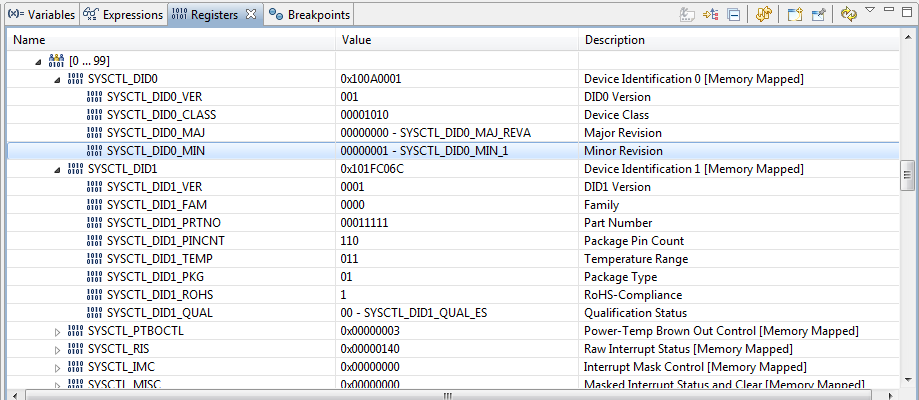

    Anyone interested this is where to find the revision level adding minor and major together.

  • Hello Brett
    Revision 5 would be on TM4C123. TM4C129 does not have a Revision-5

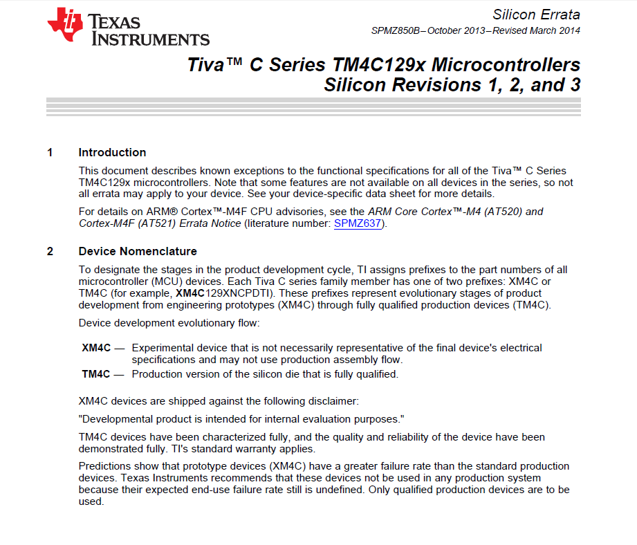

  • The TM4C1294 errata sheet suggest rev. 3 silicon is, has been in production. Unsure rev.1 will synchronize PWM counters when dividing SYSCLK @120Mhz. Using PWMDIV=%2 on PWM0 peripheral block, the 60Mhz clock renders 3000 ticks/sec. That alone introduce other issues when LM3S8971 50Mhz SYSCLK was used as the PWM clock with out PWMDIV. Mouser claimed were a brand new TI shipment of EK-TM4C1294Xl board, was fearful to find revision 1 chip. Have asked Mouser to ship a higher revision EK board as they could only provide the manufacture date which was later found to be March 2013, far existing from a new batch.
    Do you know if errata (yellow box) was random among certain production runs and may not effect all chips in revision 1 class? Would think testing for errata among production runs does not test every chip made, TI may only test 500 out of every 5K produced.
    Literature Number: SPMZ850B
    October 2013–Revised March 2014
  • Hello Brett,
    Revision-3 is not in production. And the errata marked in yellow is not random. It is very easy to reproduce.
    Amit

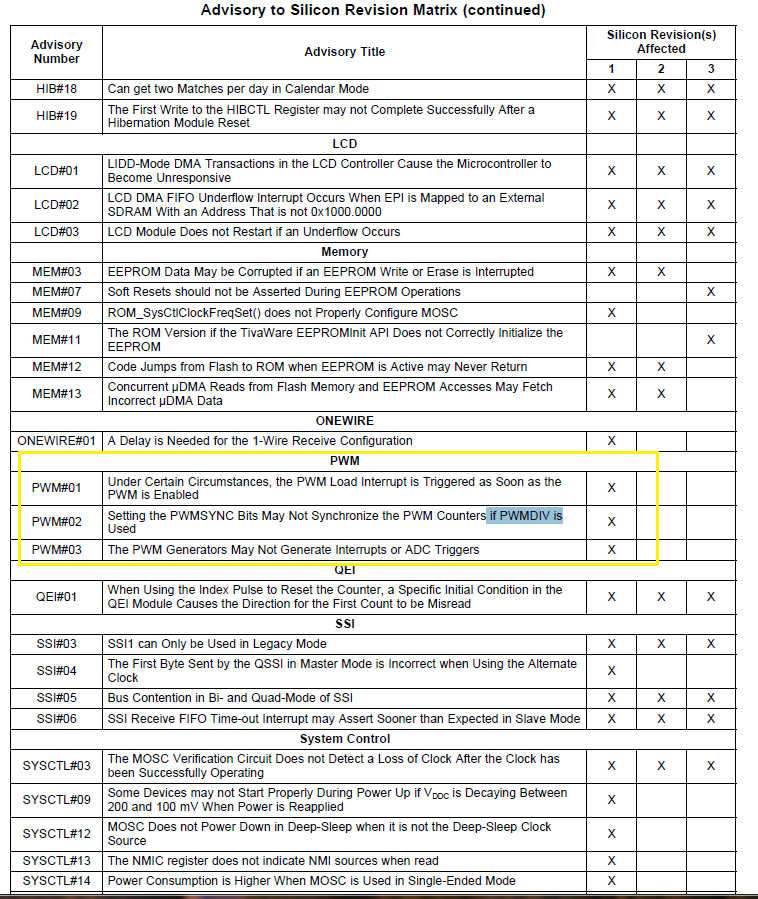

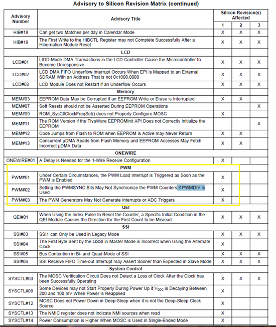

    That said - poster had effectively, "yellow highlighted" critical PWM errata - and employed the word, "random" - likely to convey his displeasure with the errata's imprecision.  Does not the errata employ bit of, (pardon) "weasel wording" - i.e. ("under certain conditions," and "may not Synchronize," and "may not generate!")
    What are those (undescribed), "certain conditions," and when/why may it, "not Synchronize," and when//why may it, "not generate" the much sought & specification matching, (i.e. normally expected) PWM behavior?
    Now you add that each/every such errata condition may be regularly caused (i.e. clearly repeatable) -  would not the sharing of such critical MCU data be of great value to your users?
    Failure to offer known data beyond, "certain conditions," and "may not" is neither comforting nor of hardly any practical use to your most dedicated, active, & (unfortunately) becalmed users.
    Amit you clearly are in no way the cause of this "erratic" errata - yet you're the one who may be able to share work-arounds and likely "guard-band" we hapless/struggling users!   Would you be so good as to look into a more "client friendly (i.e. bit more detailed) errata listing" - which less masks any/all actions we client users may take to minimize errata's harmful impact?  Thanks.
  • Hello Brett
    Version 3 is expected to be Production once we complete the full testing and characterization.
