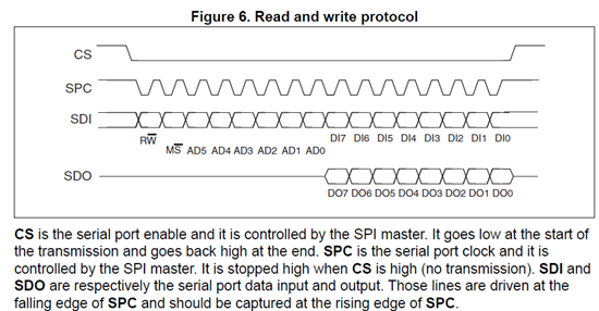

Hi. I have trouble with Tiva(TM4C123BH6PM)'s SSI interface.
I'm using STmicro H3LIS331DL accelerometer.
I set SSI frame format to Freescale Mode (SPH=1, SPO=1) in order to match the accelerometer's frame format.
I used the Tivaware SSI example codes. However, I changed the SSI control register to match this frame format.
-Data frame size = 16bit
-SSInClk = 2MHz (SysClk = 16MHz, CPSDVSR= 2, SCR = 3)
When the MCU communicates with this sensor, the RX value was only 0xFFFF
while changing the value of TX, The TX pin goes out correctly
with the wanted values(the sensor register addresses). Also the Fss and the Clock pulse was working fine.
What might be the problem?
Could it be soldering problems, difference of data order or SW problems?

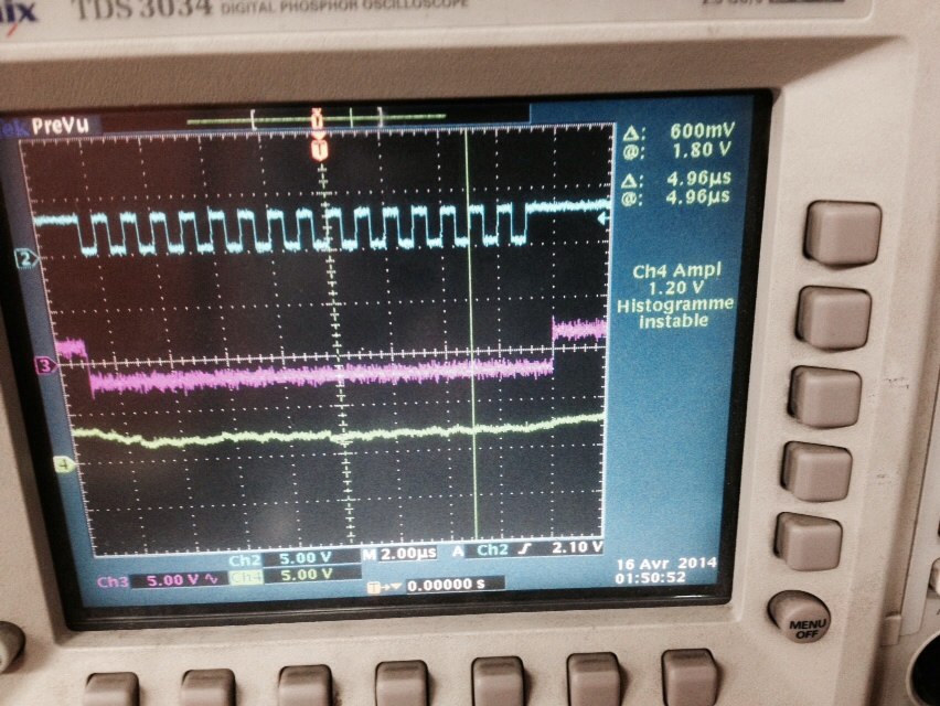

  • Hello Amit.
    My oscilloscope cannot show all 4 signals. One of the input was broken.
    Please understand the inconvenience.
    This is the signal of CLK, FSS, SDI(MCU TX).
    This is the signal of CLK, FSS, SDO(MCU RX).
    This is the signal of  SDO(MCU RX) only. It has a voltage drop.
    However, if we disconnect the sensor(taking it off using heat gun), it shows 0V.

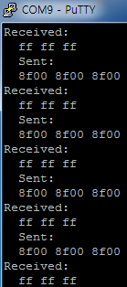

    Here's the source code. I used the Tivaware example code(SSI Master.c)
    and changed it to 16bit mode(SSI 1 module). The code sends the Who Am I register address.
    So the putty termial show like this.
    Is there some additional settings to be needed?
    Like do I have to right on the sensor's registers?
    Regards, Kim
  • Hello Kim,
    Looking at the waveform it seems OK from Master. The obvious question would be that is the Sensor still working fine? Can you rehook the same sensor to MSP430 and see if it works?
    Something more important as I was going through the code is that the PF0 Pin which is being used as SSIRX is a Locked Pin and cannot be changed to SSI Function by calling the GPIOPinConfigure and GPIOPinTypeSSI. It has to be unlocked by writing the UNLOCK code to the GPIO_LOCK register, then setting the GPIO_CR bit to '1' and then calling the GPIOPinConfigure and GPIOPinTypeSSI function.
    Secondly
    Amit
  • Hello Amit.
    I tested it with the MSP430F135 and it worked. In other words, the sensor was working properly.
    I'm using the example codes but I could not find the functions which unlocks the GPIO.
