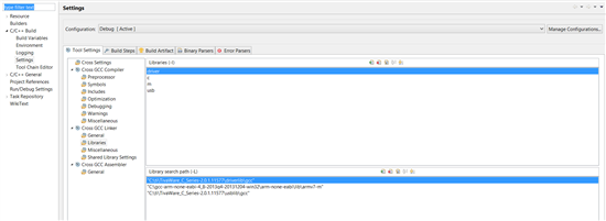

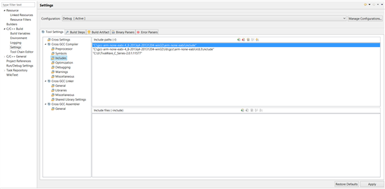

Greetings,
I am currently working on a personal project using Tiva Launchpad together with Eclipse Kepler IDE and GNU ARM Embedded Tools (gcc version 4.8.2). Last week my efforts were focused on making the "usb_dev_serial" example (Tivaware 2.0.1.11577) work with that development setup (also i'm using it all on Windows 8).
So far, a simple I2C master + button interrupt + LED toggling example I've made with this development configuration is working OK. When the USB module was added ("usb_dev_serial" skeleton added to my project), some compiling issues arised, but got fixed after I put "libusb.a" as resource library for the linking process. Unfortunately, some linking problems appeared (CDT build console exposed below):
C:\ti\TivaWare_C_Series-2.0.1.11577\usblib\gcc\libusb.a(usbdcdc.o): In function `HandleRequests':

  • Hello Amit,
    The "libdriver.a" file is included in my project (I've attached below a figure to show library current configurations for gcc linker).
    You need to add a path to usblib folder where reside files includded (like #include "usblib/usblib.h") - you compile the *.c files, but the path to *.h files is not specified - go to Cross GCC Compiler -> Include tab and place there the path.
    Petrei
  • Hi Petrei,
    The path for "usblib" folder is included (C:\ti\TivaWare_C_Series-2.0.1.11577) - added a screenshot below.
    But did you added to your main file all the needed 'includes'? I.e. besides #include "usblib/usblib.h", you need to add some more *.h files - compare with the example provided by TI ( usbcdc.h, usbdma.h, ...).
    Petrei

    Please check again the names of your libraries: while libdriver.a is a correct name(but check the path), usb library must be added too, it is in Tiva/usblib/gcc/libusb.a, yours has another name.
    Petrei
    Eclipse recognizes included libraries according to the post of this link:
    http://www.eclipse.org/forums/index.php/mv/msg/238028/734862/#msg_734862
    Paths are all checked. Just did a little sanity check: removed usb module from system, and the project compiles and links ok; after that I removed "libdriver.a" from gcc linker libraries and the project failed to link. Putting "libdriver.a" back (without USB code) the project compiles and links just fine.
    I agree with you, but in the first picture posted I can see all libraries linked by you - the last one is "usb" -if you have one with that name is OK, but in usblib/gcc/ the library there is libusb.a.
    So which one is good?
    Petrei
  • Hello Petrei,
    I've included the libusb.a declaring "usb" in the library window, Cross GCC Linker, as shown in the first figure. If I declare "libusb" in lib window, the gcc linker doesn't recognize the library and the build fails in the linking procedure.
    Same for libdriver.a, if I declare "libdriver", it won't be recognized. But declaring "driver", the program builds just fine.
    It seems you are blocked somehow - in this case the solution is to "think differently"- and in this case two steps can be taken:
    a) try to remove the usb library from the linking pane. But add the folder usblib to your project and compile it locally. Should solve most problems.
    b) improve your toolchain - add this plug-in: http://gnuarmeclipse.livius.net/blog/ - it provides a tight control of your project, many additional tools and remove some problems with path management, especially in Windows.
    Petrei
