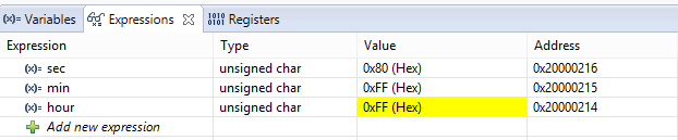

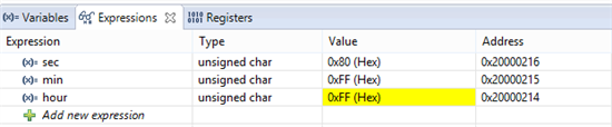

I want to interface DS1307 with TIVA C LM4C123GH6PM. I write this code but if i am read second,hour,min,year all have the same value=255,i can,t not understand what is the problem with it.
-darshan

int main()
unsigned long sec=3,min =21,hour = 4,day = 7,date = 20,month = 4,year = 14;
unsigned char Last_Value = 1;
SysCtlClockSet(SYSCTL_SYSDIV_1 | SYSCTL_USE_OSC | SYSCTL_OSC_MAIN | SYSCTL_XTAL_16MHZ);
//InitConsole();
SysCtlPeripheralEnable(SYSCTL_PERIPH_I2C0);
SysCtlPeripheralEnable(SYSCTL_PERIPH_GPIOB);
SysTickPeriodSet(SysCtlClockGet());
SysTickEnable();
GPIOPinConfigure(GPIO_PB2_I2C0SCL);
GPIOPinConfigure(GPIO_PB3_I2C0SDA);
GPIOPinTypeI2C(GPIO_PORTB_BASE, GPIO_PIN_2 | GPIO_PIN_3);
GPIOPinTypeI2CSCL(GPIO_PORTB_BASE, GPIO_PIN_2);
//GPIOPinTypeI2C(GPIO_PORTB_BASE, GPIO_PIN_3);
I2CMasterInitExpClk(I2C0_MASTER_BASE, SysCtlClockGet(), false);
I2CMasterSlaveAddrSet(I2C0_MASTER_BASE, SLAVE_ADDRESS , false);
I2CMasterControl(I2C0_MASTER_BASE, I2C_MASTER_CMD_BURST_SEND_START);
I2CMasterDataPut(I2C0_MASTER_BASE, 0x00);
//while(!(I2CSlaveStatus(I2C0_SLAVE_BASE) & I2C_SCSR_RREQ));
while(I2CMasterBusy(I2C0_MASTER_BASE));
I2CMasterDataPut(I2C0_MASTER_BASE, dec2bcd(sec));
I2CMasterControl(I2C0_MASTER_BASE, I2C_MASTER_CMD_BURST_SEND_CONT);
I2CMasterDataPut(I2C0_MASTER_BASE, dec2bcd(min));
I2CMasterDataPut(I2C0_MASTER_BASE, dec2bcd(hour));
I2CMasterDataPut(I2C0_MASTER_BASE, dec2bcd(day));
I2CMasterDataPut(I2C0_MASTER_BASE, dec2bcd(date));
I2CMasterDataPut(I2C0_MASTER_BASE, dec2bcd(month));
I2CMasterDataPut(I2C0_MASTER_BASE, dec2bcd(year));
I2CMasterControl(I2C0_MASTER_BASE, I2C_MASTER_CMD_BURST_SEND_FINISH);
while(1)
I2CMasterSlaveAddrSet(I2C0_MASTER_BASE, SLAVE_ADDRESS , true);
I2CMasterControl(I2C0_MASTER_BASE, I2C_MASTER_CMD_BURST_RECEIVE_START);
sec = I2CMasterDataGet(I2C0_MASTER_BASE);
I2CMasterControl(I2C0_MASTER_BASE, I2C_MASTER_CMD_BURST_RECEIVE_CONT);
min = I2CMasterDataGet(I2C0_MASTER_BASE);
hour = I2CMasterDataGet(I2C0_MASTER_BASE);
day = I2CMasterDataGet(I2C0_MASTER_BASE);
date = I2CMasterDataGet(I2C0_MASTER_BASE);
month = I2CMasterDataGet(I2C0_MASTER_BASE);
year = I2CMasterDataGet(I2C0_MASTER_BASE);
I2CMasterControl(I2C0_MASTER_BASE, I2C_MASTER_CMD_BURST_RECEIVE_FINISH);
tsec = bcd2dec(sec)&0x7f;
tmin = bcd2dec(min);
thour = bcd2dec(hour)&0x3f;
tday = bcd2dec(day);
tdate = bcd2dec(date);
tmonth = bcd2dec(month);
tyear = bcd2dec(year);
/* if(Last_Value != tsec)
UARTprintf("%02d:%02d:%02d \n%02d %02d/%02d/%02d\n",thour,tmin,tsec,tday,tdate,tmonth,tyear);
Last_Value = tsec;
tsec = 0;
