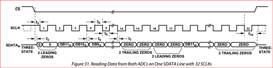

We are communicating with a remote SPI ADC device from a Tiva TM4c129X chip. We have configured the Tiva board to read one 16bit frame continuosly (at the sampling frequency rate) in 512 samples blocks via uDMA, with a pingpong buffer without effort.
Our objective is to be able to read two adcs channels to get stereo processing, to do that we need to read a frame with this format:
However, SSI on Tiva only accepts 16-bit frames, so it we cannot read the frames the same way we are doing it now.
We know we could set a GPIO as CS line, and control it manually, but then we would lose the implementation with the dma, so we would have an interrupt for every sample we get, having a large overhead of processor time, which we cannot “afford”.
Is there any register+udma setting that could allow us to do this?
Also, could the frame be “cut” in the middle, receive it via dma and arrange it later into two samples?
