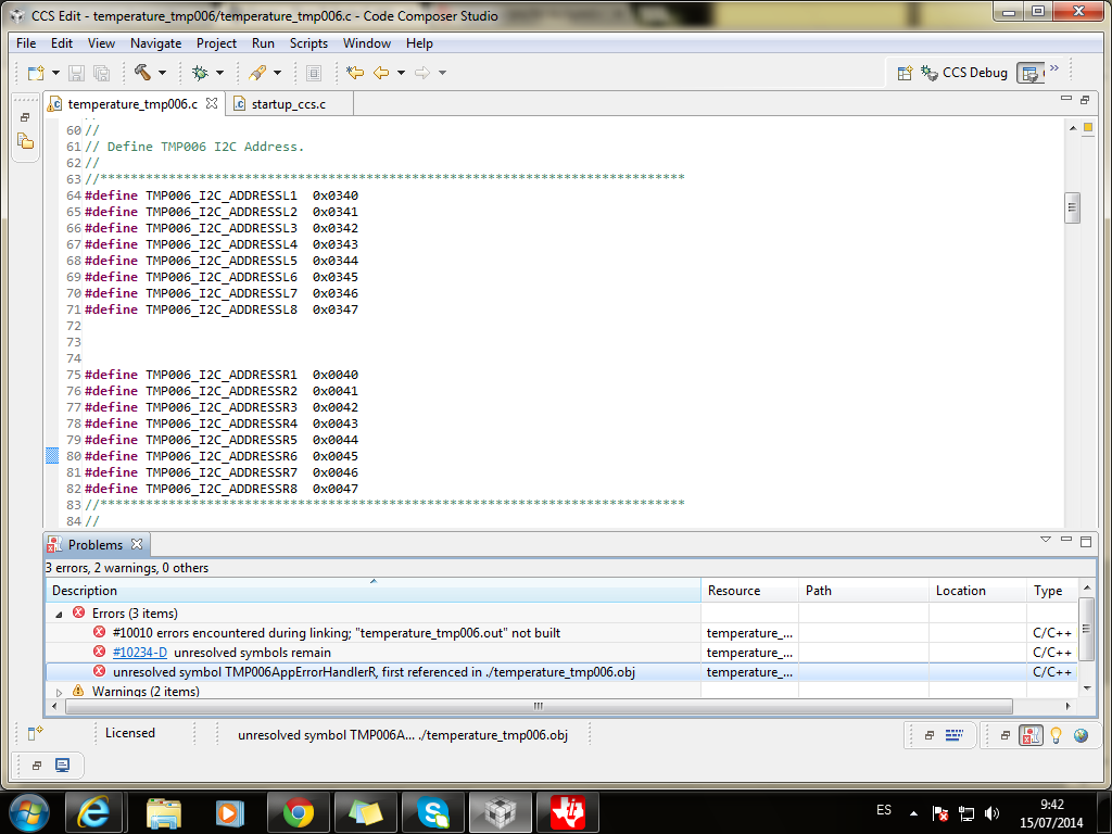

  • I modified defined as I suggested, however mistake me marks, any option for this? :(
        The first referenced error means that TMP006AppErrorHander() have been defined at two or more C files. Also, possible that you have CCS settings that is causing this.
        When you import the temperature_tmp006 example program to CCS, it should compile without errors. Did you do anything that is unusual?
    - kel
