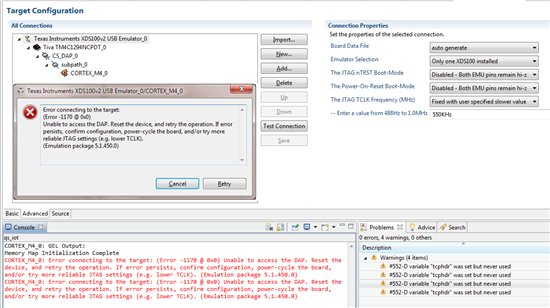

Tiva EK-TM4C1294XL fails to flash during debug with ICDI or JATG.
Guru 55913 points
Other Parts Discussed in Thread: CCSTUDIO, LM3S8971
XM4C1294NCPDT after several memory flashes suddenly decides to no longer transfer bytes at the MPU emulator level. As yet have never flashed any SW or unlocked any GPIO port C JTAG 0:3 however pins C7, C4 have been set as analog comparator input pins. The application is flashing the LED's and talking on UART0 to COM3 and a GUI can connect to the target on the Ethernet.
Anyone have some ideas to what might be happening?
The XDS100V2 passes all loop back tests while the ICDI crashes CCS5.4 upon canceling the failed connection of the DAP though a JTAG connection skips the crash event of (DebugLib.dll). Reinstalled the CCS5.4 Debug server and Stellaris simulator packages did not help. JTAG test

Seemingly this behavior occurred after making WatchDog0 and uDMA  peripherals present/sleep in the current configuration. The only call to Port C is made in high nibble binary shown below, we can rule that out.
ROM_GPIOPinTypeComparator(GPIO_PORTC_AHB_BASE, GPIO_PIN_7 | GPIO_PIN_4);
Window7 application logs the crash event: Faulting application name: ccstudio.exe, version: 0.0.0.0, time stamp: 0x4d87abff, Faulting module name: DebugLib.dll_unloaded, version: 0.0.0.0, time stamp: 0x50ec252b Exception code: 0xc0000005 Fault offset: 0x68f8a92d, Faulting process id: 0x1550, Faulting application start time: 0x01cf600d2ef99b47,Faulting application path: D:\CCs54\ccsv5\eclipse\ccstudio.exe, Faulting module path: DebugLib.dll, Report Id: 20bae081-cc01-11e3-bca7-00d0b7062877.

    Thanks for the details. The usual "suspects" can be ruled out.
    1. JTAG Connection Test uses the BYPASS JTAG Command to check if the JTAG Chain is OK. This is a condition to check if the device on the board is well connected on JTAG. However it does not mean that DAP can be accessed.
    "Seemingly this behavior occurred after making WatchDog0 and uDMA  peripherals present/sleep in the current configuration"
    Can you send a code snapshot of what was additionally done?

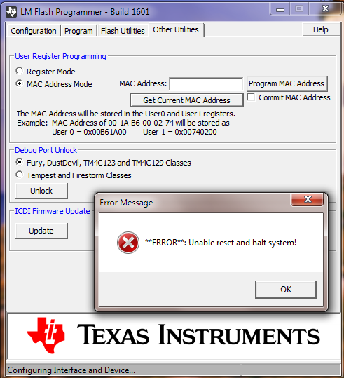

    Yes. If the DBG1 is not equal to 1 and DBG0 is not equal to 0, then it would block the JTAG. This is a commit register, so it has to be committed to flash. Else on the next power up the register will revert to the reset value.
    However you can still run "Unlock Sequence".
    Amit
  • Question is what on Earth tripped (BOOTCFG) register bits from the reset values and also commit to flash?
  • Hello BP101,
    I think the only way we can do that now is to unlock the part and reload the code and set a watchpoint on the register access.
    Amit

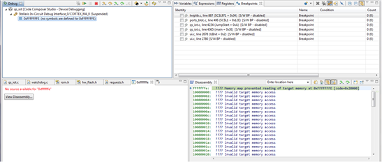

    I tried flashing Tivaware 5kb SWBL  again this morning using LMF. The Stellaris 4kb SWBL would look for the application interrupt vector table copied to SRAM 0x2000.0000. We would always flash the application above the SWBL to offset 0x0000.1000 for past Stellaris SWBL.  Attempted to allow for a larger Tivaware SWBL and loaded application flash offset 0x0000.1388  or decimal 5k, without the decimal points shown here.
    Seeing the very same results. The SWBL never finds the interrupt vector table of the copied application from flash into low SRAM 0x0000.0000. Relocation of the PC in CCS5.4 debug 0xFFFF.FFFE is not noticed when just the SWBL is loaded hence why I added the (BOOTCFG) lines above posting.
    Once the application offset is flashed the PC is relocating or jumping to address 0xFFFF.FFFE as previously reported, even while using LMFlash with the higher or lower offset application addresses. This happens with or without the added code in the post above.
    When the Tivaware SWBL is step debug in CCS5.4 it appears to be functioning correctly jumping into a reset after failing to find the interrupt vector table or symbol (main) presumably at SRAM 0x2000.0000. Even tried to set the application offset address to 0x0000.1004 getting same results. Either way in my opinion  LMFlash 6.01 being used to load both the SWBL and the application is ruling out CCS5.4 (Debug_server.dll) being the primary suspect.

  • BP101 said:
    interrupt vector table copied to SRAM 0x0000.0000.
    Does not SRAM begin (as you later note) @ 0x2000.0000?  I've not known SRAM to reside @ 0x0000.0000 - as you imply!

    BP101 said:
    Wonder if that ROMBL code gets deleted when unlocking the DAP?
    ROM getting deleted - not too likely - mon ami.  (and you must know this...)
