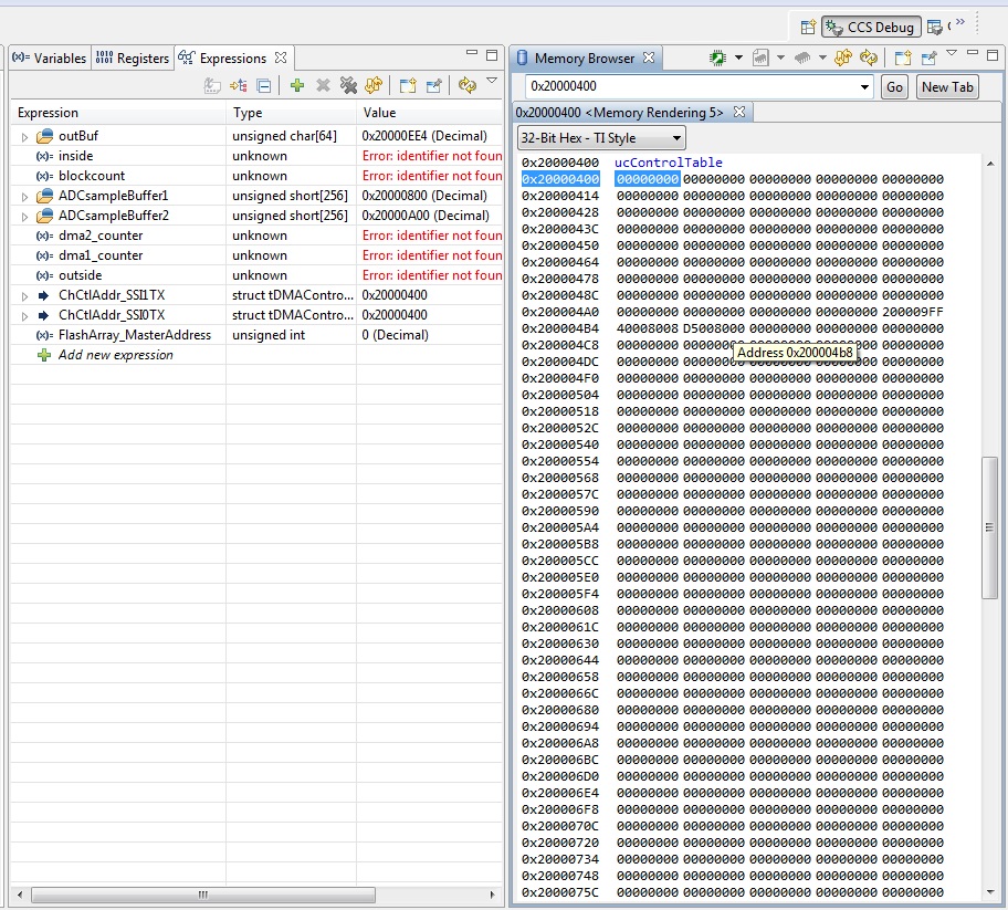

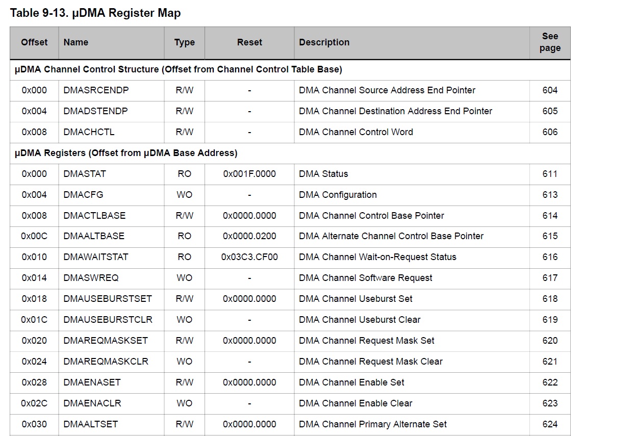

  • Could you elaborate on how to read the UDMA_CTLBASE (it doesn't seemed to be defined in my project) and where you got the (0x10*11)+0x08?  Is that from the DMA control table?
    I see in the datasheet it says that the dma register addresses given are relative to the dma base address of 0x400F.F000.  Is that the UDMA_CTLBASE address?  I'm a little confused because 0x10 * 11 is (0x10)(0x0B) is 0xB0 which I can't find that address in the data sheet dma registers section.  In looking at this register 20 is 0x04C and then it jumps to 0x500.
    I'm assuming the 0x08 comes from the data sheet in the pic below:
    My control table looks like this:
    // The control table used by the uDMA controller.  This table must be aligned
    // to a 1024 byte boundary.
    #if defined(ewarm)
    #pragma data_alignment=1024
    unsigned char ucControlTable[1024];
    #elif defined(ccs)
    #pragma DATA_ALIGN(ucControlTable, 1024)
    #else
    unsigned char ucControlTable[1024] __attribute__ ((aligned(1024)));
    #endif
    but I'm not sure how I find the address of that 1024 byte table and then modify it.
    ** Also do i need to use this call as well?
    uDMAChannelDisable(UDMA_CHANNEL_SSI1TX);
  • Hello Robbie,
    It is the register at offset 0x008 (UDMACTLBASE) and is defined in the hw_udma.h
    The equation is from the DMA Control Base Table and can be used to access the same in the SRAM ina generic form as
    Source Address Pointer = (0x10*N)
    Destination Address Pointer = (0x10*N) + 0x004
    Control Word Address Pointer = (0x10*N) + 0x008
    where N is the channel on which the DMA Request is Mapped (0-31 are the valud values).
    Also do keep the channel disabled.

  • Hey Amit,
    I had to spend last night and today studying up on the DMA but now I understand.  I'll show you what I am doing to see what you think because I'm still not having any luck.
    After I send out a block of data to memory over DMA SSI0 I run this code to switch over to SSI1 DMA:
    					// Reconfigure DMA for SSI1
    					SSIDMADisable(SSI0_BASE, SSI_DMA_TX);
    					ResetDMA_SSI0TXChannelControl(ChCtlAddr_SSI0TX);
    					uDMAChannelDisable(UDMA_CHANNEL_SSI0TX);
    					SSIDMAEnable(SSI1_BASE, SSI_DMA_TX);				// Enable DMA for SSI0 TX
    					uDMAChannelControlSet(UDMA_CHANNEL_SSI1TX | UDMA_PRI_SELECT, UDMA_SIZE_16 | UDMA_SRC_INC_16 | UDMA_DST_INC_NONE | UDMA_ARB_4);
    The function:
    is this:
    void ResetDMA_SSI0TXChannelControl(tDMAControlTable * base){
    	tDMAControlTable *psCtl;
        // Get the base address of the control table.
        psCtl = base;
        // Clear UDMACHCTL word in table
        //psCtl[(0x10*11)+0x08].ui32Control = 0x00;
        psCtl[(11)].ui32Control = 0x00;
    and I am passing it this:
    tDMAControlTable *ChCtlAddr_SSI0TX;
    tDMAControlTable *ChCtlAddr_SSI1TX;
    ChCtlAddr_SSI0TX = 0;
    ChCtlAddr_SSI1TX = 0;
    	// Configure DMA for SSI
    	SysCtlPeripheralEnable(SYSCTL_PERIPH_UDMA);
    	uDMAEnable();
    	uDMAControlBaseSet(ucControlTable);
    	ChCtlAddr_SSI0TX = (tDMAControlTable *)HWREG(UDMA_CTLBASE);		// ****** DEBUG *********
    	ChCtlAddr_SSI1TX = (tDMAControlTable *)HWREG(UDMA_CTLBASE);
    Just so you can see where that variable is coming from.  The "ChCtlAddr_SSI0TX" variable is the address of the DMA control table.  I can verify this below:
    In the expressions window you can see the two variables ChCtlAddr_ssI1 and SSI0TX that hold the value 0x20000400 which is the the address of the dma control table.  In the memory browser you can see that that address really is the ucControlTable as described in my code like this:
    #if defined(ewarm)
    #elif defined(ccs)
    #else
    #endif
    Now the address we talked about above is the 11'th row basically which is a structure defined in the UDMA.c file and looks like this.

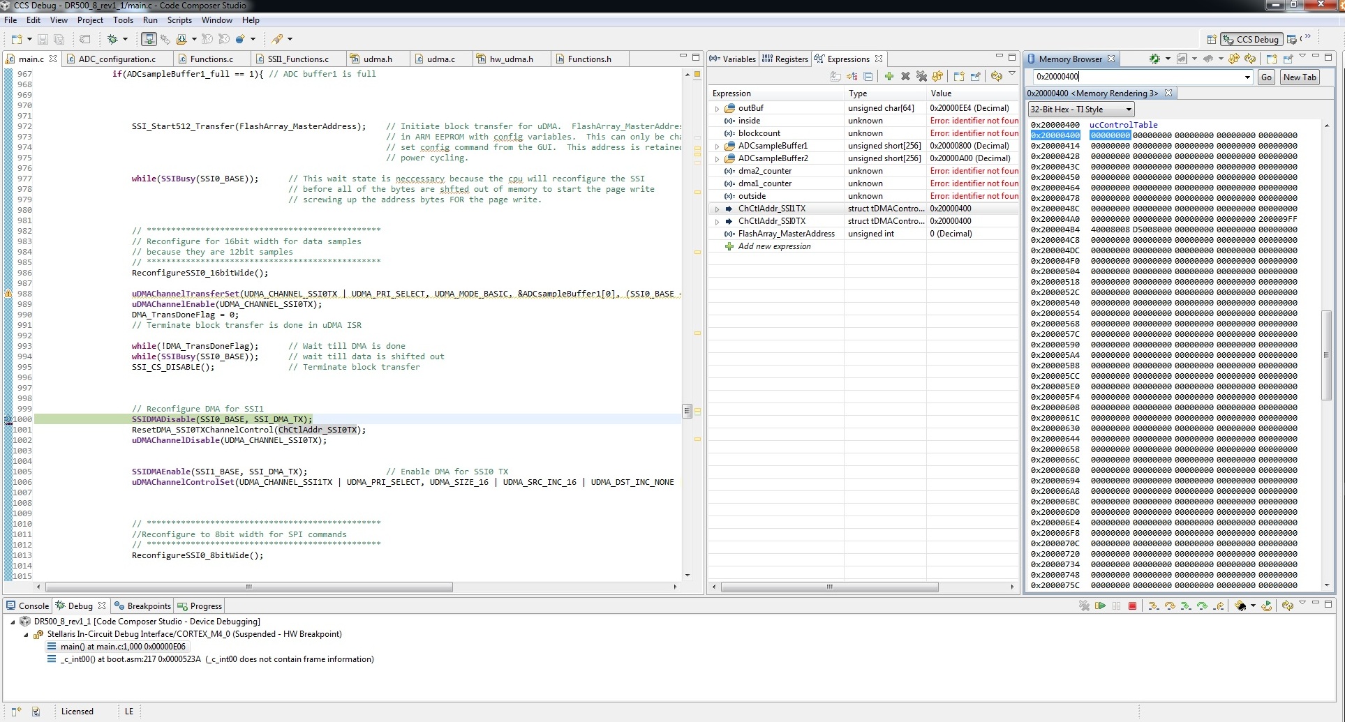

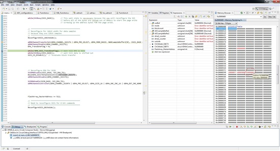

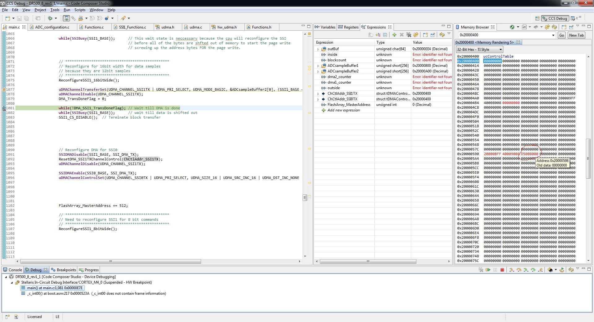

    So what I did was get the address of that table and pass it to my function that resets the channel control word (function shown above).
    This instruction:

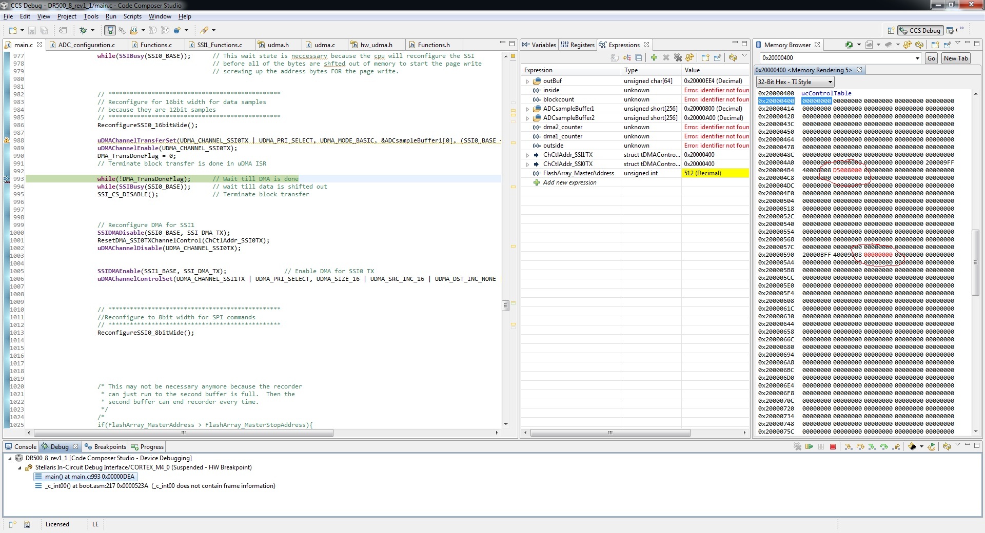

    in that function erases that word.  psCtl holds the address of the table and I then move down 11 times (or move down 11 of the tDMAControlTable structures) to get to the one for SSI0 and use dot notation to clear word 0x08.  I am confident this is what you recommended above.  Using your numbers I get a memory address of B8 for the channel control word I need to clear because (0x10*11) + 0x08 = (16*11) + 8 = 184 in decimal.  This would be the offset from my control table address.  Adding these two together I get a total memory address for the dma channel control word I need to clear as 0x200004b8.  Below are the values loaded in memory for this address in the control table just to verify.
    My cursor is hovering over the word D5008000 which is the above mentioned memory address.  So, at this point it looks like the channel is configured correctly.  If you run those same calculations for SSI1_TX (which is 0x10*25)+0x08 away you get an address of 0x20000598 which is zero in the above pic so that channel is completely zero'd out.  Now after reconfiguring with my reconfigure function that clears the SSI0_TX control word and configures the SSI1_TX control word I get this:
    I've circled the address in red, but as you can see with the mouse hovering over 0xD5008000 I get the correct memory address using the calculations of (0x10*25)+0x08 as I used the first time just applied to SSI1_TX this time.  Now If I run to the first break point again where they are supposed to swap back I get this:
    I've again circled the two respective control table channel address words that I'm supposed to be clearing and reconfiguring and it looks like this is working fine.  The entire word is cleared and reconfigured.
    Unfortunately this work-around still is not working though.  As before if I run 1 channel at a time my data is consistent and none of the blocks pushed out by the DMA get dropped.  If I added in the second SSI/DMA it goes right back to dropping blocks of data that the dma is supposed to be pushing out and it is not always the same amount of blocks.  I am fairly confident this is the eratta problem because any data that is dropped is ALWAYS dropped in 512 byte blocks which is what the DMA is supposed to be moving.  I'm also confident I'm clearing the correct data in the control table because the channel control words are the same and that makes sense because the channel control set function configures them exactly the same parameter wise.
    This is more of a status update to show you the results of our last few posts.  It was a great idea and I know understand how the DMA works much better lol but I'm still stuck.  I don't have a particular question at the moment as I'm still modding/debugging and running the code to try to glean more insight out of this, but I wanted to get you these results fairly quickly in case you had some other ideas.

    After executing the above code I then configure SSI1
    That configures SSI1 Channel.  When I break into the state where I send out data over SSI1 I send data then reconfigure back to SSI0:
    					// Reconfigure DMA for SSI0
    					SSIDMADisable(SSI1_BASE, SSI_DMA_TX);
    					ResetDMA_SSI1TXChannelControl(ChCtlAddr_SSI1TX);
    					SSIDMAEnable(SSI0_BASE, SSI_DMA_TX);
    					uDMAChannelControlSet(UDMA_CHANNEL_SSI0TX | UDMA_PRI_SELECT, UDMA_SIZE_16 | UDMA_SRC_INC_16 | UDMA_DST_INC_NONE | UDMA_ARB_4);
    Basically the same function to clear the channel control set table.

    The big difficulty for me was figuring out that this simple code would work.  In a complex system not knowing exactly what to do makes it difficult to debug run time errors which is what was killing me.  One big key for me was spending time to understand the channel control table.  Understand it!  It makes things easier.  Also understand that this:
    Sets the address of the table into a point basically (I think but I'm not a pro here so someone correct me if I'm wrong), but it just loads the address of the table into another memory address.  This is very handy because you can access the register that this function call stores the table address in to GET the address of the table and store it in a pointer.  After this check out the typdef that defines the table...
    typedef struct
        // The ending source address of the data transfer.
        volatile void *pvSrcEndAddr;
        // The ending destination address of the data transfer.
        volatile void *pvDstEndAddr;
        // The channel control mode.
        volatile uint32_t ui32Control;
        // An unused location.
        volatile uint32_t ui32Spare;
    tDMAControlTable;
    This defines a table entry.  If you do what I did you can grab the address of the table, stick it in a pointer and use that structure to access the elements in each row basically.  For reference check out what TI does to load data into a table channel row.
    11 and 25 are the address offsets in the table for SSI0_TX channel and SSI1_TX channel.
