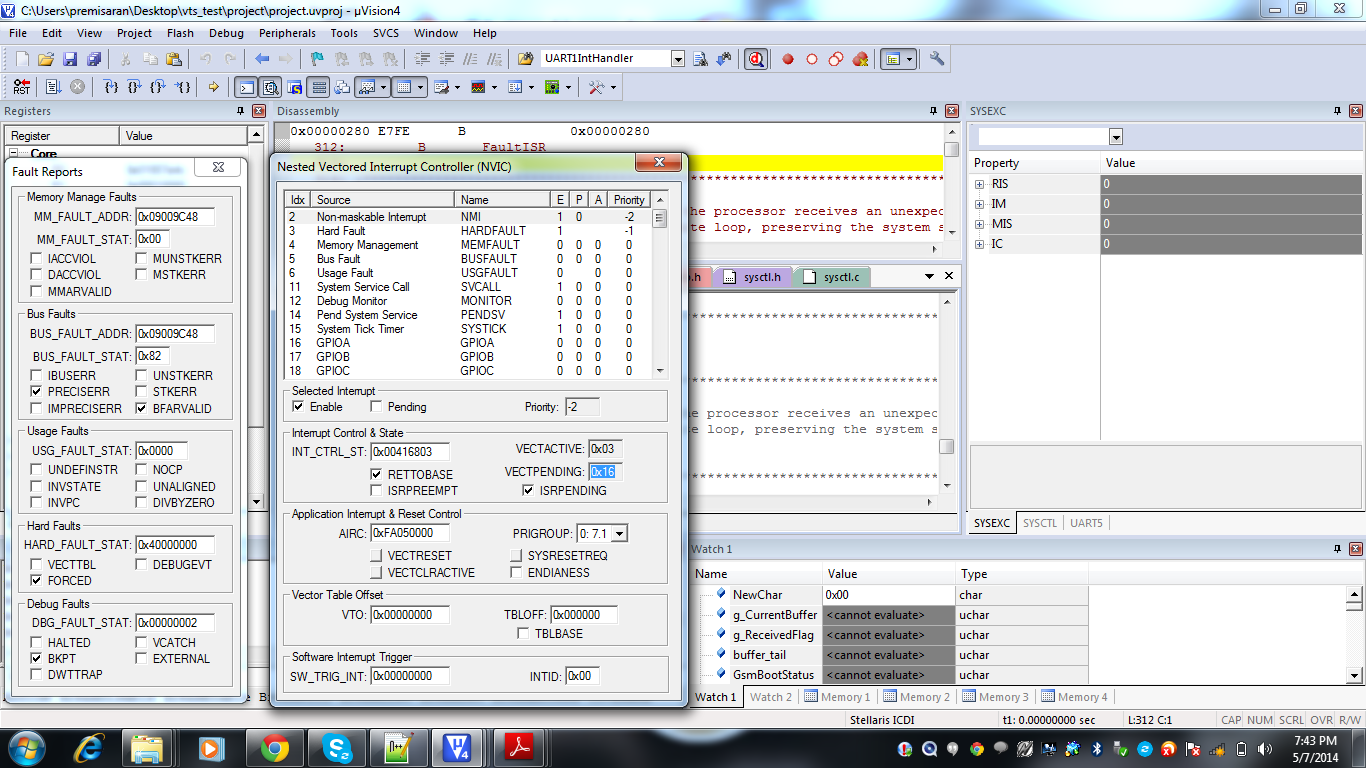

    i figured out the issue the controller is going to FAUT ISR and i saw the fault report  seems to be bus error. This happening immediately when the uart5 is initialized as interrupt. Actually no problem in uart 1, were i have mention in the above query.
    Bus fault typically happens when you have not enabled the clock to the peripheral and try to access it.  Be sure to enable the UART5 peripheral before accessing any of the registers.
    -c

    while configuring uart5 i am getting this bus error. plz find the attachement of the fault report.
  • Hello Mahedran
    A code post would be useful. However to check it yourself the following is something you may want to check
    1. The NVIC_FAULTADDR register. If it contains an address like 0x4XXXXXXX then it means that the Clock to the corresponding peripheral is not enabled
    2. Look up the Memory Map for this address 0x4XXXXXXX and check which peripheral it is corresponding to and then check if the SYSCTL PP and RCGC register-bit for the peripheral is set or not?
    Amit

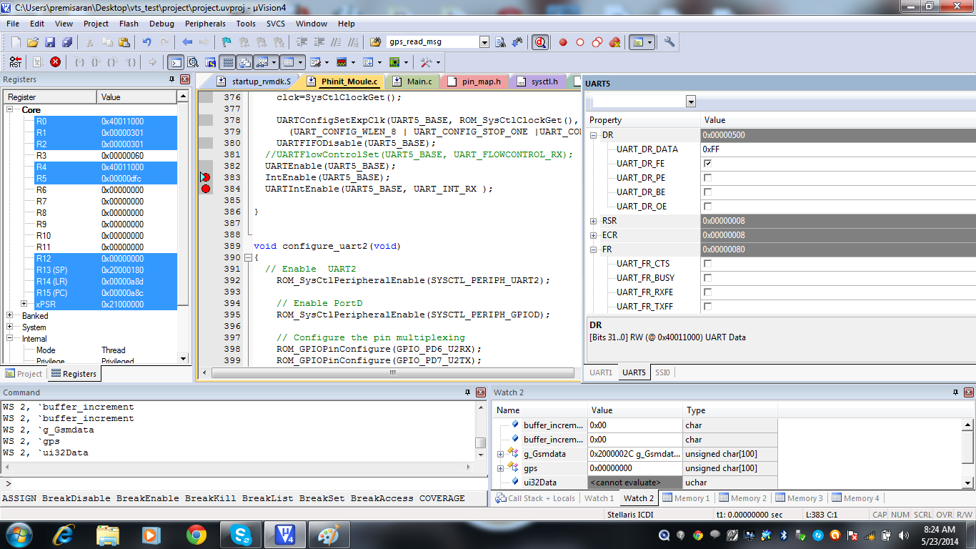

  • hi,plz find the code for the uart 5 configuration, while debugging when cursor reach the  ROM_IntEnable(INT_UART5); it goes to fault isr. i captured the falut report which i have sent in the previous post.

        ROM_IntEnable(INT_UART5);   // while debugging when the cursor reach this place its going to fault isr

  • Hello Mahendran,
    I think the issue is that in the snapshot the IntEnable(UART5_BASE) is used instead of IntEnable(INT_UART5). Can you please correct the same?
    Amit

  • Hello Mahendran
    Please check my last post
    IntEnable(UART5_BASE);
    to be replaced by
    Amit
  • hi amith,
    thanks for pointing out the issue. i will check and let u know the result
  • hi amith,
    thanks the problem is resolved. uart 5
