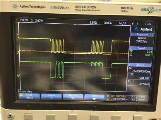

  • Hi Amit,
    Thank you for the help! I did use that line that you recommended me to use and I checked it out with the oscilloscope. I attached two pics of it. But I am still not able to get data from my sensor. How do i get the data from my sensor?
    Uma
  • Hello Umadevi,
    Thanks for the scope plot. In the code the address being set is 0x23 for the I2C Slave but in the scope plot it seems that the address is 0x0A. I am a little confused by this so could you elaborate if this is intended or not?
    Amit

  • Hello Umadevi,
    Looking at the App Note for the thermal sensor the following is the operating mode
    I2C Start -> I2C Slave Address + Write Direction + Data 0x4C -> I2C Repeat Start -> I2C Slave Address  + Read Direction + 35 bytes of read -> I2C Stop
    Since I do not have access to the data sheet for this slave device, the above information is what I interpret from the small pdf document you had sent.
    If this is the case, then the sequence you have sent is "highly" insufficient to do the same. What you ould need to d is somewhat like below after i2C Peripheral Configuration is done

  • Hi Amit,
    Thanks for the help! But now I am only seeing this(attached) on the oscilloscope. I am not see all the data. Plus where can I keep the UART in this code to see the temperature data.
    I attached what my current code looks like. I get two warnings ui8ByteBuffer. It says #177-D subscript out of range and #552-D variable "ui8ByteBuffer" was set but never used. How do I initialize this array? Is it with int, ui8Byte? Either of them does not seem to work.
     I also attached the full document of the D6T thermal sensor for more info.
