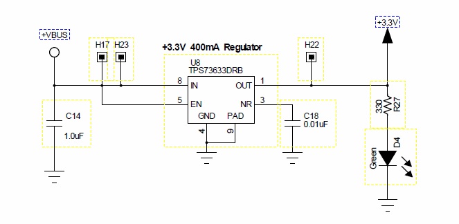

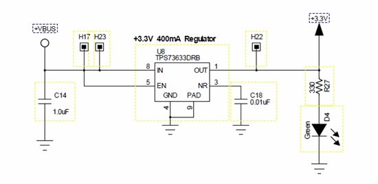

Hope this is the right place to ask this. I'm wondering what the easiest way is to bypass the linear regulator on VBUS. I want to supply a more efficient 3.3V to the Launchpad through my own booster pack. From the attached picture it looks like I can just cut the tracks leading to the 3.3V rail and supply 3.3V to J1.01. Is this understanding correct? Also what is H22 in this diagram?
  • Hello James,
    You can remove the Short between H24 and H25, just below the U8 regulator and then use H24 to power the TM4C123 (U1)
    Amit
  • Perhaps some added attention to the abandoned U8 Reg. may prove helpful.  Don't know nor use that device - but it may suffer upon "power-up" if it's, "completely unloaded" (to include any output C).  We've noted oscillation from certain, linear Regs (upon start-up) - when their outputs simply float.
    Breaking the input connection to +VBus should solve.
    Your "more efficient" (i.e. assumed switcher) supply must insure good, solid (we prefer multiple) ground path connections to your MCU board for best results...
