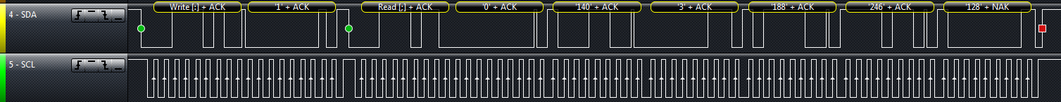

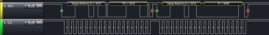

  • Hi amit, I did what you suggested, results returning is 0x00, which means it is not really reading anything. I was reading that I need to setup the slave device before i can read it. am i missing something important from my code?
    This is what i got from my logic analyser. from what i see, i'm sending to the correct device address and commands, but just not receiving what i am expecting.
  • Hello Hong,
    After selecting the Address a Repeated Start Needs to be done, while the scope plot shows that a Stop and Start are being done. Hopefully this should help
    Also the Device Register Address must be 0x0D and not 0x0E that was in the original code.
        I2CMasterSlaveAddrSet(I2C1_BASE, SLAVE_ADDRESS, false);
        I2CMasterDataPut(I2C1_BASE, 0x0D);
        // Initiate send of data from the master.
        I2CMasterControl(I2C1_BASE, I2C_MASTER_CMD_BURST_SEND_START);
        // Wait until master module is done transferring.
        while(I2CMasterBusy(I2C1_BASE))
        // Modifiy the data direction to true, so that seeing the address will
        // indicate that the I2C Master is initiating a read from the slave.
        I2CMasterSlaveAddrSet(I2C1_BASE, SLAVE_ADDRESS, true);

  • Hi amit, i've done what you suggested and everything seems to work fine now. however, now i'm having issues with reading multiple bytes from a hygrometer, HTU21D. the message is 12-14 bits long with 2 status bits, hence i should be reading 2 bytes, however, i seems to only receive the first byte.
    from what i see, the slave device transmitted 2 bytes of msg, but i only seem to read the first byte.
    http://www.meas-spec.com/downloads/HTU21D.pdf
    // Do a dummy receive to make sure you don't get junk on the first receive.
    I2CMasterControl(I2C1_BASE, I2C_MASTER_CMD_SINGLE_RECEIVE);
    // Tell the master to read data.
    I2CMasterControl(I2C1_BASE,I2C_MASTER_CMD_BURST_RECEIVE_START);
    while(I2CMasterBusy(I2C1_BASE));
    for(ui32Index=0; ui32Index<3; ui32Index++) {
        I2CMasterControl(I2C1_BASE,I2C_MASTER_CMD_BURST_RECEIVE_CONT); //possible error here?
        while(!I2CMasterBusy(I2C1_BASE));
        pui32DataRx[ui32Index] = I2CMasterDataGet(I2C1_BASE);
    I2CMasterControl(I2C1_BASE,I2C_MASTER_CMD_BURST_RECEIVE_FINISH);
    pui32DataRx[0] = I2CMasterDataGet(I2C1_BASE);
    I BELIEVE YOU WILL NEED TO RECEIVE DATA HERE^^ AS YOU HAVE JUST SENT THE RECEIVE COMMAND. SO THE  YOU AREN'T READING THE DATA AT THE RIGHT TIME AND THAT'S WHY I THINK YOU ARE ONLY READING ONE OF THE BYTES.
    THERE IS NO NEED FOR THE LOOP AS YOU ARE ONLY READING TWO BYTES??
    pui32DataRx[1] = I2CMasterDataGet(I2C1_BASE);
     YOU WILL NEED TO READ DATA AGAIN HERE^^ EDIT: AS AFTER YOU READ THE SECOND BYTE YOU NEED TO SEND THE STOP CONDITION WHICH IS DONE USING I2C_MASTER_CMD_BURST_RECEIVE_FINISH

    Now that that is solved, I'm getting another issue. I'm attempting to read from xyz from a mma8452q accelerometer, http://www.freescale.com/files/sensors/doc/data_sheet/MMA8452Q.pdf. I'm able to read the WHO_AM_I register, and I've also set it up to read the xyz with auto increment to next register. However, I seem to be reading the same output no matter how I tilt the accelerometer. Below is the code, waveform and results.
    Output: 00'8c'03'bc'f6'80'
    		I2CMasterSlaveAddrSet(I2C1_BASE, ACCE_SLAVE_ADDRESS, false);
    		// Place the data to be sent in the data register
    		I2CMasterDataPut(I2C1_BASE, 0x01);
    		I2CMasterSlaveAddrSet(I2C1_BASE, ACCE_SLAVE_ADDRESS, true);
    		I2CMasterControl(I2C1_BASE, I2C_MASTER_CMD_BURST_RECEIVE_START);
    		acce_pui8DataRx[0] = I2CMasterDataGet(I2C1_BASE);
    		for(ui32Index=0; ui32Index<(ACCE_NUM_I2C_DATA-2); ui32Index++) {
    			acce_pui8DataRx[ui32Index + 1] = I2CMasterDataGet(I2C1_BASE);
    		acce_pui8DataRx[5] = I2CMasterDataGet(I2C1_BASE);
  • nvm, i got it working now. i didn't put the device to active mode.
